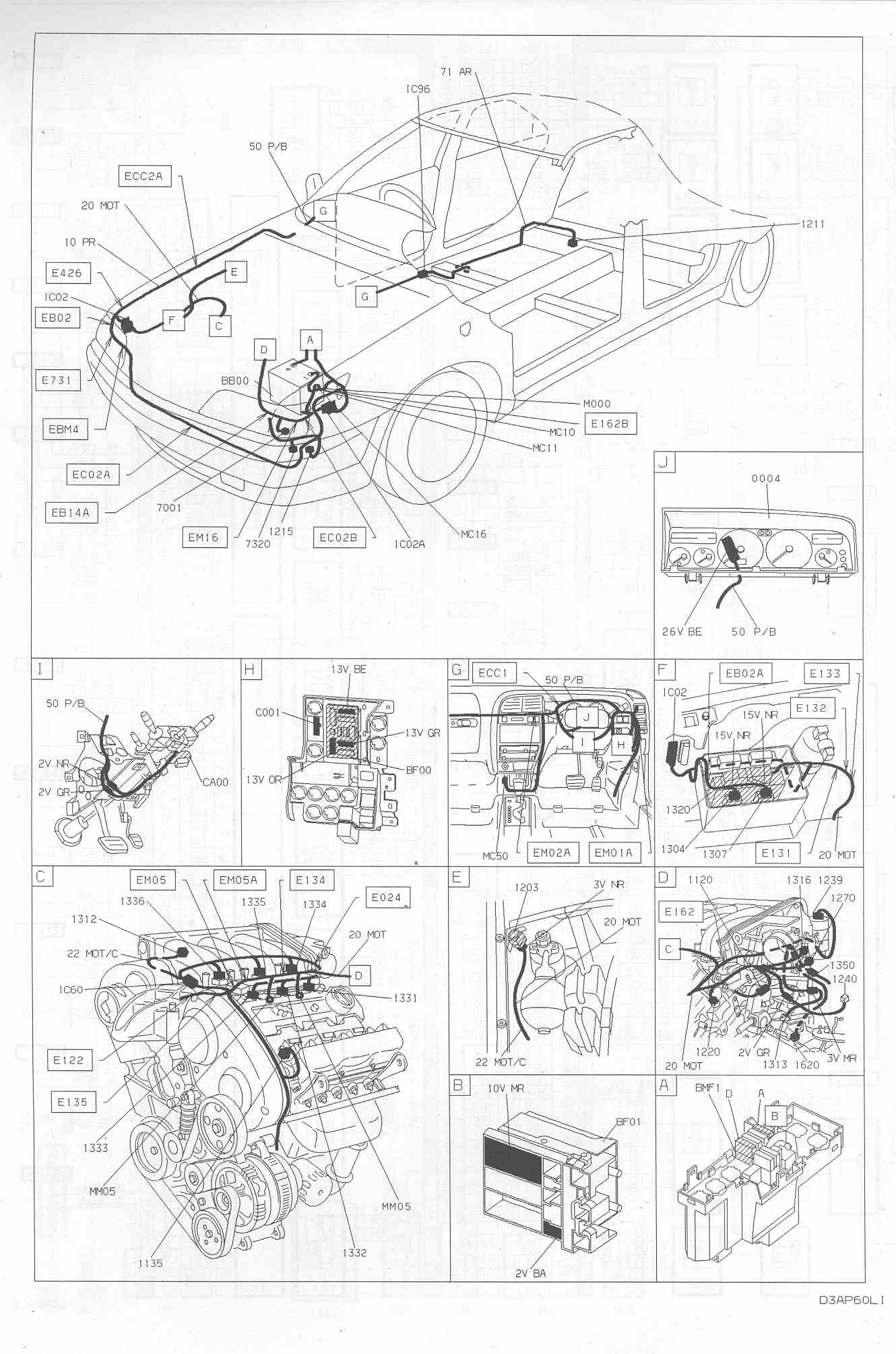

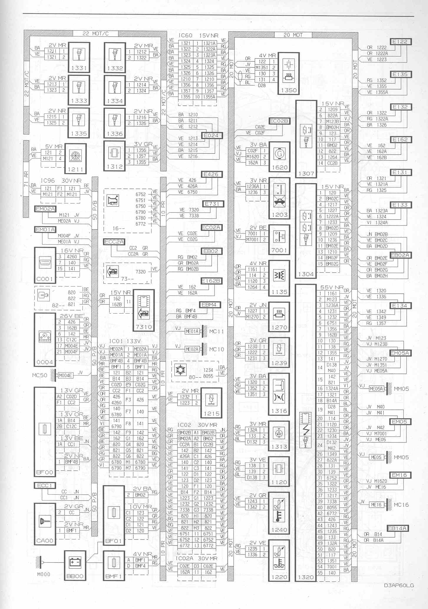

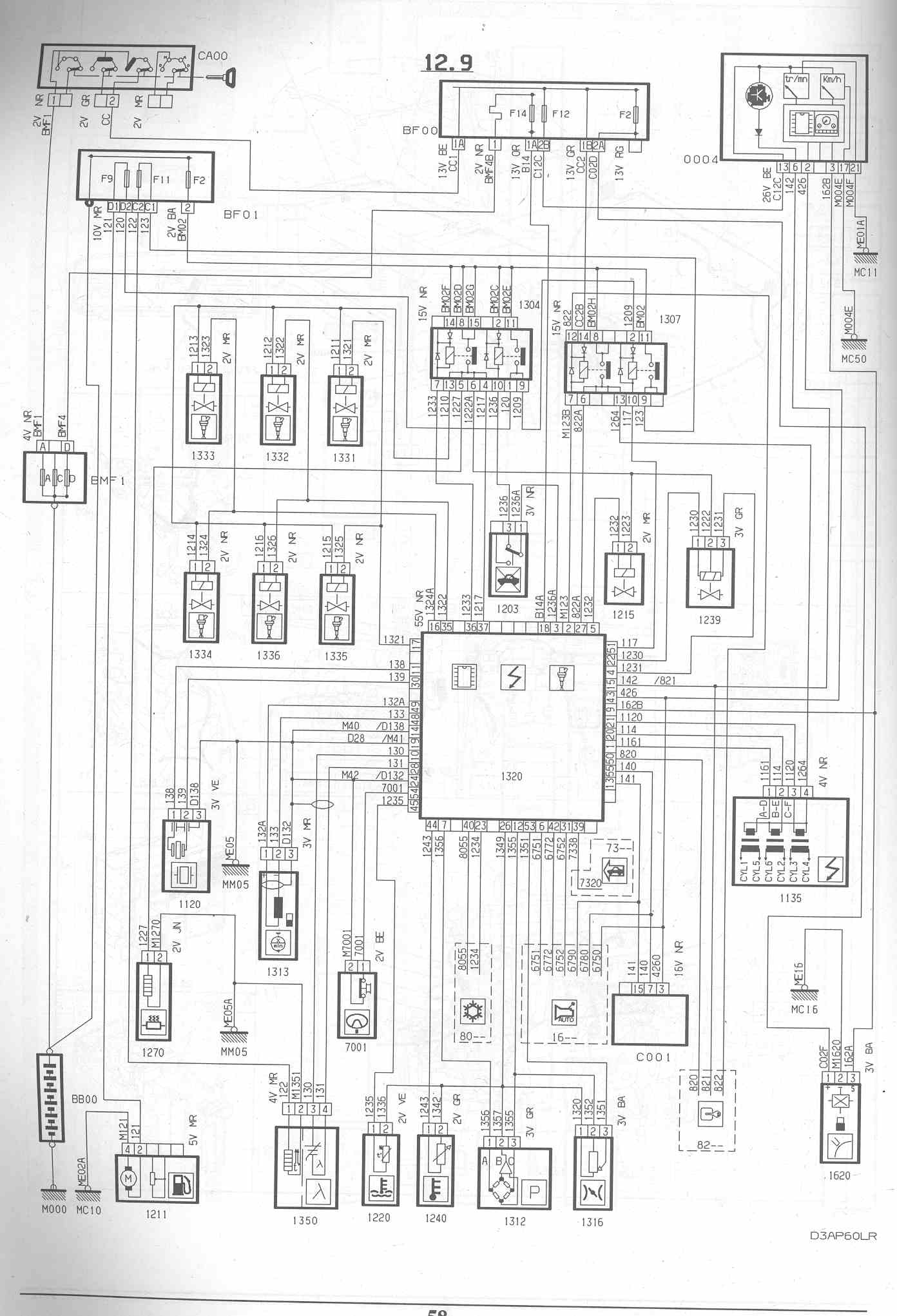

With the back seat lifted and the rubber cover removed, you should hear the fuel pump rum for about 2 seconds when the ignition is switched on. If you dont hear it, check for voltage on the wires to the pump. If there is no voltage at the pump, go back to the "double relay" 1304 in the ECU box and check there for voltages.
Here is the wiring diagram of the fuel injection, the fuel pump is at the bottom left of the diagram.
If the pump seems to be working, then you need to work out if you have spark.

Hi,
Got down to the car today and checked the following:
Ignition switched on:
Cannot hear fuel pump running
Fuel pump pin 2 0.29V
Under bonnet fuses 9 - 0V
Relay 1304
Pin 2 - 0V
Pin 6 - 0V
Pin 7 - 0V
Pin 8 - 12.2V
Pin 9 - 0V
Pin 10 - 0V
Pin 11 - 12.2V
Pin 12 - 12.2V
Pin 13 - 6.2V
Pin 14 - 12.2V
Relay 1307
Pin - OV
Pin 2 - 12.2V
Pin 4 - 0V
Pin 6 - 0V
Pin 7 - 0V
Pin 8 - 12.2V
Pin 9 - 0V
Pin 10 - 0V
Pin 11 - 12.2V
Pin 13 - 4.6V
Pin 14 - 10V
Pin 15 - 10V
So looks like voltage into both relays but not out the other side?
I tried swapping the relays as the look like the same one but no difference
Replace relays ?
next steps would be greatly appreciated.
Thanks
Owen

Your results are indicating a faulty relay 1304, as you have 12V across the coil (pins 2 and 10) which should energise the relay coil. You have voltage on pin 11 but not pins 1 or 9. Those relays are usually pretty reliable.
Here are the harness diagrams that go with the wiring diagram I posted earlier. Note that the 10PR harness (which runs under the radiator) is well known for having wires fail from internal corrosion.
