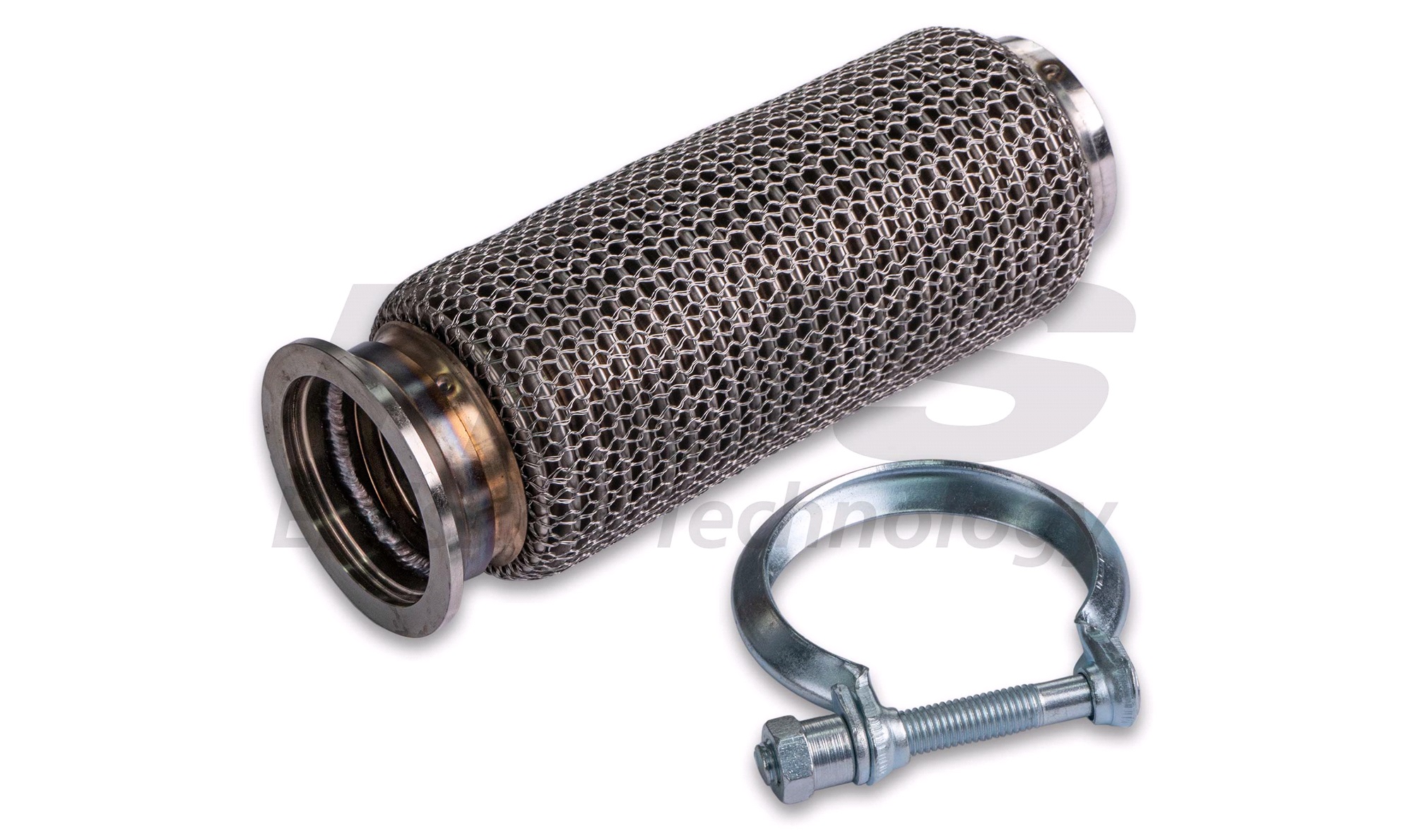

Please help me with the part number for the flexible tube in front of the DPF on my C4 Cactus 1.6 BlueHDI.
Should look something like this:

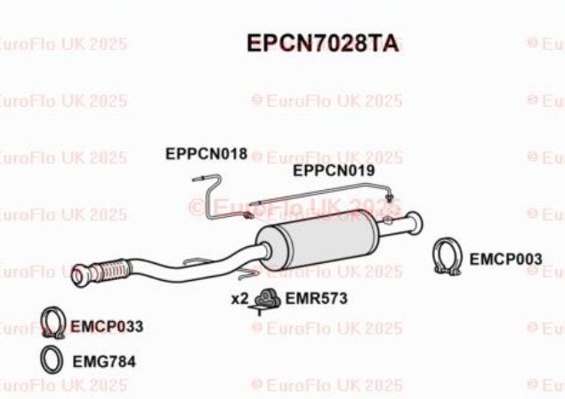

If people can’t find the oem part number for you, have you tried an aftermarket exhaust manufacturer catalogue (and can then cross reference elsewhere if needed)?
Eg
http://www.euroflo-uk.com/Catalogue.aspx

No, I hadn't tried that. Thanks for pointing me in that direction. It seems, though, that the flexible tube I'm looking for is part of the DPF. Strange, since my local mechanic has it available from his supplier - just that they can't deliver it for the time being....

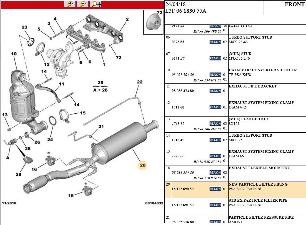

The drawing you posted doesn't show the flexy as a separate item at all. Is there another drawing available?

Nope, all I could find. Hence me asking for a part number and a reply from an admin 😊

Not listed as a separate part from the dealer, It's part of the DPF I'm afraid

Thanks wheeler. So it seems. I found a replacement flex pipe that can be welded to the DPF which I will fit instead. It's a repair kit for this exact vehicle.
