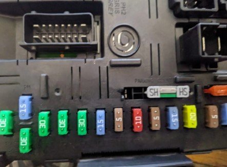

First thing to check is that the shunt fuse is in the correct position, It should be located in the CLIENT position.

Sorry for late reply I will check this but I have had it on diagnostics & that would show I imagine frustratingly after literally removing the glovebox out 3 times to get to the fuse box last time today I see this post lol, so far I've checked the boot sensor (working) replaced he siren as it had a depleted battery in it but now I'm getting two faults for front door sensors I'll have to do the fuse box again to look at the shunt fuse but tbh I'm doubtful
