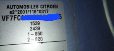

how do you get the rpo number for diagbox ? By the way citroen c3 1.4 hdi

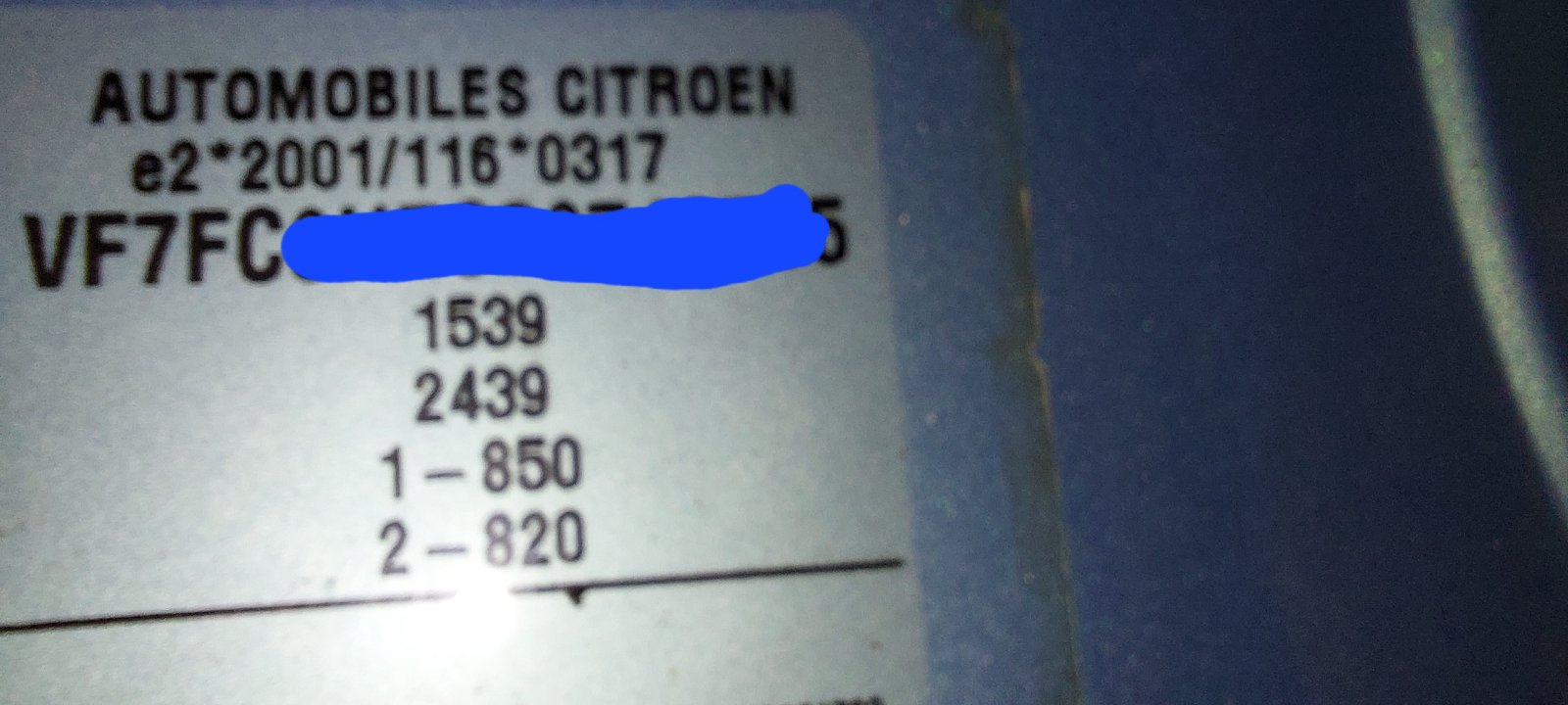

I don't believe that's the right sticker to find your RPO number.
It should be at least 5 digits long.
The four numbers below the VIN on that all look like vehicle weights to me.
- Gross vehicle weight
- Gross train weight
- Max axle load (Front)
- Max axle load (Rear)

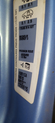

Look at the label with the tyre pressures on. It should be the number at the top. It might also have been written in the service record booklet on the inside front page.

Open all the doors and look for the tyre pressure sticker, if it is still on the car it will be on one of the pillars, usually a front one or a middle one.
The vin can be used for the car build data which gives the rpo but I think at the moment the forum does not have access to Citroen's procedures/data due to changes being made, however, you should be able to get it from a Citroen dealer.
You have not given the year of your car but if you know its registration date you can use a rpo calculator to work back to get the rpo but knowing it will have been made before then.

Thanks pushed the car out of the garage and found the label on the inside door by the wheel arch thanks for the help I still could not get the diagbox to talk to the car even with the rpo number

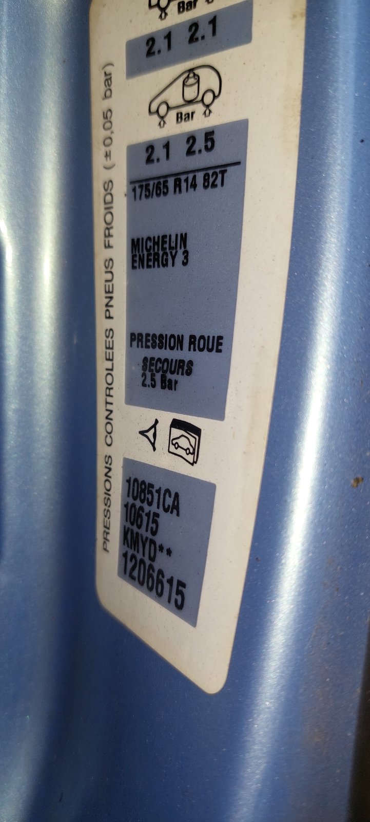

On your tyre pressure sticker the rpo number looks to be 10851 which works out as a production date of 25 July 2006. http://www.citroen-ds-id.com/gen/Gen_Organr.html Does this tie up with the registration date since so far I have not seen anything in your posts ?
The paint colour is KMYD which is the blue colour.
