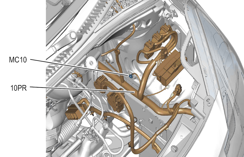

However you say you checked the fuses - which ones? Each Headlamp (certainly on a 2012 Petrol) has a separate fuse F17 for Left Dipped Beam and F15 for the right Dipped Beam Lamp - both located in the engine Fusebox.
So without a fault code or other info, if these both check out, (and it would be odd for both fuses to play up - they usually are blown or not).
So check the earth MC10 shown here:

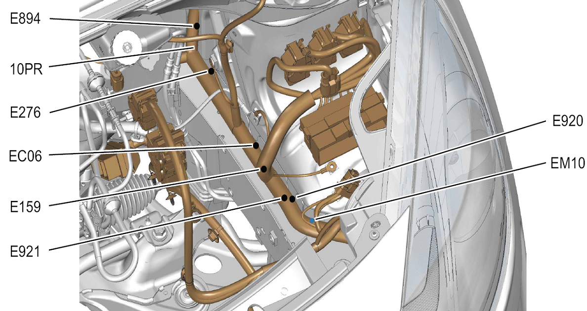

and also the earth crimp point EM10 which is the only earth shared between the 2 headlamps - so that could affect both:
Failing that, and the usual wiring checks, it will likely need a proper diagnostic, so no good replacing parts as this can be expensive, as the steering wheel control module (Comms unit) must be the exact part to match the vehicle equipment and if you have ESP will need the steering wheel angle sensor calibrated once removed. Again, the engine fusebox may have a dodgy relay, but these are internal and are not user serviceable, so get a diagnostic first.
So really needs to see if there are any codes we can look at first.
