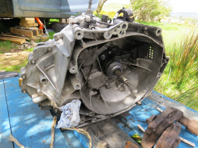

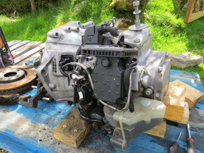

It has come time to replace the clutch assembly in my C4 Picasso (230,000 km). The winter wasn't kind to her, the clutch starting really wearing after having it stuck in a farm field and rocking the car back and forth between reverse and forward gear to break free - since then it had been grinding whenever building inertia, like stopping at roundabouts and hill starts. A few weeks ago we had part of our road wash out along a hilly section and the car has been struggling to climb ever since. Now the clutch appears to be slipping (strange rubbing/whirring noise from gearbox area) and cutting out. There is likely enough life left on the plate to get it to a shop but not back up the hill, which is about a 200 meter climb from the main road. I've been calling around and no shop within 50 km wants to do the work saying it is "more trouble than it's worth" which I can believe after researching about these vehicles and their piloted manual gearboxes.
Now I am capable and willing to take this job on myself, and since it's my only car I don't really have much choice in the matter if no one else will. I have most of the tools already apart from the diagnostics software to depressurise/re-pressurise, program the gear grid, etc, etc. I was hoping some guidance from the community might prove to be valuable.
Primary questions: What all do I need for EasyDiagnostics? Do I need the tool, the Diagbox software and the PSA license (which I priced at around 300 euros!) does this tool and software work with tablets or laptops? Windows 10? Linux? I've never need to use a computer so much to work on a car before owning a Citroen. LOL! And most importantly can I carry out the servicing and reprogramming using Diagbox? I have seen more reference to Lexia for carrying out this procedure.
Secondary line of questioning: What all should I replace while I am performing this job? I want to replace the DMF, clutch components, and the drop out cylinder. I seen mention of a "electronic clutch cylinder ECP" is this another part that I should have ready to install? I also plan to replace the fluid in the gearbox to maybe make it easier to remove, would this be a good idea or is it risky business if there aren't any complaints coming from the gears? And if so should I opt for a higher grade gear oil? (performance 75w-80 for larger gearboxes) due to the age of the gearbox.
I would not be considering doing this job if I didn't find such a supportive community. These cars are genuinely interesting for their quirkiness and stubbornness, and if I can keep this one running I think there is reward in that alone.

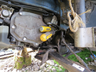

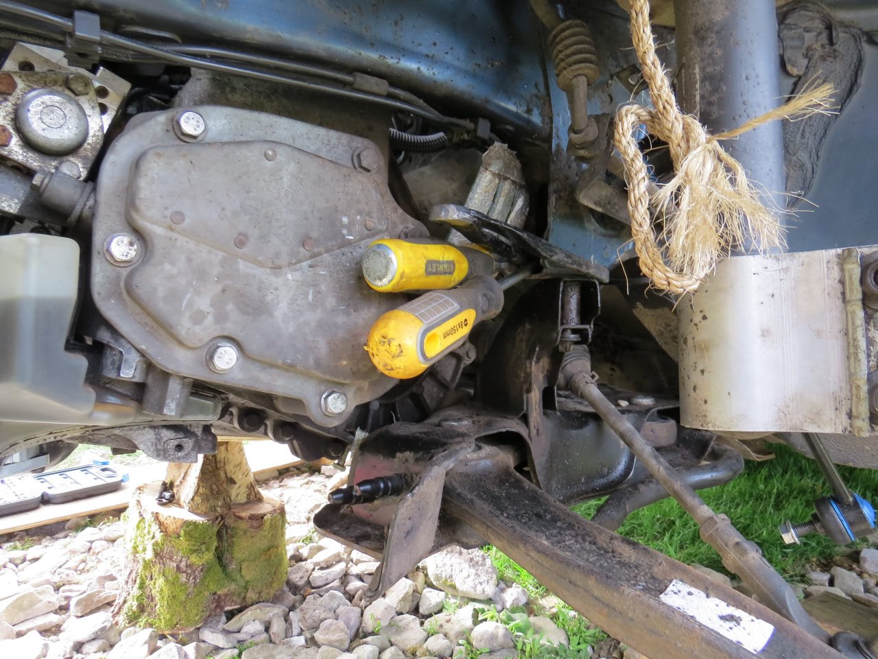

I think I was able to answer most of my questions from above. This job has turned into a bit of nightmare. Nearly a month in, stranded up the country trying to simply remove the gearbox.
**SEIZED SUBFRAME BOLT**
Right now we are stuck trying to remove one of the subframe bolts. I have learned about these notorious captive bolts that are held with dainty pieces of sheet metal.
I am at the point where I can see enough of the bolt threads between the subframe and the chasis that I am tempted to cut it out. But what will I be able to do in order to refit the subframe?
Any advice before I get out the grinder?

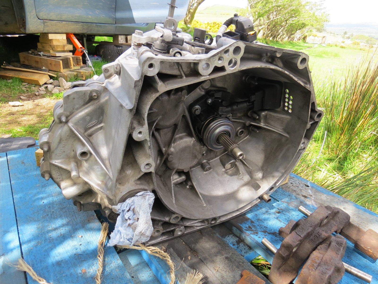

I have managed to get the sub-frame out but cutting the bolts and replacing with matching hardware. The gearbox has been removed, cleaned, new clutch kit installed and everything buttoned back together. I ran DiagBox and re-pressurised a bled the system.
Now more issues maybe someone out there can offer a little bit of advice.

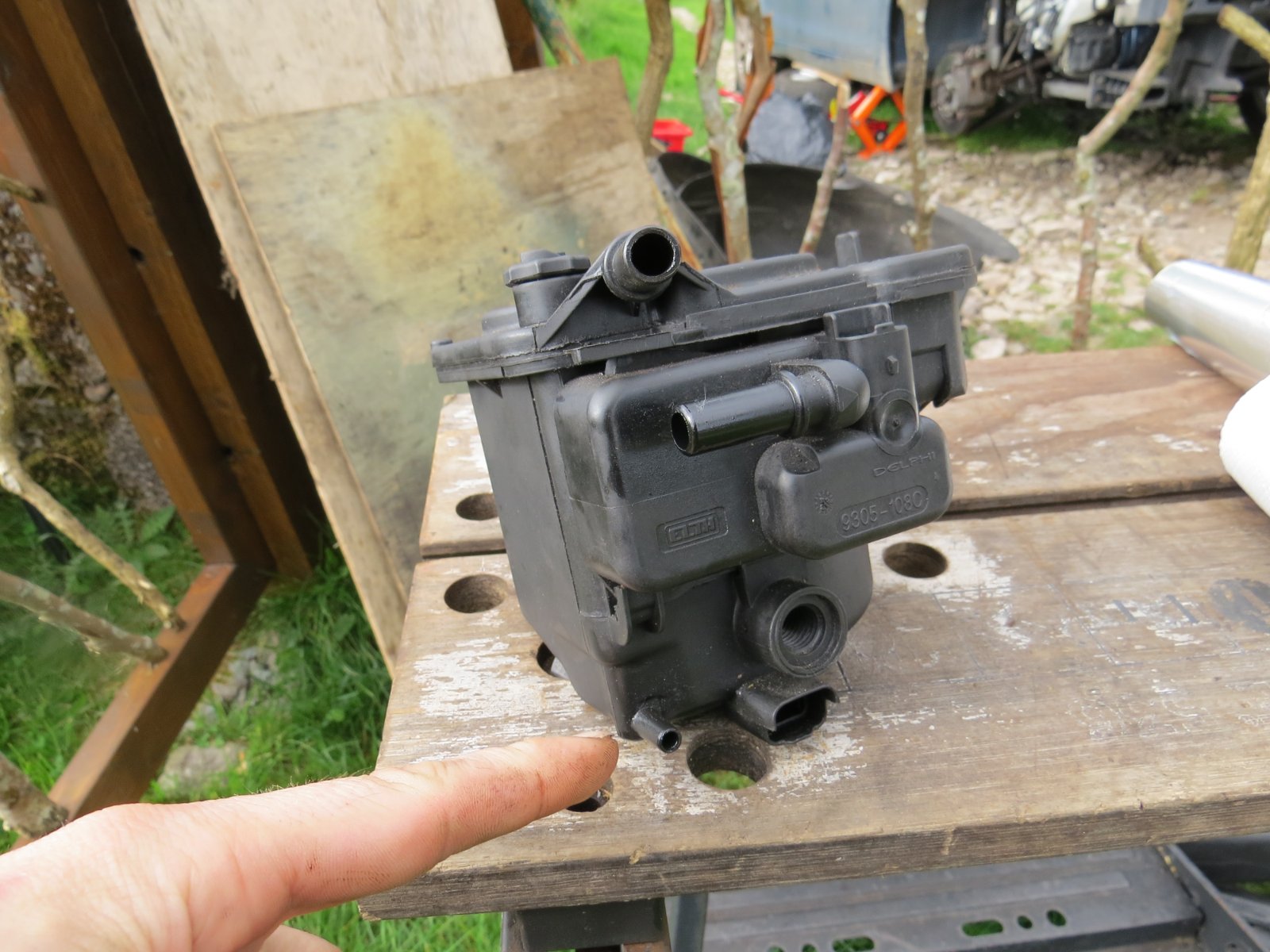

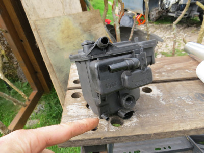

While I am waiting for the battery to charge I started pulling the engine bay apart again to check sensors, physically the crank sensor seems fine. I was on my way to the fuel rail sensor when I had to remove the fuel filter, the filter was quite light and as I was removing it fuel was spilling out of a small nozzle at the box of my filter - all over my freshly rebuilt gearbox. :-/
*I figured this out, I had opened the bleed valve not knowing it connected to this*
When I got to squeeze the primer bulb with the filter removed I get no fuel from either of the lines, just a gurgling sound. Does this seem abnormal? Or does it need to be sealed up with the filter installed the 'suck' the diesel from the tank? I spent several minutes pumping the primer bulb to no avail.
I'm thinking maybe a fuelling issue, it has been sitting on blocks with the filter removed (and sitting indoors) for a month and half.

That nozzle is likely the filter drain used to drain any water at services. On the top of the filter above this nozzle there will be a bit where possibly an allen key can be used to slacken the drain plug and tighten it - see if this is loose or it might be tight but the drain plug might be leaking. If it was leaking when trying to start then likely the fuel lines will have drained back to the tank preventing starting.

How much effort should normally be expended with the primer bulb? I've squeezed it for yonks and still no fuel coming out of the line. I haven't been able to detect any where the diesel is leaking.
- Posts: 28726
- x 5672
Re: C4 Grand Picasso EGS: Clutch replacement
Could be that the one way valve in the primer bulb has failed.

I primed it again for quite a spell, until it got kind of tight but I could still squeeze it. With the freshly charged battery I was able to get it to turn over, it sputtered a bit, then started running fine for a few seconds and then it quit on me, I checked the primer bulb it was still the same state. I hooked up my roadside scanner and on the FRP (fuel rail pressure, I think) I was getting 420-650 kPa range reading with the ignition in the on position, and then on cranking and turnover it spiked to about 12000 and then to 31000 right before it cut out. I'm actually not even sure what value I'm looking for here, I used to monitor it during long drives but I couldn't be arse to write it down at the time.
Should there be any amount of pressure on the FRP when the ignition is switched to on?
