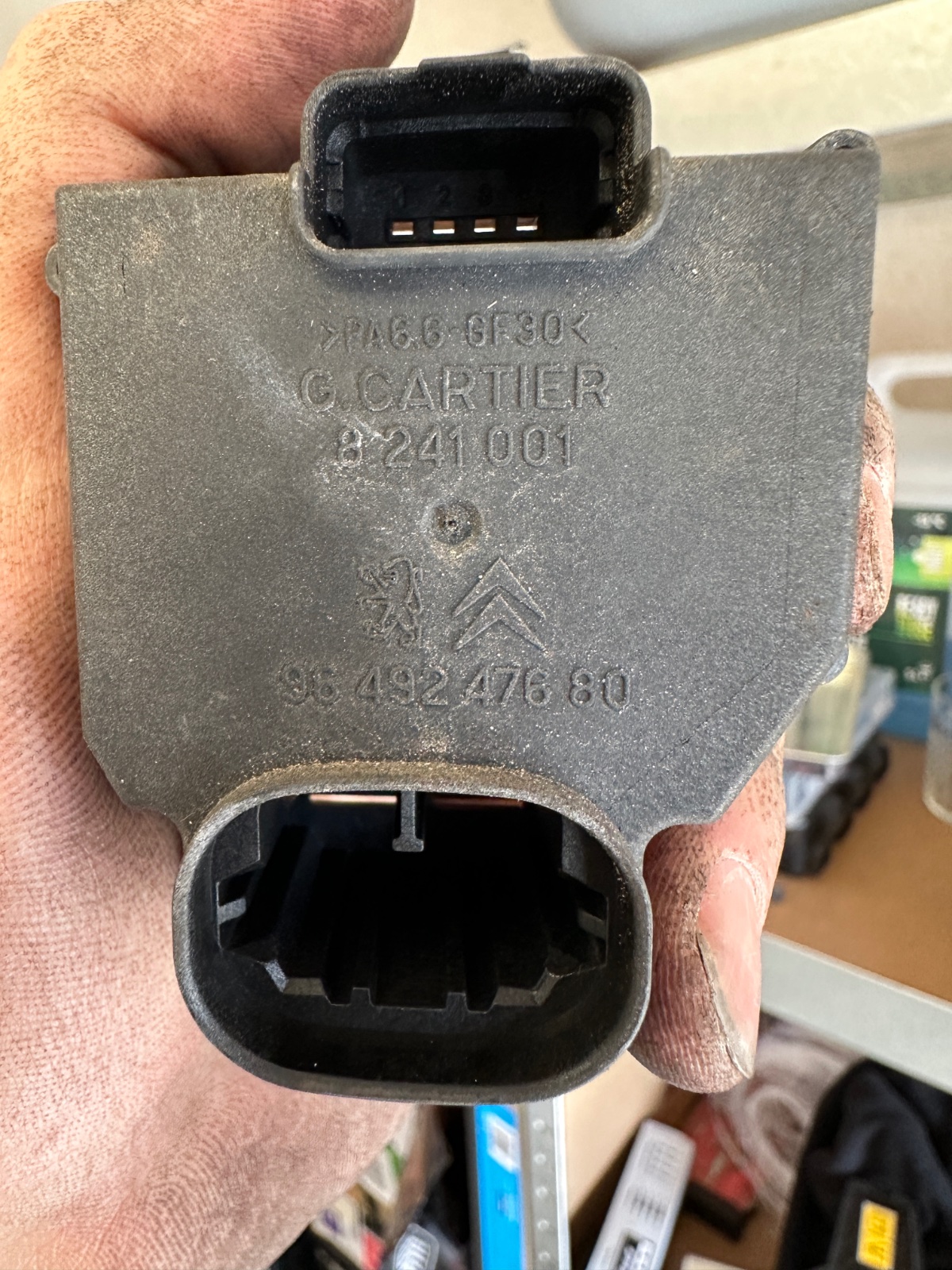

As for battery drainage - both RD4 (currently removed from car) and blower resistor were the root cause. But now I have another issue. 😑
I've bought the control resistor according to my part number 9649247680
Ordered unit was from meat & doria (they sent me the chinese krios one) and the blower is completely silent.
It's not kicking in even over 105C degrees😑
So.. I placed the original one back to at least have it partially operational, better running with errors than not running at all.
Is there any recommended replacement to the Cartier one? Like I don't know, Vemo maybe?
