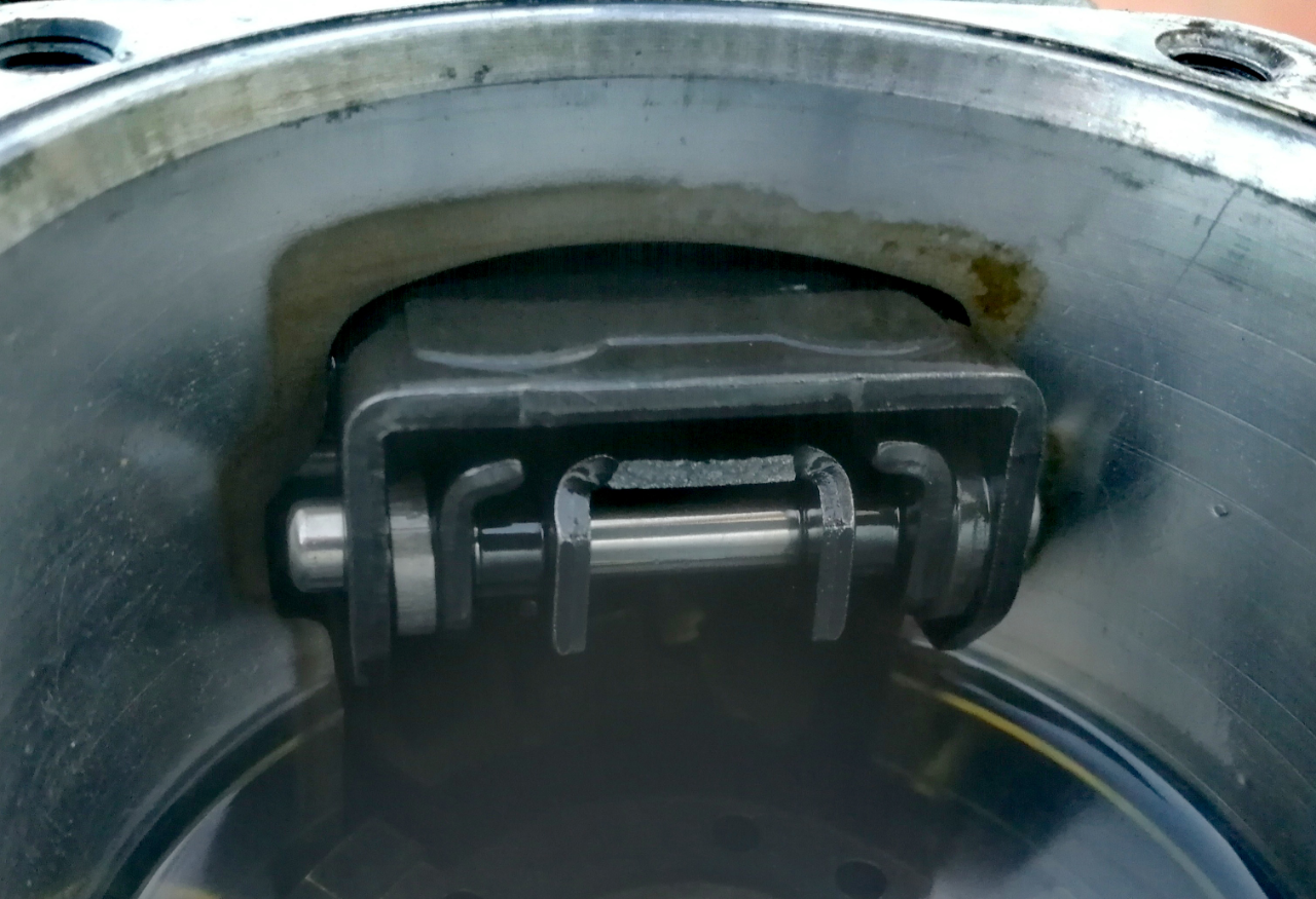

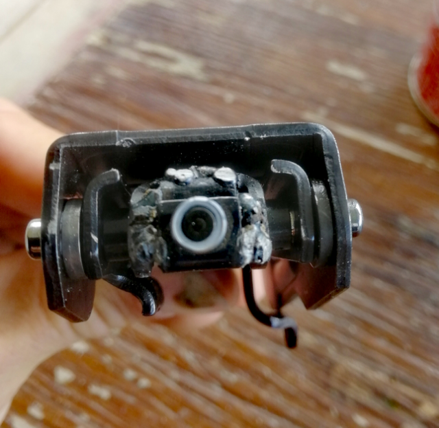

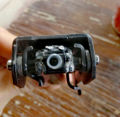

while fitting the hydraulic head of my Peugeot 205 Bosch VE pump I broke the fulcrum lever.

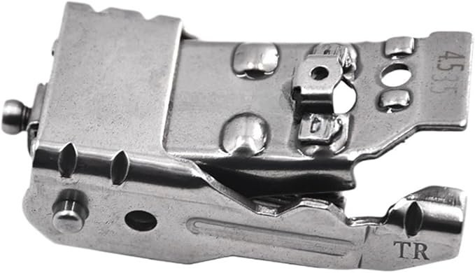

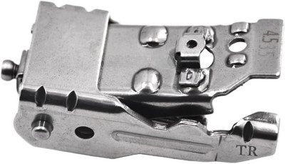

The only spare ones I could find online available are of a different design and not sure if they would work. The black one with the hook is the one in my pump.
Does anyone have a spare one or know if this can be welded back on or if fitting a different one is possible?
As this is our only vehicle, fixing this is asap is very important to us, thanks for any help!

Thanks for the reply. Unfortunately they didn't have in stock the one I broke.

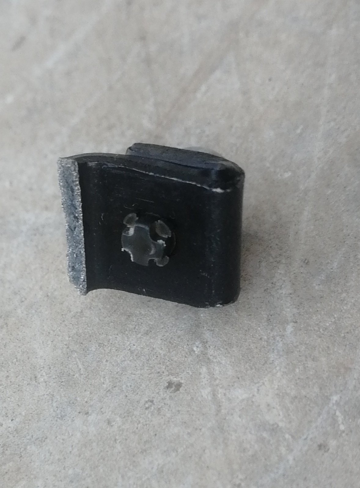

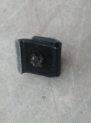

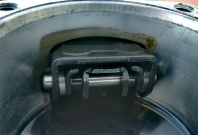

I had it welded, a German welder did a great job (German pump needs a German welder I reckoned), today finished assembling the pump, bled the air from injectors and it started beautifully?Did a test run round the village and it goes fine.
