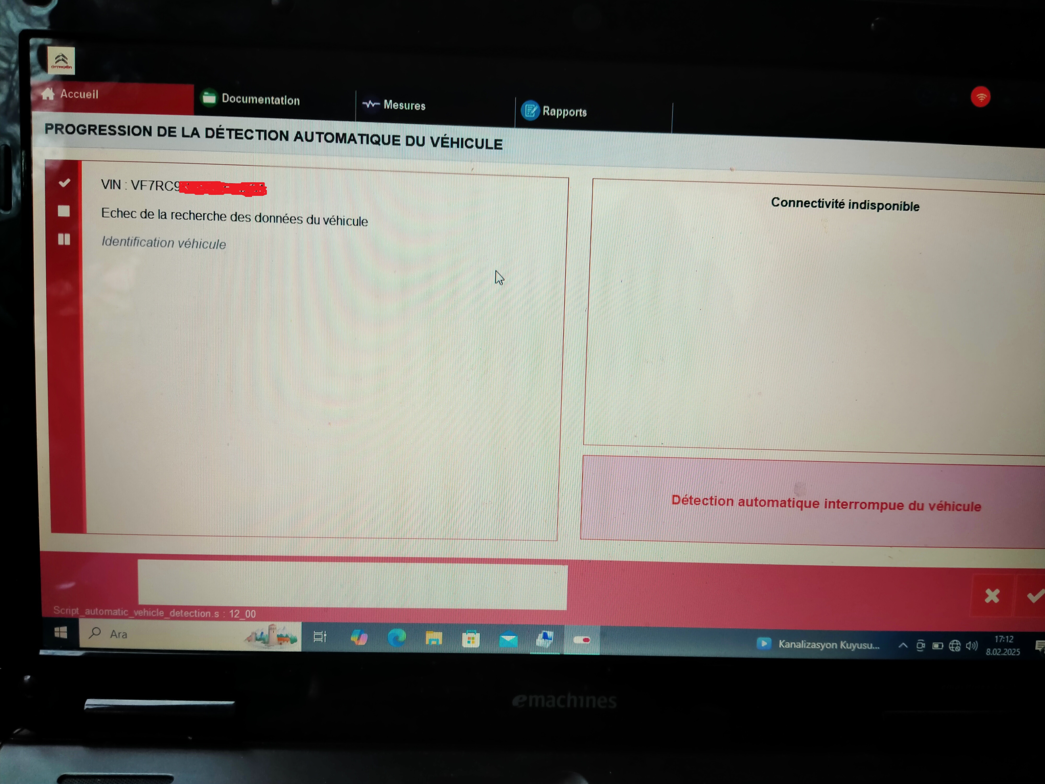

Hello everyone, regards friends, I am having a connection problem with my Lexia device, the computer sees the device, it sees it in the Diagbox program, when I try to connect, it reads and recognizes the VIN number but it does not connect, it gives a warning as seen in the picture.

Kees wrote: 26 Feb 2025, 18:24 If you have an illegal version (AliExpress), don't try to login, put the internet connection off.
Yes, I bought it from aliexpress. But when I try to connect, I don't have an internet connection, but it still doesn't connect, it reads the VIN code but doesn't proceed any further and gives the warning seen in the picture.

By the way, when reading the VIN number, the relay sound is heard, after reading the VIN number, it does not proceed any further.

You can also try to put the vin number manual instead of scanning

I even tried connecting by selecting the VIN number and vehicle model but unfortunately it doesn't work, I don't think the problem is due to the way I connect.

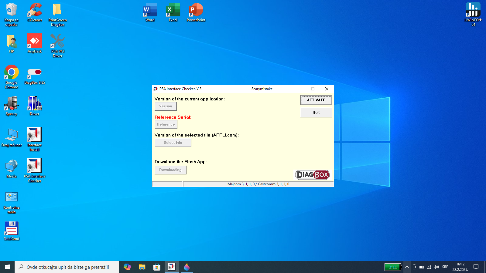

Have you tried to start the interface checker? It is essential that the rest can work.

When I connect my Lexia device with psa interface checker v3, it does not see any problems and even updates it. Currently, Lexia version is 4.3.7
