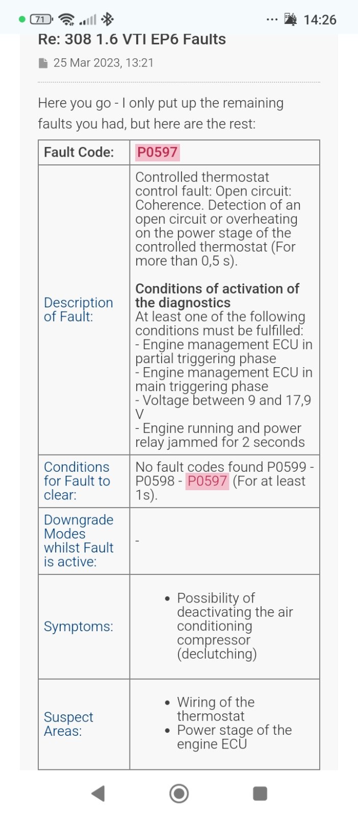

Hi,
Citroen Picasso C4 (B78) VIN VF7**************[VIN obfuscated, can be read by forum staff] - Had this code pop up (no others pop up with it)- ran a search in the forum for the manufacturer's protocol for this one and found the one in the pic - is it the same for my car ?
if so, what does POWE STAGE OF THE ENGINE ECU mean ?
thx

Re: P0597 FAULT CODE
Have a look at my post here:
viewtopic.php?p=654946#p654946
There is a heating element inside, so in this case either the wiring / connection is faulty or it may be the element inside the thermostat (contained in the water outlet thank) that's faulty.
Unread post by 508c5 »
GiveMeABreak wrote: 23 Feb 2025, 13:18 Have a look at my post here:
Thanks, very detailed and educating
So (i guess) replacing the thermostat is the more probable fix ?
x 6954
If the harness / connections have been checked, then yes, most likely the case.
