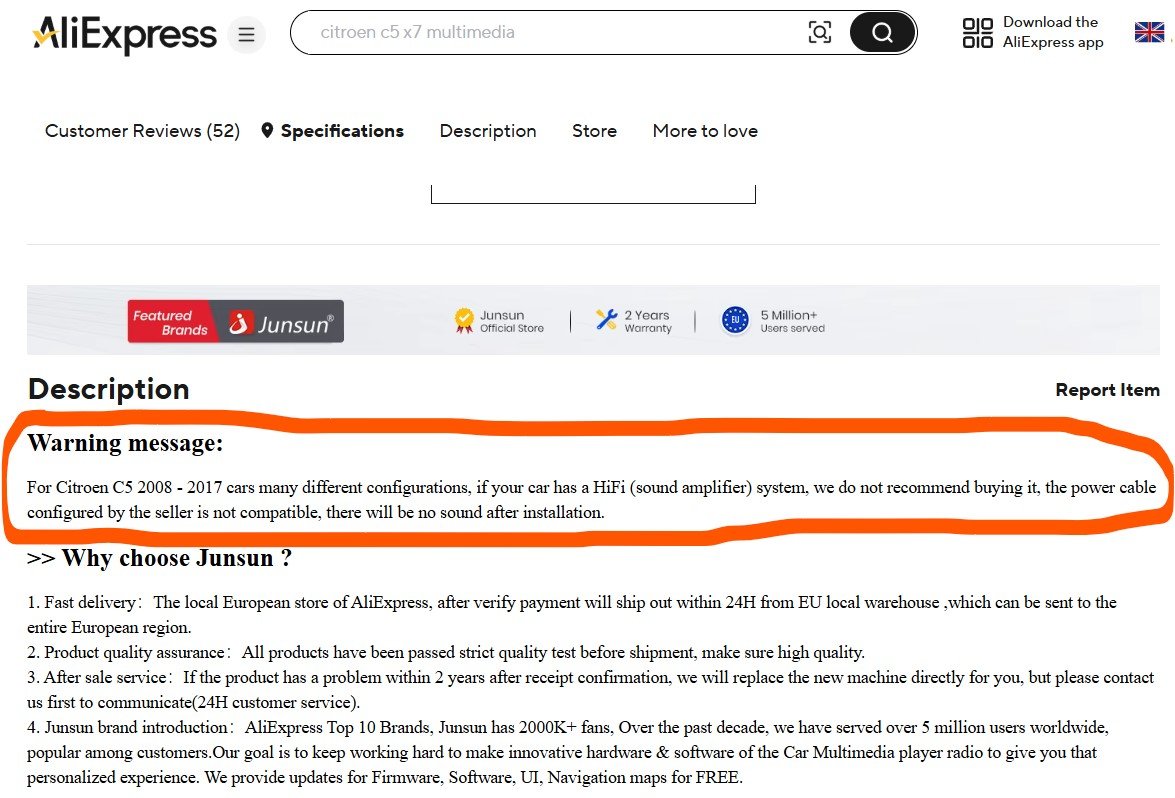

Here is the link:
Junsun V1 Plus Car Radio For Citroen C5 2008 - 2017 wireless CarPlay Android Auto car intelligent systems No 2 din 2din DVD
https://a.aliexpress.com/_Ewk5cay
Bought the V1 Pro 6gb - 128gb
Does it help?
wheeler

Was this not on the listing when you bought it??

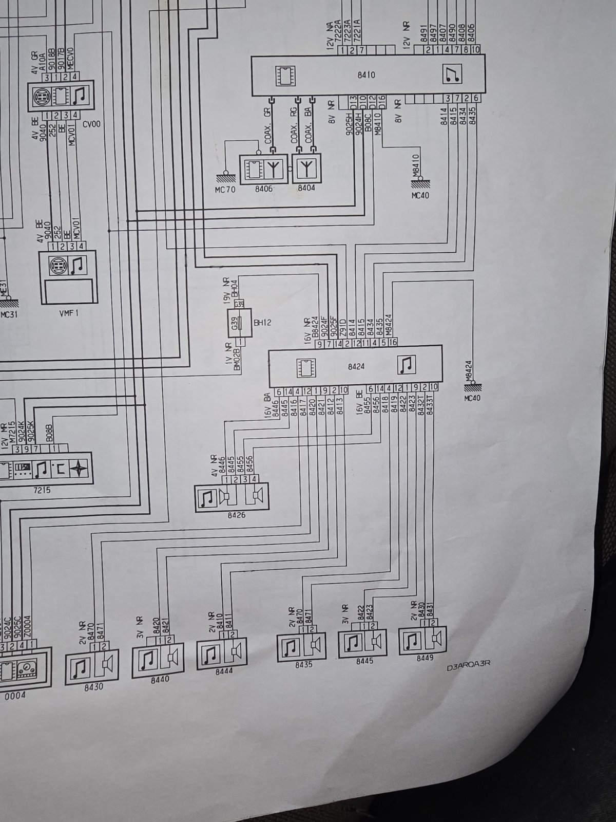

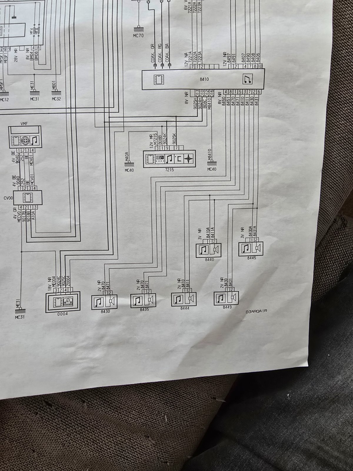

Here you can see the reason.
With an amplifier there are only 4 wires come from the radio and being multiplex by the amplifier.
When you have only a radio then there are 8 wires for 4 speakers.
Greeting,
Kees.

wheeler wrote: 23 Feb 2025, 10:02 Was this not on the listing when you bought it??
yeah I also noticed that but these idiots didn't specify this when I bought the unit, they only added this recently... 🤬
now it explains why I have the problem..
what can I do now?

So if that diagram is correct you could disconnect & bypass the amp by linking the speaker wires direct. That's pretty much all the adapter harnesses you get do, they just bypass the amp.

Kees wrote: 23 Feb 2025, 12:32 Image
Greeting,
Kees.
I think I understand the explanation (kind of) but sadly the schematics don't make any sense to me 😕
