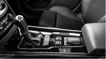

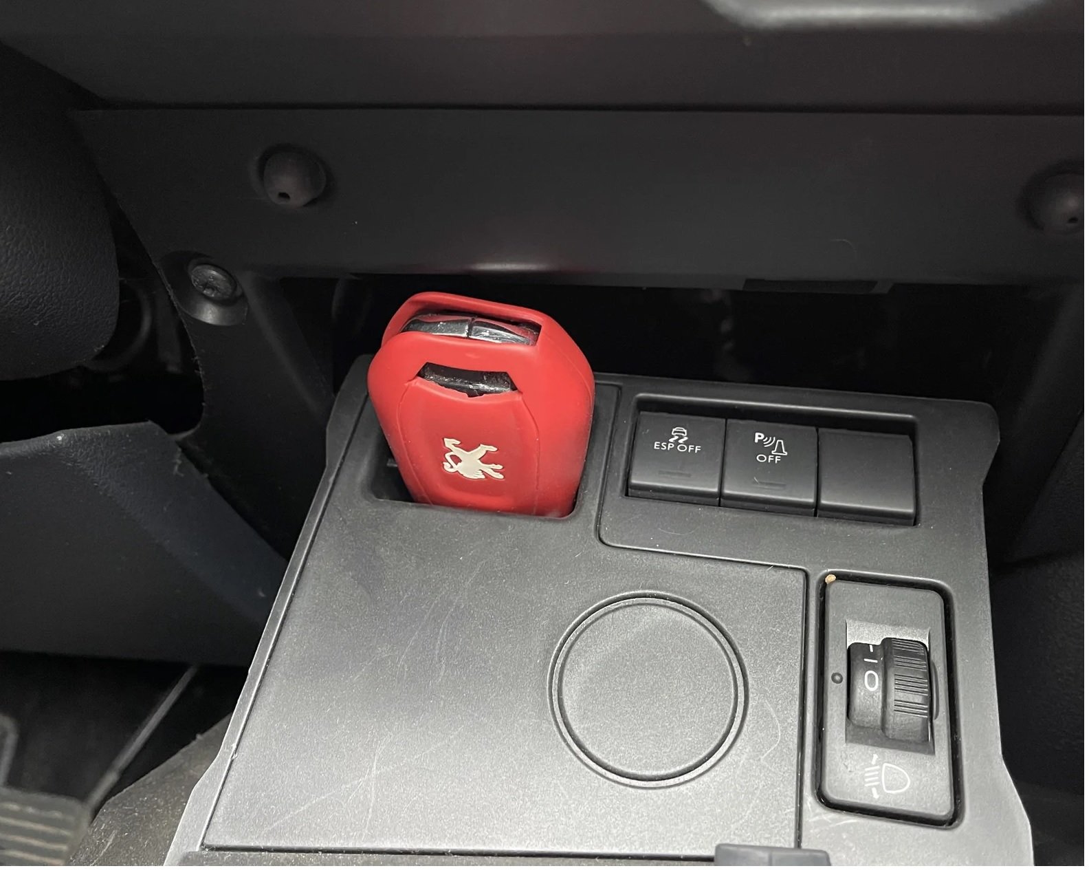

Maybe the diagbox version is too old to do the job.Which version you used? I'm sure that when you change the gear box oil it must be warm (i don't remember exactly temp) but i think to reset it also around 50 C°.It was needed because to do the adaption of electrovalves must be in working temp. In any case use another diagbox version. Yes i had the same fault in Diagbox, stuck on the "Loading in progress" for ages. Scratched my head what i was doing wrong until i used another diagbox ver.
This is the central key reader.

And this is like the key reader service position. I suppose that this is not the case because otherwise maybe you hadn't any communication with diagbox or whatever.
