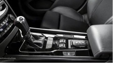

This is the central key reader.

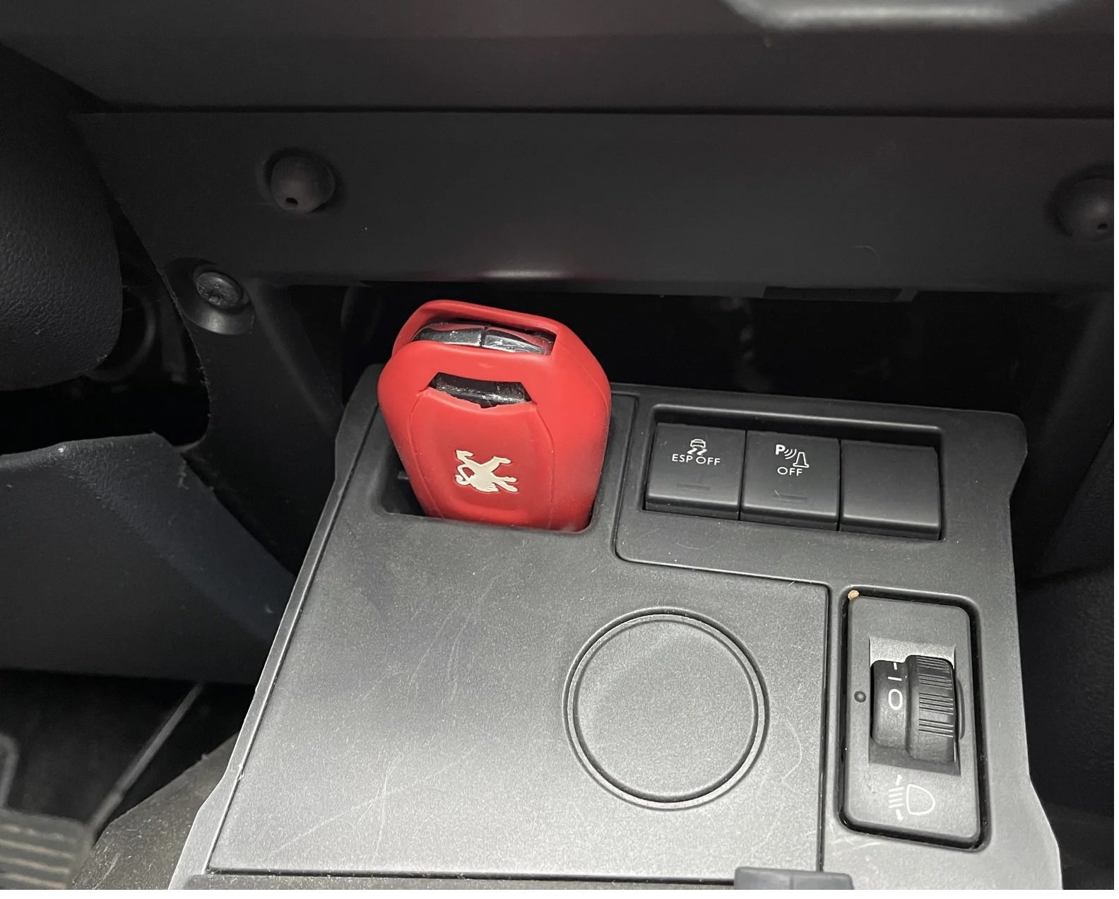

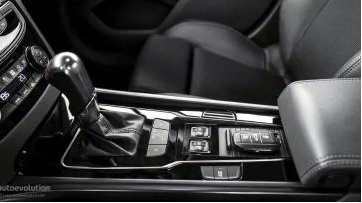

And this is like the key reader service position. I suppose that this is not the case because otherwise maybe you hadn't any communication with diagbox or whatever.
