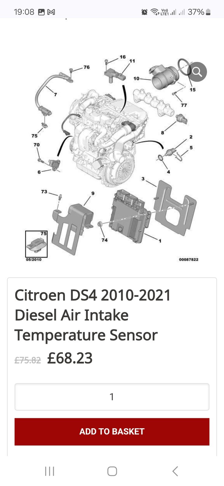

Yes I thought it was incorporated into the MAF sensor and that has been located with the intention of replacing. However after constantly being pointed towards a sensor that looked nothing like a MAF sensor i did some further research as to where the IAT actually was on the 64 plate DS4
The IAT Sensor according to Citroen Parts direct is labelled as number 11 in the diagram linked https://citroendirectparts.co.uk/produc ... re-sensor/
This evening I have been out to the car again and put the new sensor back in as testing as working fine with a multimeter set to Ohm.
Managed to erase the code, no eml when car started, took for test drive for a good 20 mins. Returned home, switched engine off, then back on again and the EML returned.

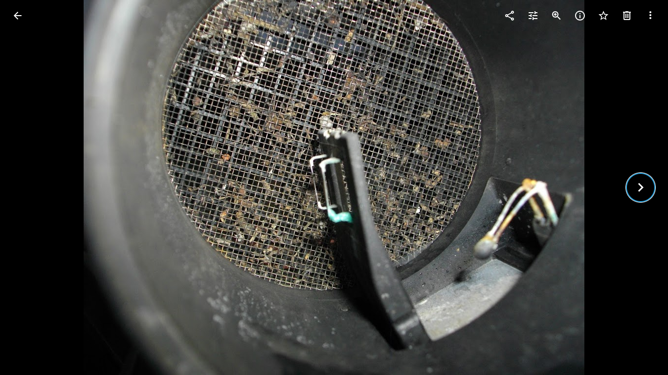

This is the MAF in my C5, ruined when the wheel arch liner flew to buts and lots of muck and water sucked up from the road.
You can see the fine wires and the thermistor (temperature sensor) on the right. Lots of muck and leaves too.

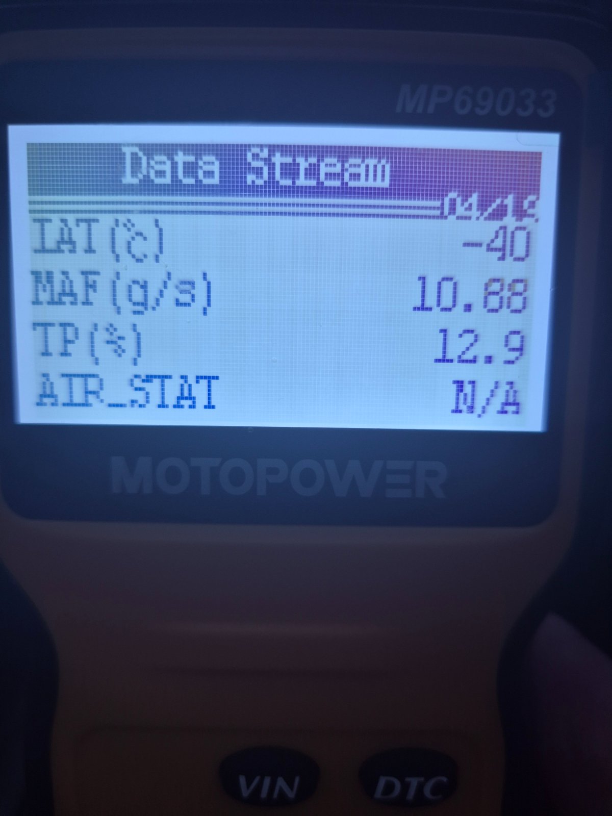

Does your code reader do live data, this will show the values the sensor thinks the IAT is. Ought to be ambient before starting and then a bit higher, maybe about 30°C once everything is warmed up. Without live data you are wasting time/money trying to guess the faulty sensor. You do not need to pay much to get a reader with some live data eg from Gendan https://www.gendan.co.uk/product_FXNT200.html

Yeh i took the hose off when we initially had toe warning on the dash. And it was clear. However, having said that it would defiantly be worth another lookmyglaren wrote: 10 Feb 2025, 21:34

The link to it suggests it gives live data and IAT is normally one you should be able to see. Also note the freeze frame data before you delete the code since this gives you sensor values when the fault occurred.

I will plug it in tomorrow and see what data it gives me. I am pretty sure when I was playing about with it earlier there was an option for live

IAT sensor reading -40 on the live.
