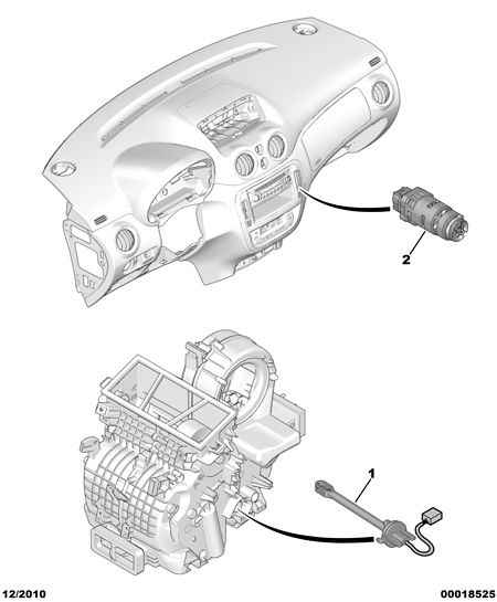

Hi, my AC is acting up.
I have a strong feeling the inside temperature sensor is faulty, due to the fact that the climate system acts like the temperature is very high.
Do any of you know where it is located on a citroen c3 II bluehdi 100?
I tried to remove the plastic panels on the footwell on both sides, i found the aluminum pipes but can't find the sensor.
To help understand what I'm looking for, look at the picture

It looks like #2 is the interior temperature sensor.
Fab1182
- Posts: 3
- Joined: 08 Feb 2025, 09:30
Re: Interior temperature sensor
That's a 1st series, my car is a 2nd series.
Out of curiosity, what's #1?

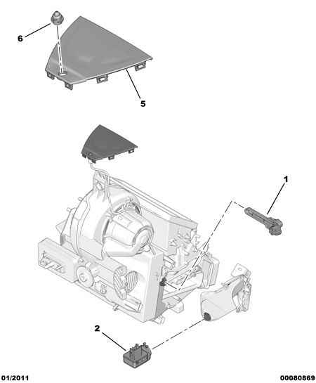

#1 (in the previous post) is the evaporator temperature sensor.
The picture below is for later cars, with #1 being the evaporator sensor, #2 the (outlet?) temperature probe and #6 the (ambient?) sensor.
- Posts: 12585
- x 1488
I think 6 is the sun sensor? The original pic would appear to be the evaporator sensor. Really needs a diag session to see what temps are being read.
