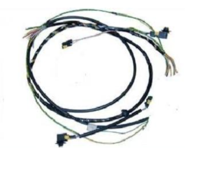

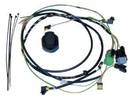

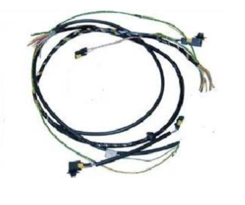

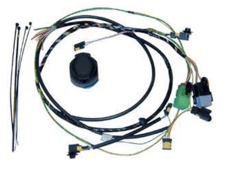

You won't be able to transfer that I suspect as the DT20 engine C5 X7 3.0 HDi requires a specific harness.
Ok, specifically for your C5 X7 3.0 HDi, the following are compatible:
SWAN’S NECK TOWING BALL, (9427CX) (Thule) (Sorry about the photo - that's the official one!). Towbar Harness 13 Channel, specific for the DT20 (3.0 HDi) (9428F8) (Non-specific photo, but will contain the correct trailer Fuse Box. Fits tow hitch Part Nos. 9427CV, 9427CW, 9427CX, 9427CY. TOWBAR HARNESS ADDITIONAL (Provides power for a Caravan Fridge) (1609732180)
