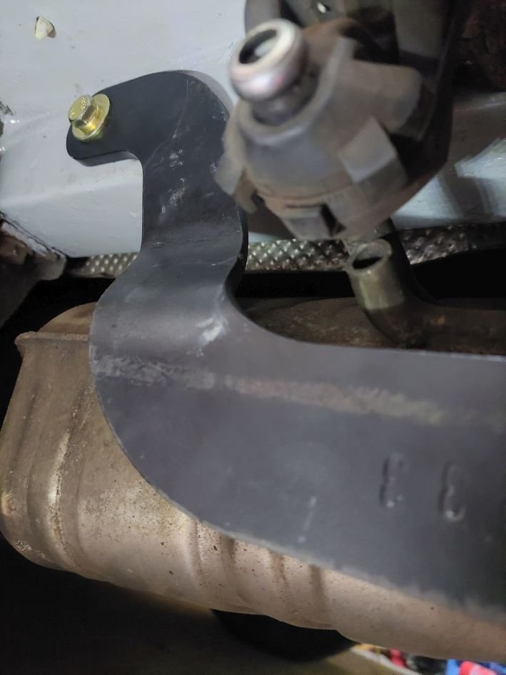

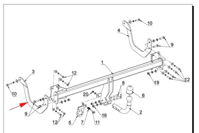

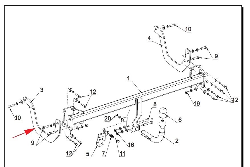

I am installing a towbar to my C5 x7 2.2HDI/170 and I have a few questions. I bought a new towbar, which according to the catalog fits all C5 X7 Tourers, except "GT 2.2 HDI". I do not know the "GT" version with this engine, but I noticed what the problem is. The left bracket (marked with an arrow in the photo below) originally almost touches the muffler.
The towbar manufacturer wrote in the instructions "one exhaust pipe", but I assumed that he meant the version with a wide muffler and two exhaust pipes on both sides of the rear of the car. To prevent the vibrating muffler from hitting the towbar, I modified the bracket by bent on a press brake (8mm thick sheet metal) and everything fits.

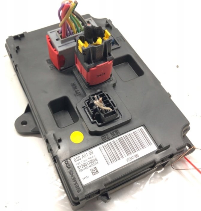

I would like to ask about the electrical installation. I bought a used BSC A0100 module and I want to use it, using the 6-pin electrical connector and the adapter for the module. Please help me determine whether BSC 0100 will work with my BSI. VIN: VF7**************[VIN obfuscated, can be read by forum staff] and what is the correct wiring diagram for this VIN.
Please also advise whether the module can directly power the "stop" lamp in the trailer from output 6 (21A0), or does it have to be a relay (the famous double relay 8801 on the wiring diagram).

I hadn't noticed that this discussion had progressed so much! Just to add some more info: the towbar I installed on my 2.2 HDi is made by a Polish company called Auto-Hak (from S?upsk) – they’ve been manufacturing towbars for years. It’s the basic P-33 version, which cost around €150. It’s a very solid bit of kit. They also offer the P33A and P33V versions with detachable tow balls.
Regarding the towbar module and the wiring: I used a second-hand OEM module (as seen in my previous photos), but I built the wiring loom myself using heavy-duty multi-core cable typically used in industrial automation (Helukabel).
The only real challenge was sourcing a trailer socket equipped with a microswitch (the sensor that detects a trailer plug). I could only find sockets with an NC (Normally Closed) switch, which required a small modification. I know some people just install a hidden manual switch in the boot for towing mode, but if you skip this switch entirely, the BSI won't monitor the trailer's indicators or deactivate the rear parking sensors (PDC). It could also affect the stability control logic (ESP), as the car needs to 'know' it’s towing a load.
A quick note on the brake light relay (8801) shown in the wiring diagrams: it's not actually necessary. Instead, you can simply bridge the three outputs from the module and run a direct wire to the lamps. The car has been towing frequently for over a year now, and everything works perfectly.

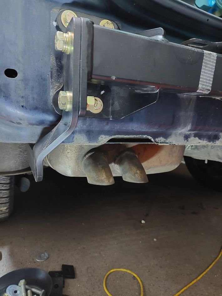

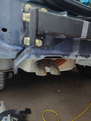

Can't lay my hands in the right thread, so I'll add them here directly:
(Also some fixing of broken plastics - hence the pop rivets and bits of scrap aluminium)
I didn't have the exhaust fouling issue - it's pretty close but never clanged against it.
