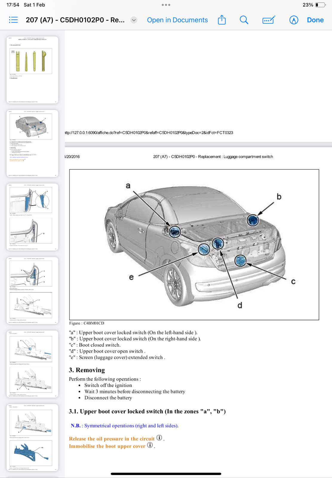

After the boot opens which micro is the next to trigger the sequence? Is it on the parcel shelf?
Has anyone got a diagram of the micro positioning in the boot area or a link to pictures.

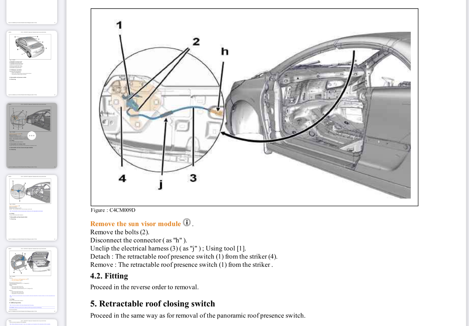

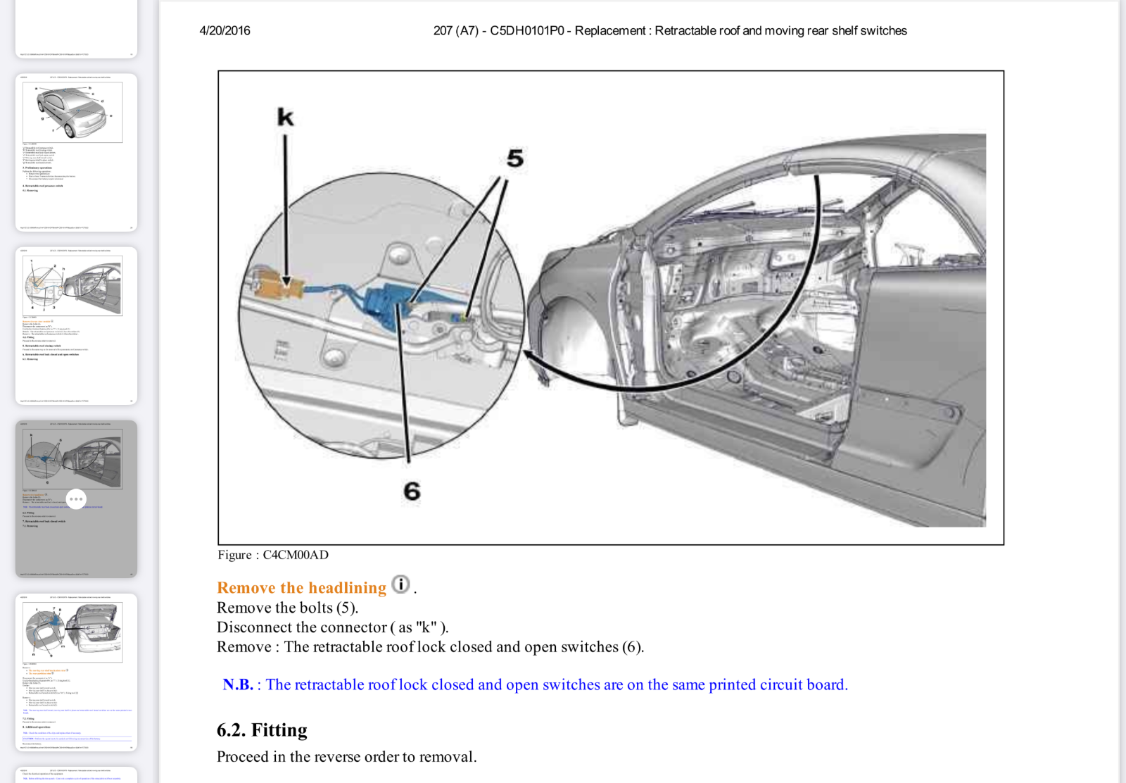

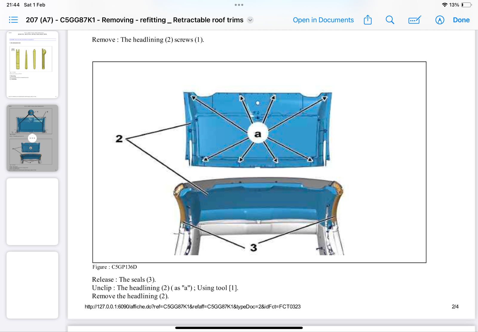

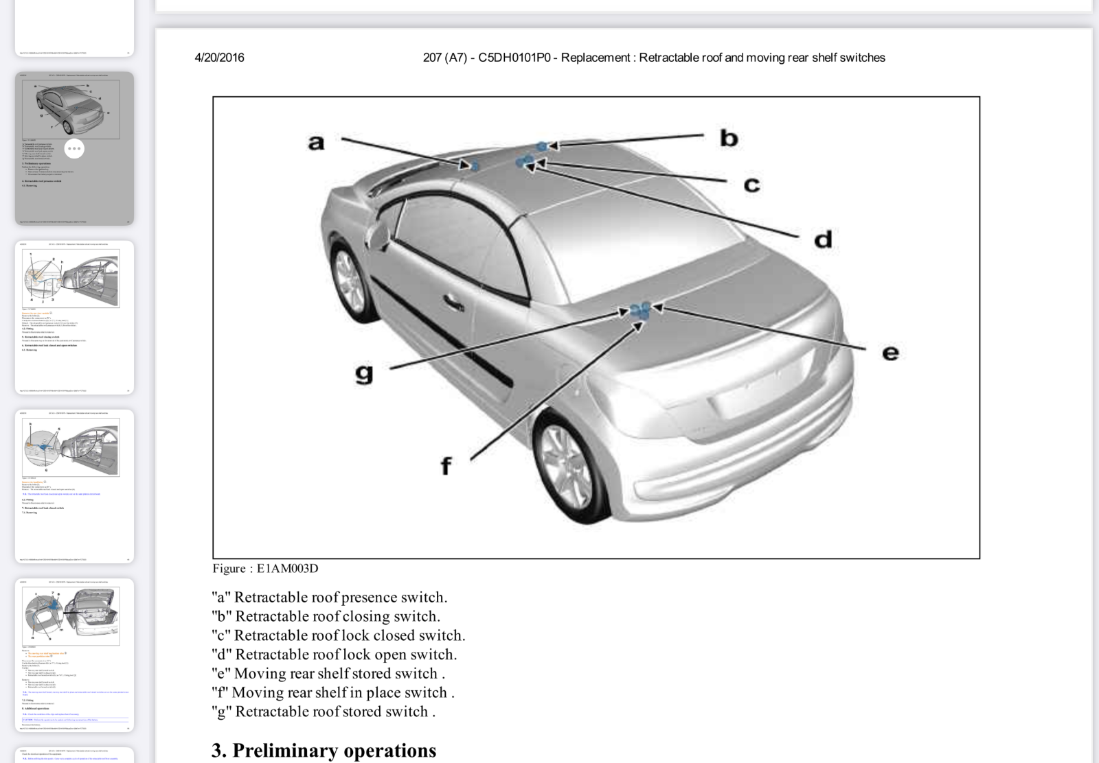

Peter5761
Posts: 13
Joined: 27 Jan 2025, 17:19
x 4
Re: Roof Problems again
Unread post by Peter5761 »

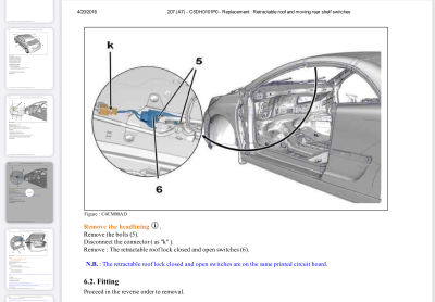

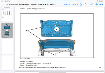

Diagrams of Micros
