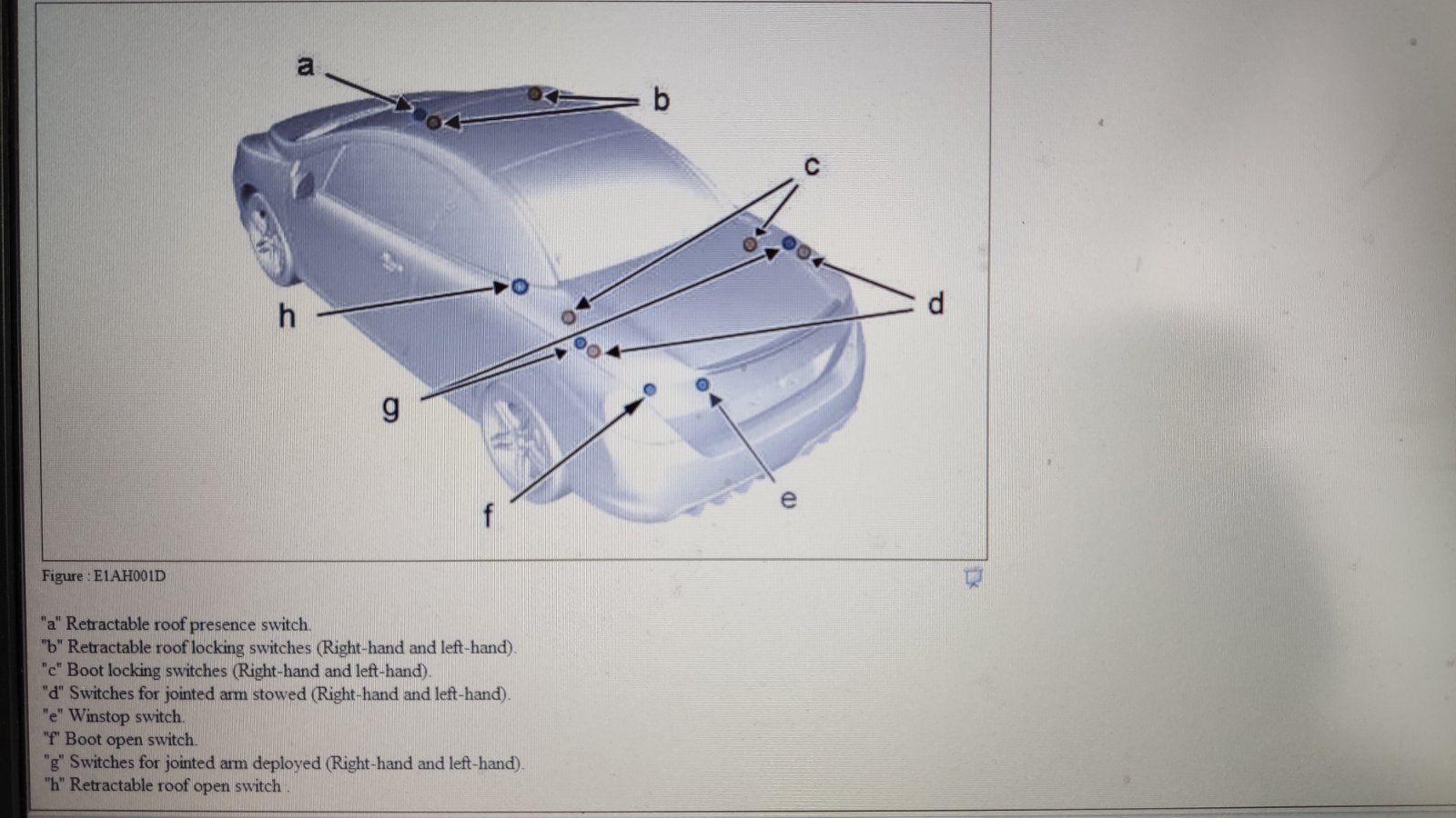

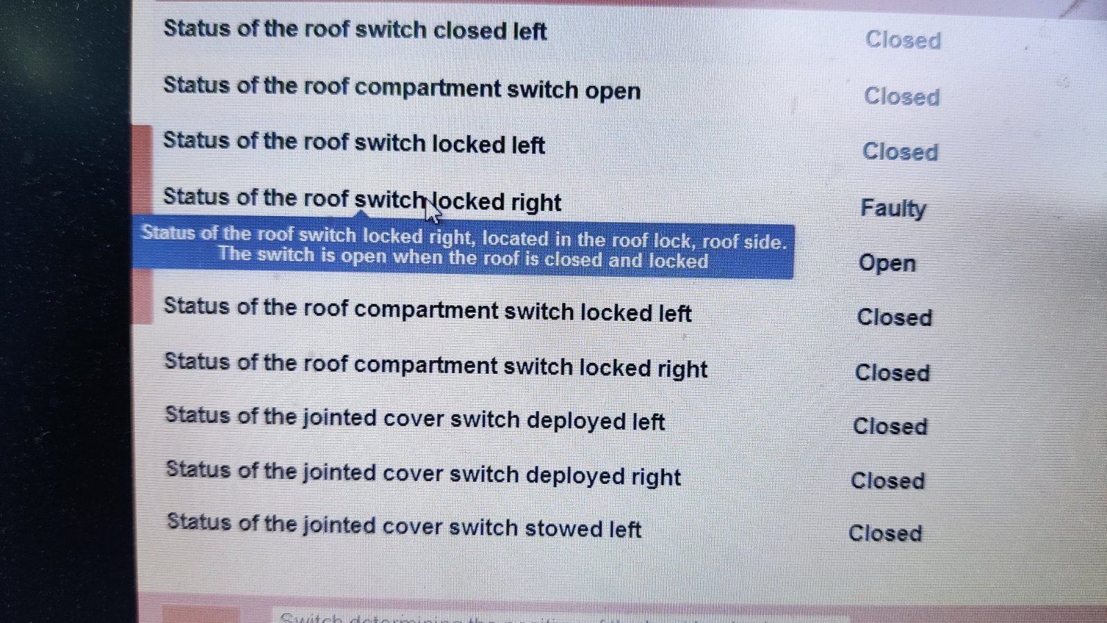

Hi Guys need a bit of help with the location of the roof close switches on my 308 cc. I have the following Diabox errors and wondered if anyone has the servicebox info showing where these switches are located. Thanks
9884 Right Hand roof locked switch signal fault
98A0 Left Hand side Roof boot locking switch signal fault

In diag if you will highlight line with error code you will get description

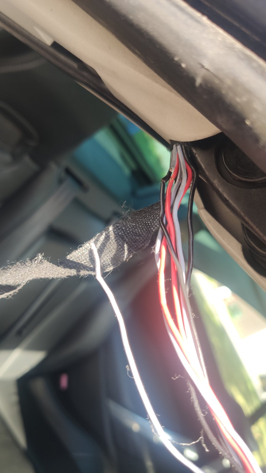

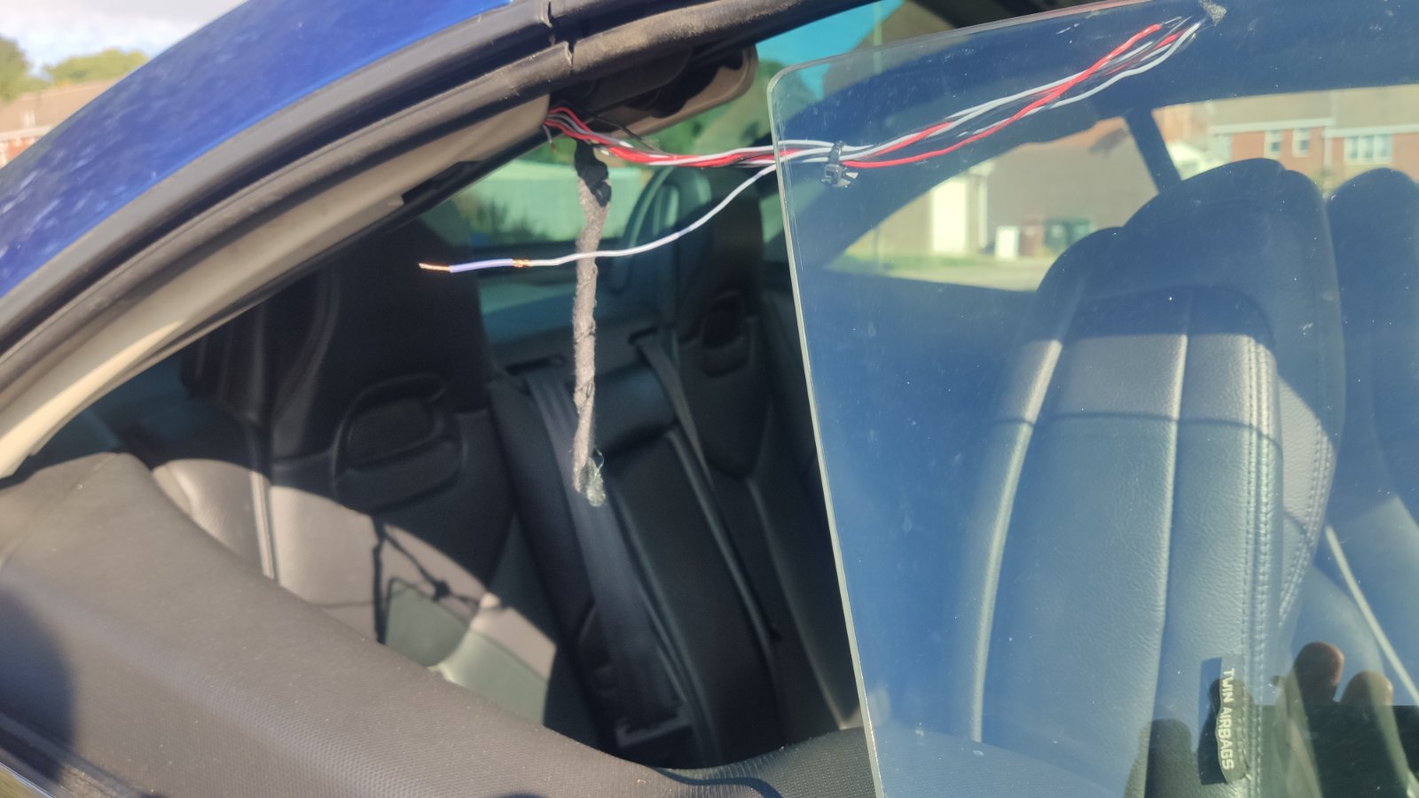

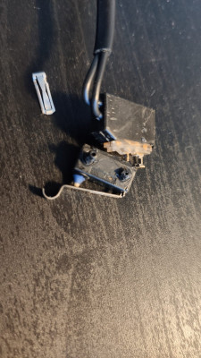

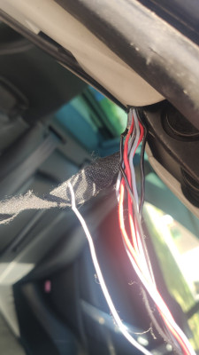

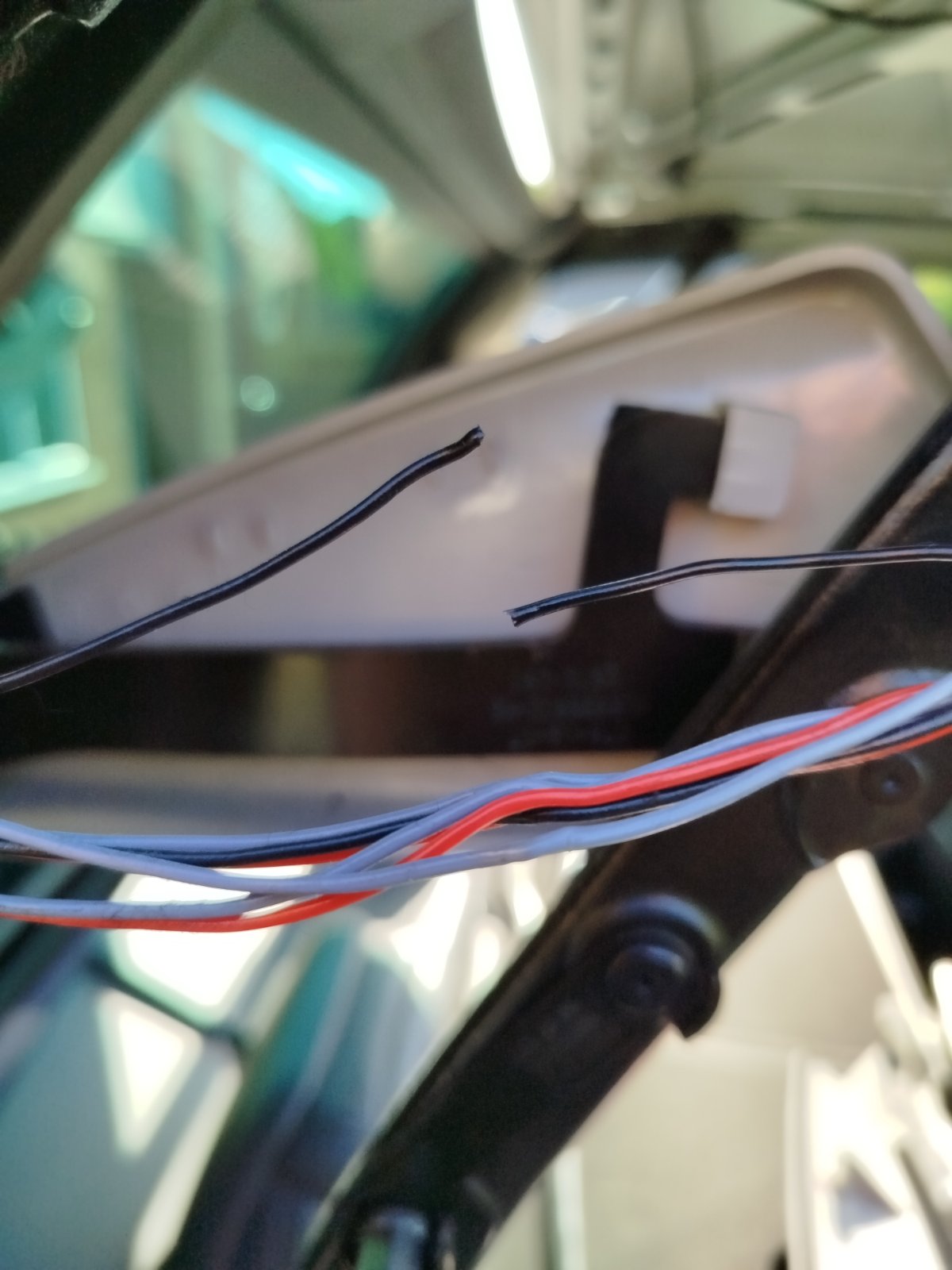

In most cases you will have a problem with roof switches b on the diagram. Problem lays with the loom. Over the time cable will snap. Before u will order a new switch check the loom. You have to put roof into intermediate position. Take out headliner. Then on the driver side of the roof you will see loom going from front locking mechanism and joining dome light loom. Dig it out. Take out black insulation tape and u will see probably this))

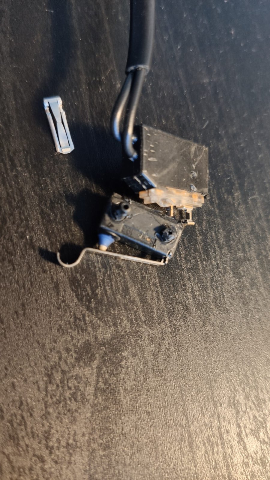

Sometimes swotches are faulty... But check loom first

Hi, just wanted to say thank you, just fixed my roof after coming across this discussion [-o<
