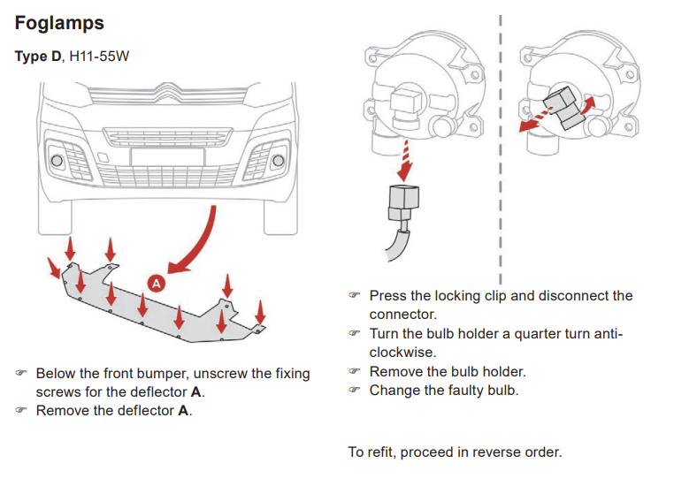

How do you change the passenger side bulb on a Citroen Dispatch 2018? its the lower circular one its fixed in side the moulded bumper below the main headlight
x 6945
Re: Bulb change

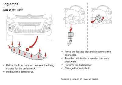

It's all in your handbook. If you don't have one see this link to download one: You first need ti remove the under body protection to get access to the area behind the bumper.
viewtopic.php?t=63208
