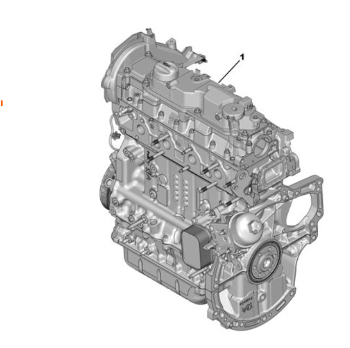

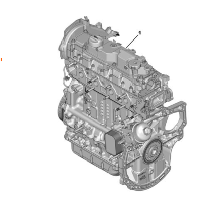

Ok, so be aware your vehicle could be fitted with 2 variants, both with the same marking, one fitted with the oil pump without control solenoid valve and the other with the oil control pump fitted with the solenoid valve. I can't help you with this part as even official parts says either one.
(1) New OEM Engine Marking BH01 without control solenoid, part: 1612521380, £10,264.70
Standard Exchange Engine Marking BH01 without control solenoid valve, part: 1612521480, £5,507.90
New OEM Engine Marking BH01 with control solenoid valve, part: 1614411580, £9,655.57
Standard Exchange Engine Marking BH01 with control solenoid valve, part: 1614411680, £5,657.93
