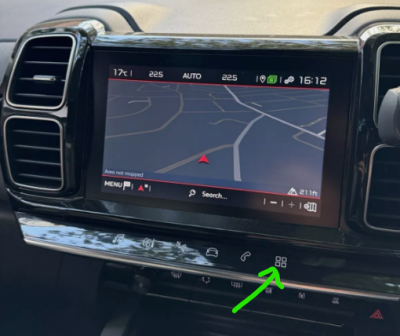

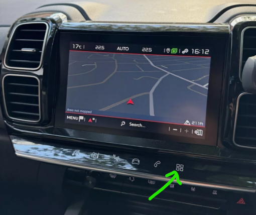

Hi, no problem. If you have Connected Nav, which you will if you have navigation built in, then the system is already Android Auto (for Android Phones) and Apple CarPlay compatible.
All you have to do is connect your iPhone via a USB cable to the vehicle's USB port. Then leave it for a few seconds to register on the Touchscreen, then press or touch the following 'hard' button :
shown under the display here:
This will then mirror your iPhone to your vehicle's touchscreen and you will have all the CarPlay enabled Apps available including Apple Maps or any other Map programme like Sygic or Waze.
You can then use Siri as normal, or press and hold the voice command button on the steering wheel to activate Siri (short press of voice command activates vehicle voice command interface, long press activates Siri on CarPlay)

I've been trying to follow your instructions for weeks, finally sorted it yesterday.
I had no luck, tried my phone and also my wife's. Both iPhone 16 Pro Plus, nothing. Changed cables, nothing.
Eventually in desperation, I tried a third cable... Bingo...!!
Thanks for your help.

That is the most common problem! Cheap cables - some are only designed for charging and do not carry data channels, so will never work. I always recommend using an original cable from Apple - they're not that expensive and guaranteed to perform, keep your equipment safe from under / over voltage issues and generally just work.

Yes, you're right. Like all Apple stuff, it just works...!
The cable I bought was labeled "data and charging".
I can now use Apple Maps as well as the TomTom guidance.
