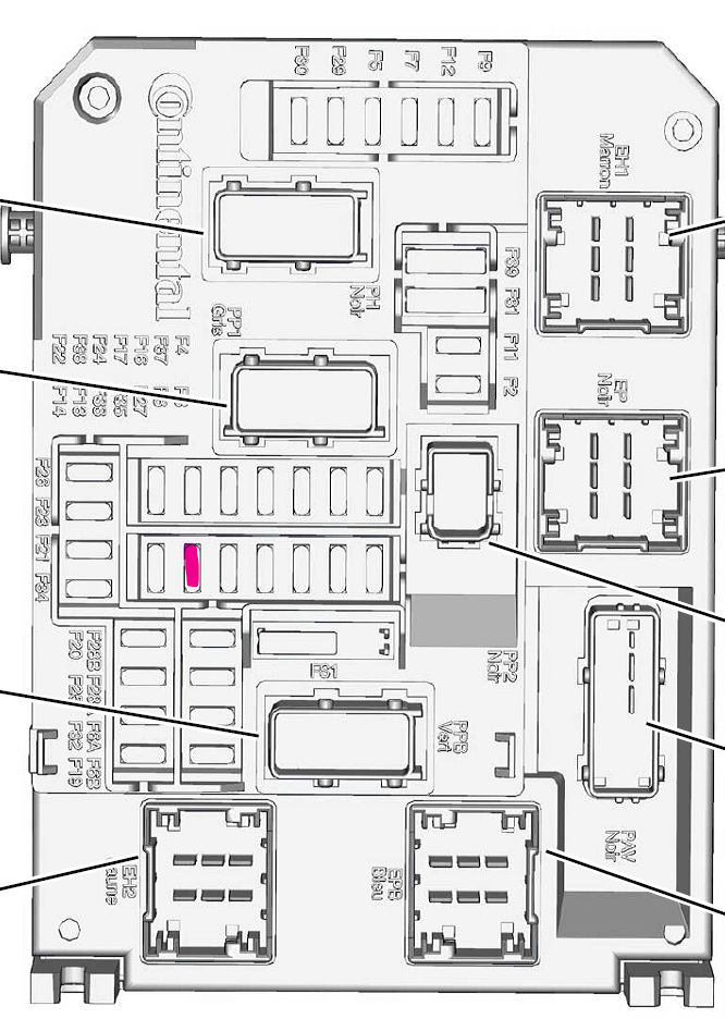

There are multiple fuse boxes - several in the engine bay and 2 or 3 surrounding the BSI in the passenger glovebox - my advice is be extremely careful with the wiring and connectors here - as this is the brain (master computer) of the vehicle that controls everything.
The one you need for the 12V Cigarette lighter is Fuse F13, located where I have marked it in Red:
You need to be a contortionist and have a good LED torch to navigate these.
