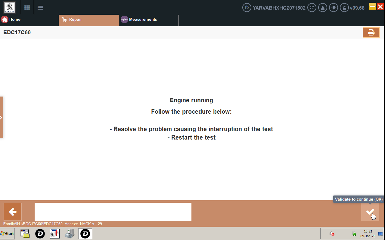

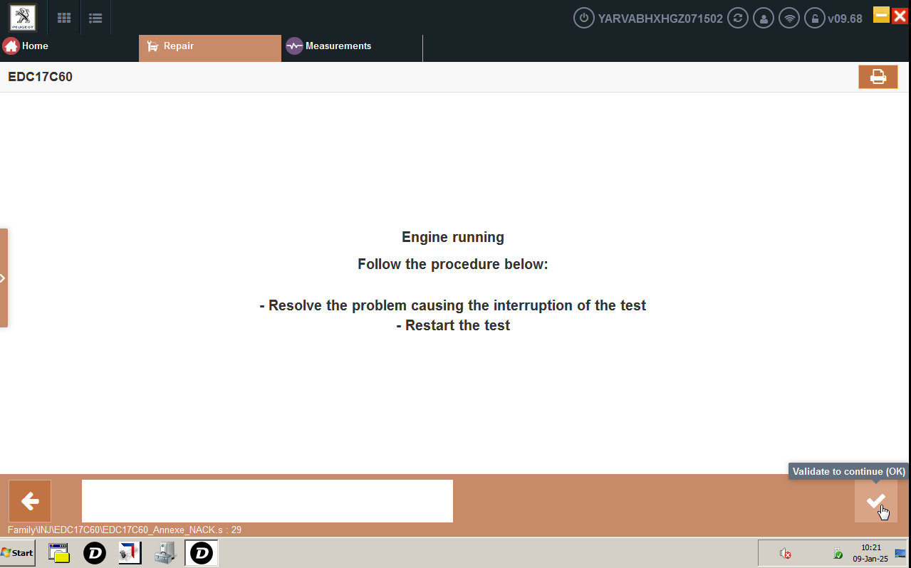

I read the ECU errors with the diagbox 9.68, and tried to clear the dpf error by telling the tool that I replaced the pdf, however I failed to do this.
The diagbox didn't accept this and prompted: "Resolve the Problem causing the interruption of the test"
Do you have any idea what do I do wrong? thanks!

Says engine running...that will be the fault preventing the update.

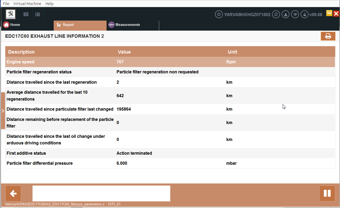

6 mbar pressure drop looks good, it should be fine after you have told it it's been replaced.

But I am very confidente the Engine was off 😔 so I am wondering if there is another requirement …

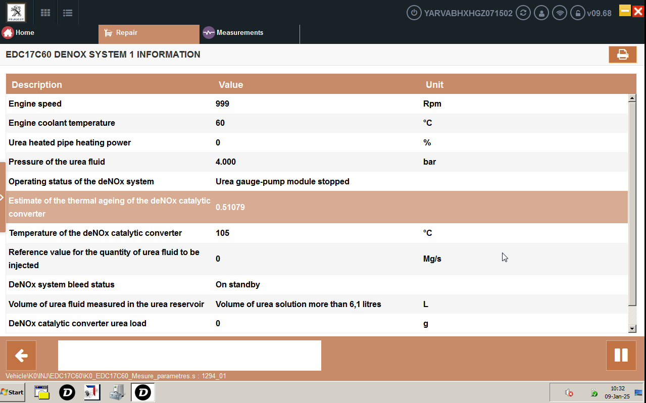

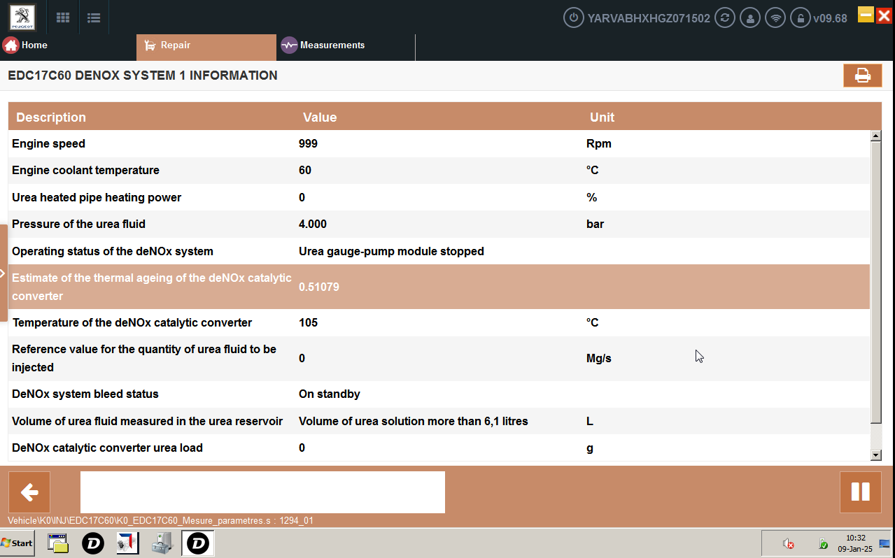

Your readings show 999 rpm in one page and 767 rpm in another so it looks like you need to go back and redo the procedure.
