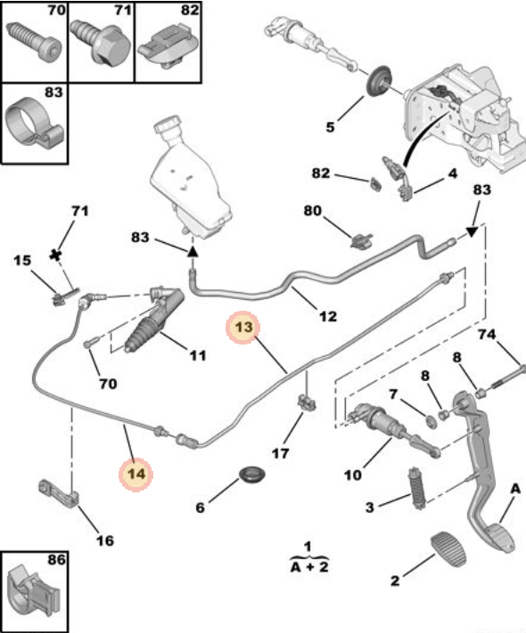

GiveMeABreak wrote: 21 Dec 2024, 10:31
Huskyxantia wrote: 21 Dec 2024, 10:21 Brake Clutch Slave Master Cylinder Pipe Connector Clip Seal
Ok so that helps.
No is the answer, these look to be the connections on the declutching control pipes and are part of the complete pipe assembly:
(13) Declutching Control Pipe, part: 2056T0, £47.90
(14) Declutching Control Pipe, part: 9678377780, £37.84

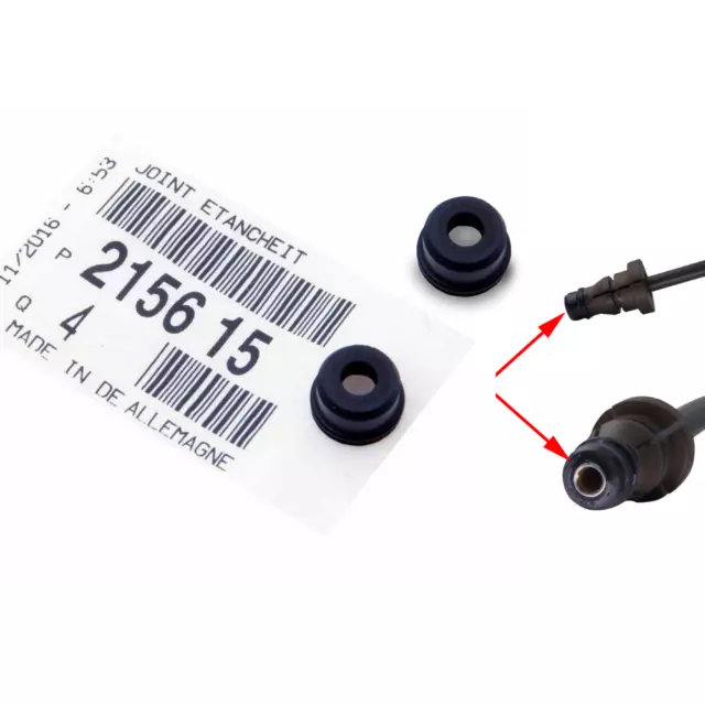

Hi, Haven't been in for years, please do excuse me for butting in. I was just browsing this thread and have an answer.
The top-hat seal on the left of the picture (was it pinched from a Fiesta thread on Reddit? :lol: ) is used not only on Stellantis group cars, but also Fords and VAG.
AFAIK, the rubber seals part number 2156.15
a.k.a. Ford (i.e. Mk6 transit master) 1430502
If you need the plastic piece on the right, I think you might as well buy a quantity from China on eBay / AliExpress / Amazon because cheaper. UK stock is quicker/costlier - either way they can be obtained on their own.
Hope this helps.
x 6956

Nothing to do with Reddit - those are official parts diagrams. :)

The Reddit comment was referring to original photo supplied by the OP as the Google Image search pinged back a match with a one year old Reddit thread post about a Fiesta clutch of an identical hand and oil spots on it.
I understand the rest of the post was slightly OT, but it did include the official Citroen part number 215615 which could be obtained from the dealer.

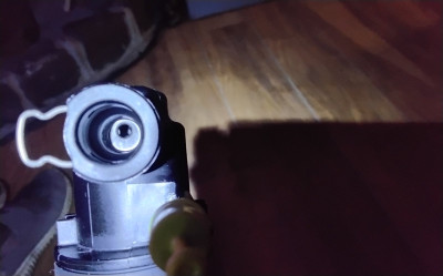

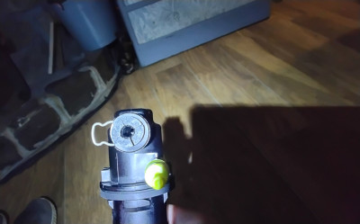

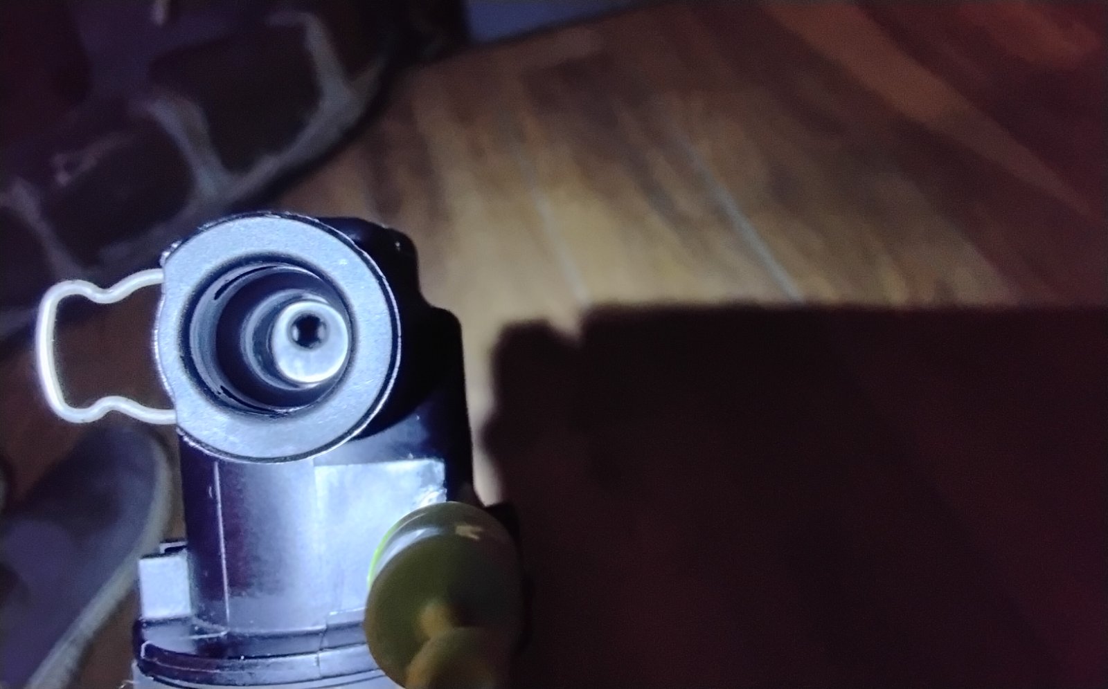

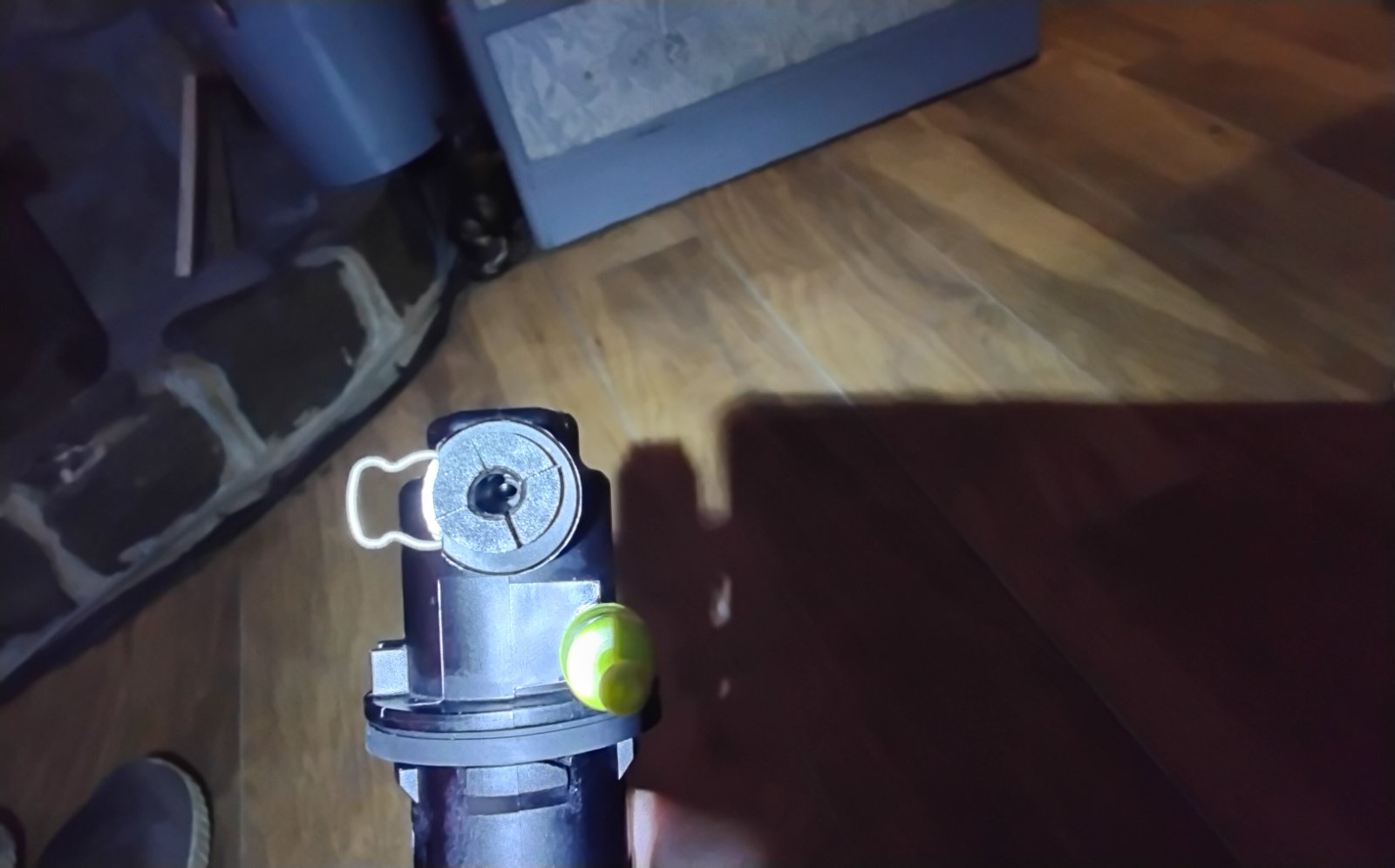

These photos show the off centered hole mentioned a bit back on this thread , shown with & without an attachment, if this is meant to be then OK, but if it isn't it could be a problem. Surely fluid needs to travel a straight passage ? Just a theory. Look for yourself & see what i mean.
:-D

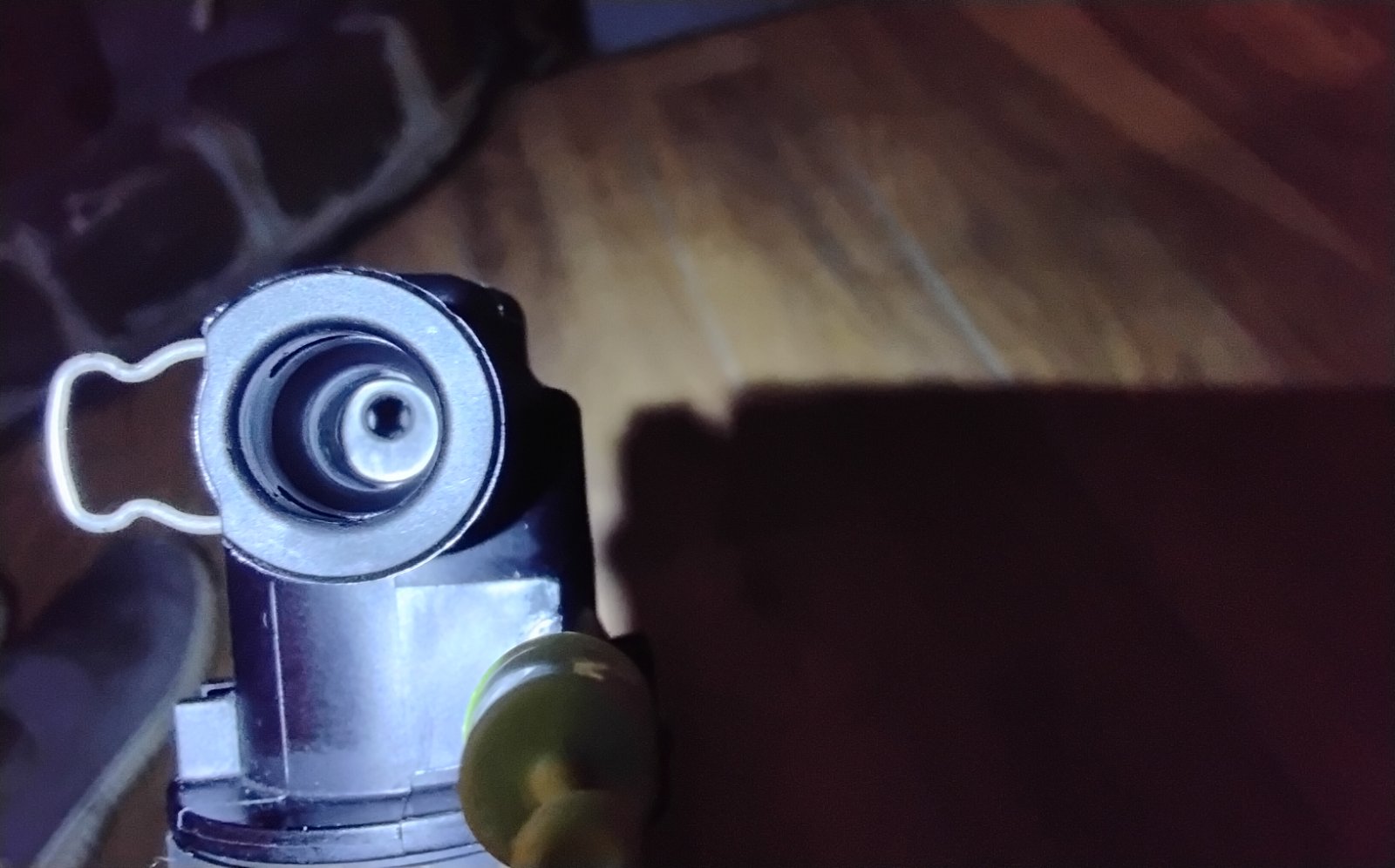

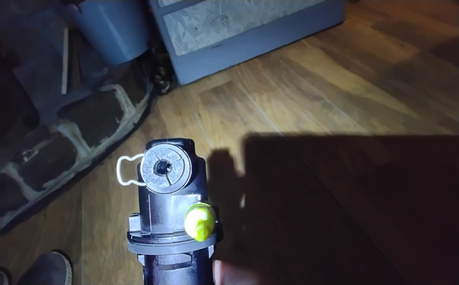

Above , are they needed ? Look more like a left hand drive car then right hand , are they just more to add to the confusion?

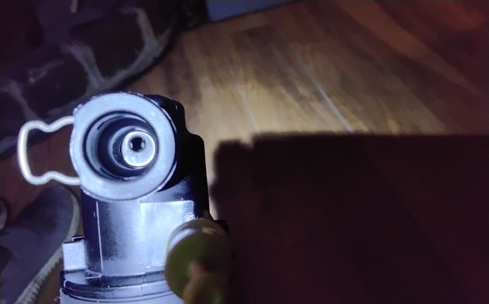

The rubber pieces were to keep dirt out of the part while in store or transit
