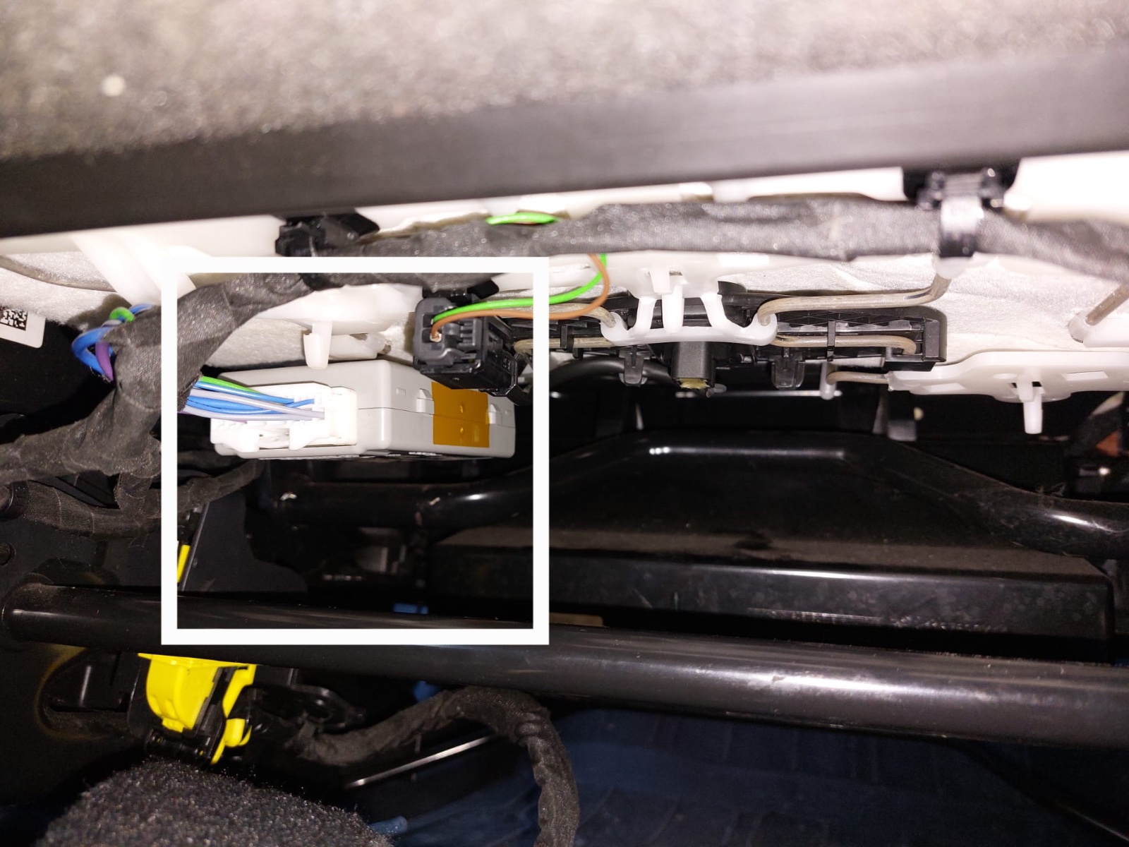

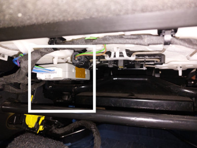

From underneath the rear of the front passenger seat you can see the Lumbar support unity, but you cannot see the clip to remove it and access is really tight, which is why the seat needs to be removed.

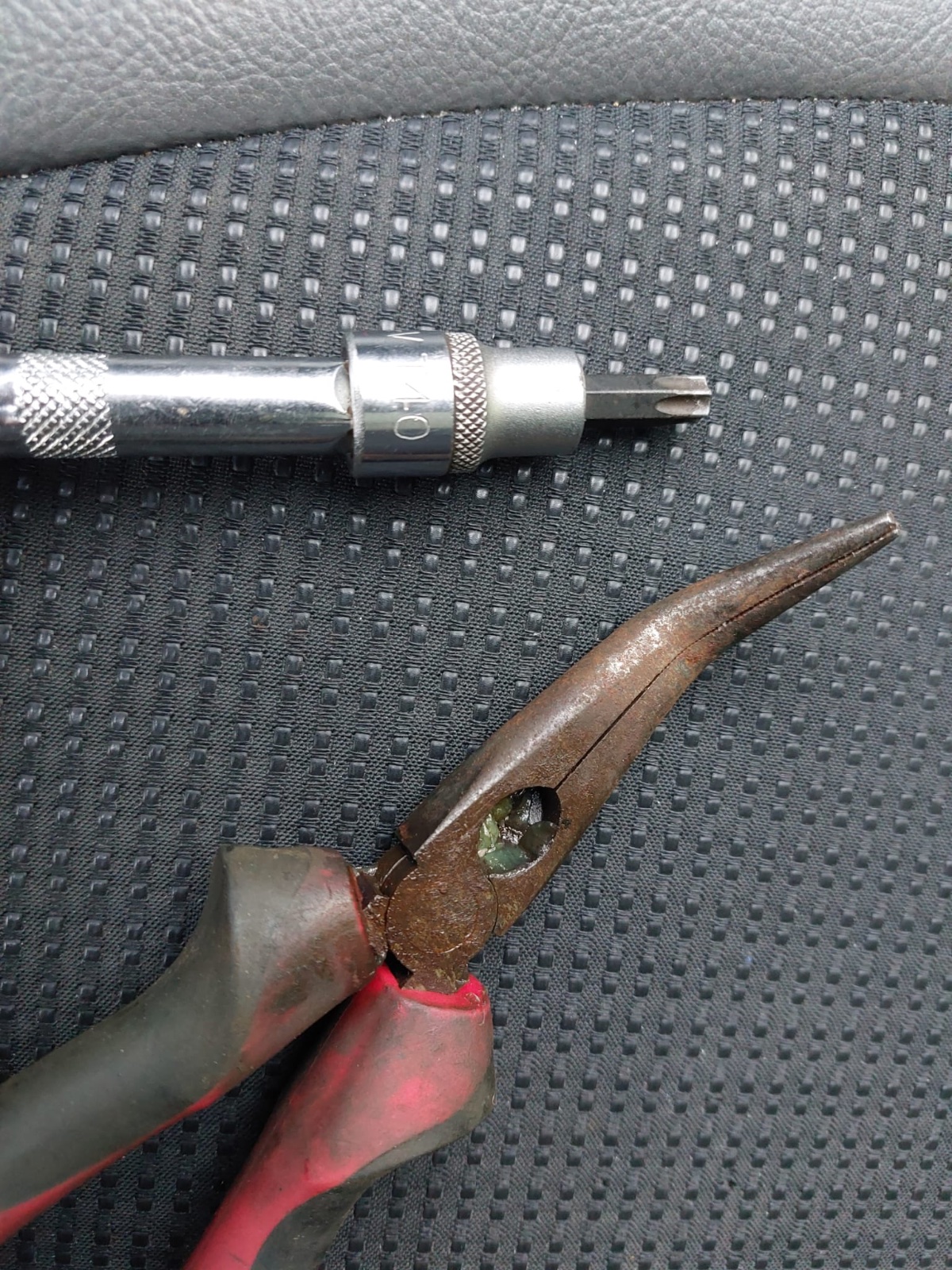

Tools for the job - T40 Torx and pliers

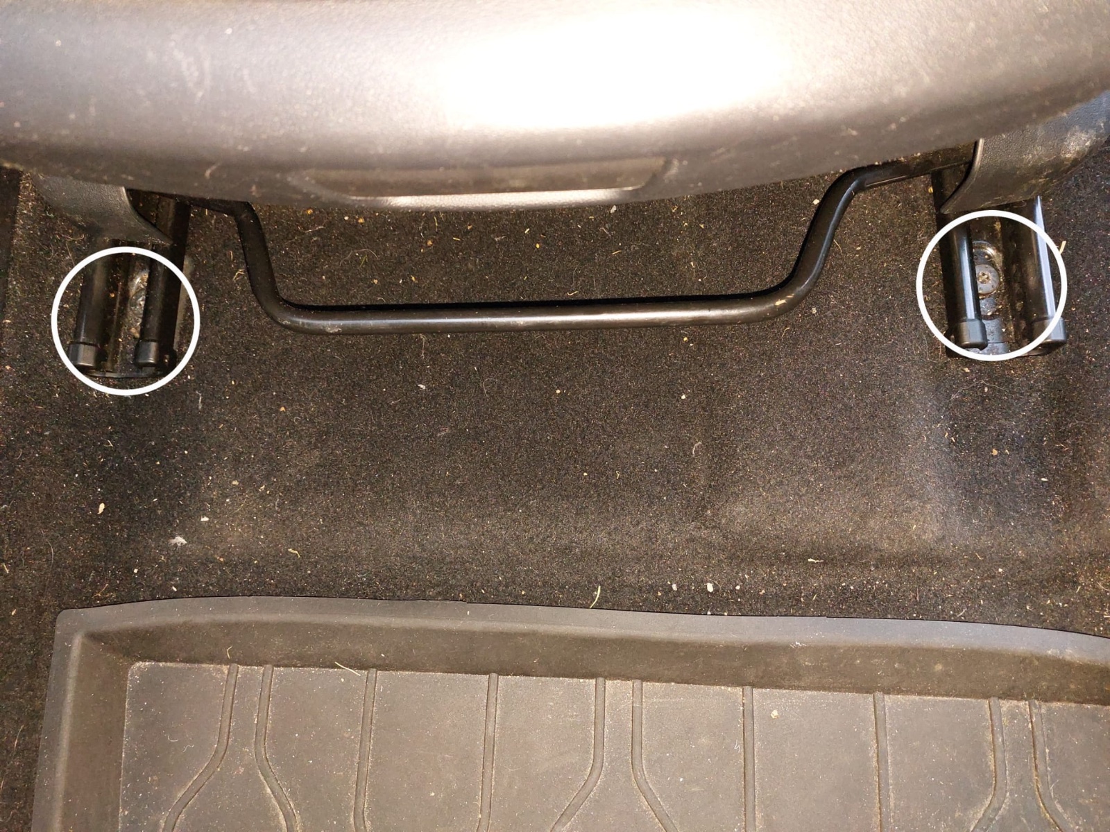

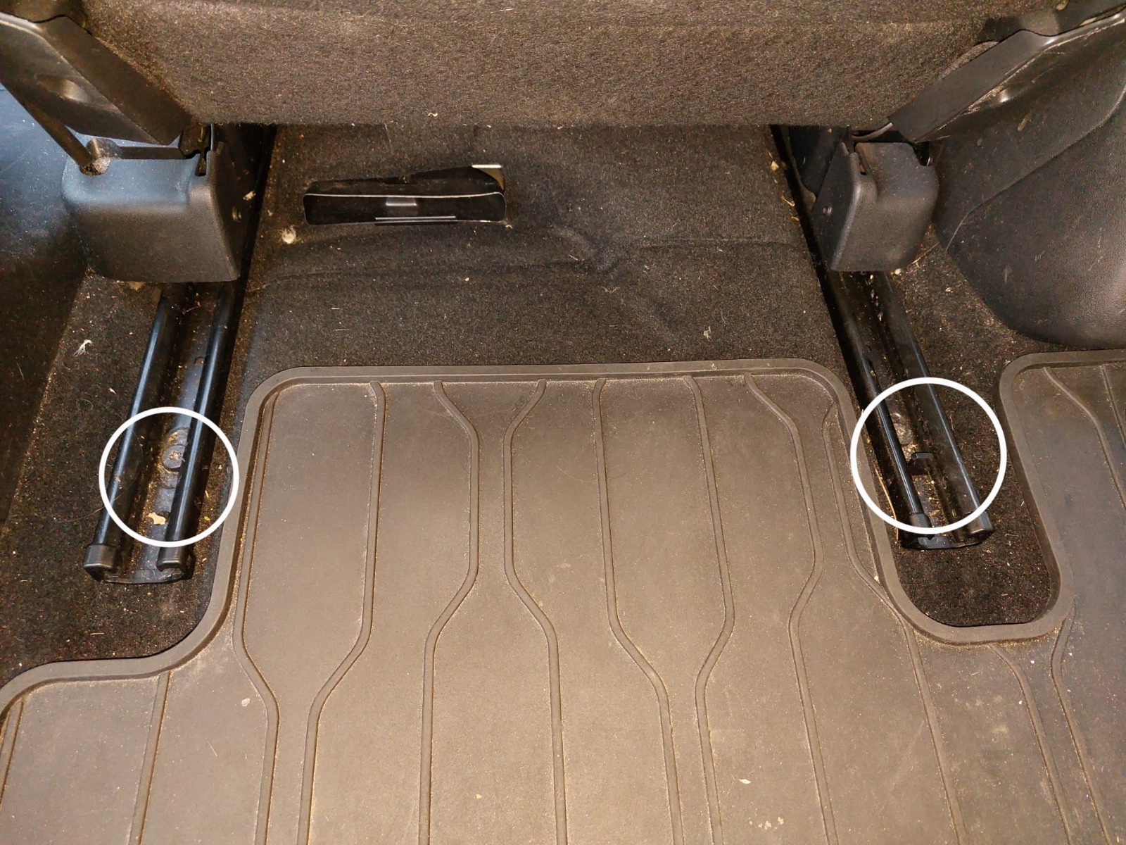

Slide the seat forward to remove the rear bolts 1st - this will make sense later
Now slide the seat backward to remove the front 2 bolts
As you begin to loosen the front Torx bolts the seat will naturally want to lean back toward the 2nd row seating, which is exactly what you want to happen.
Doing the bolts in this order avoids having to slide the seat again, which is a pain if the seat runners aren't retained by the bolts.

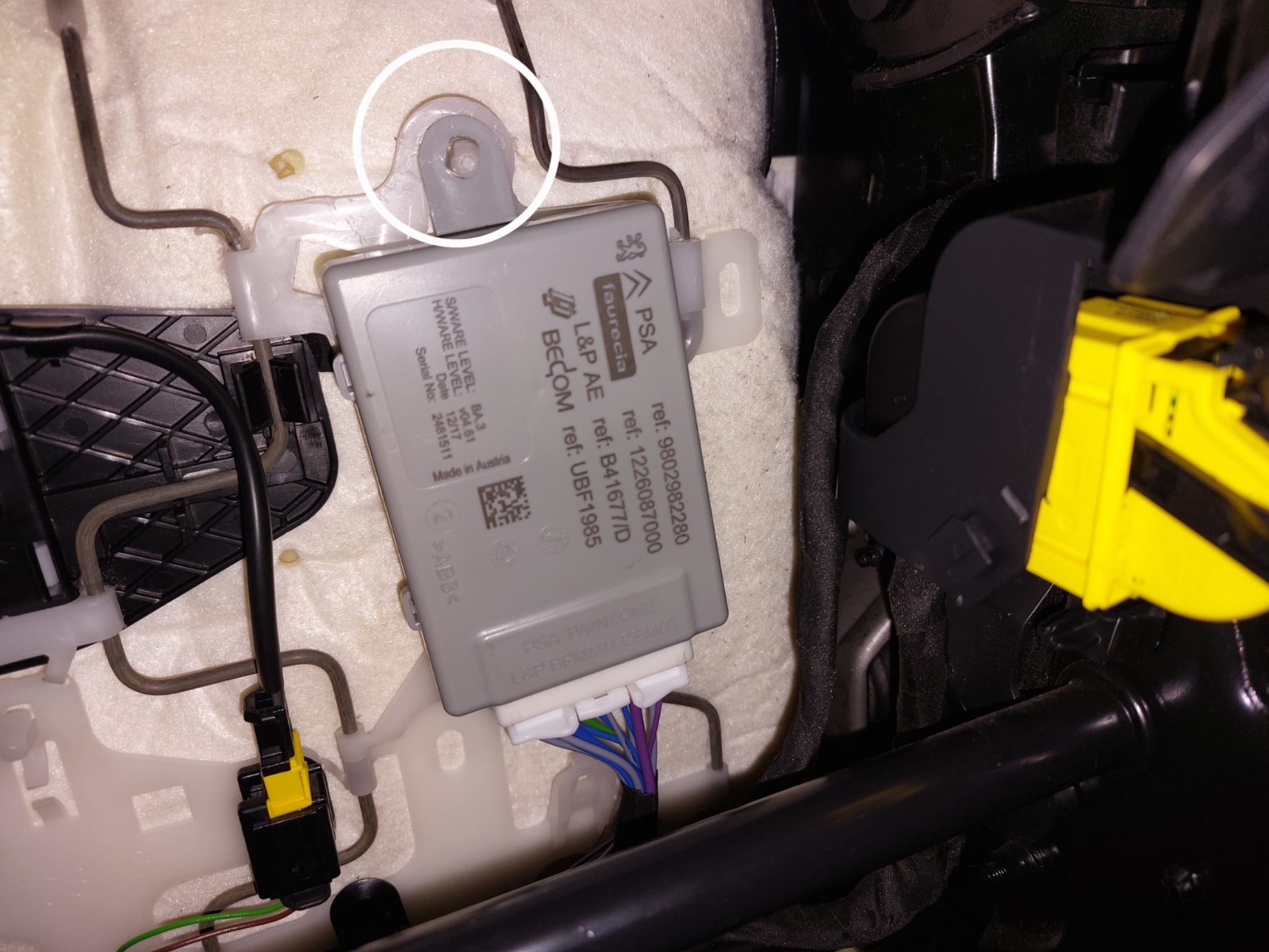

The clip that retains the Lumbar unit is now exposed.
Get your pliers onto the white clip and squeeze it together so you can remove the unit pass the clip.
