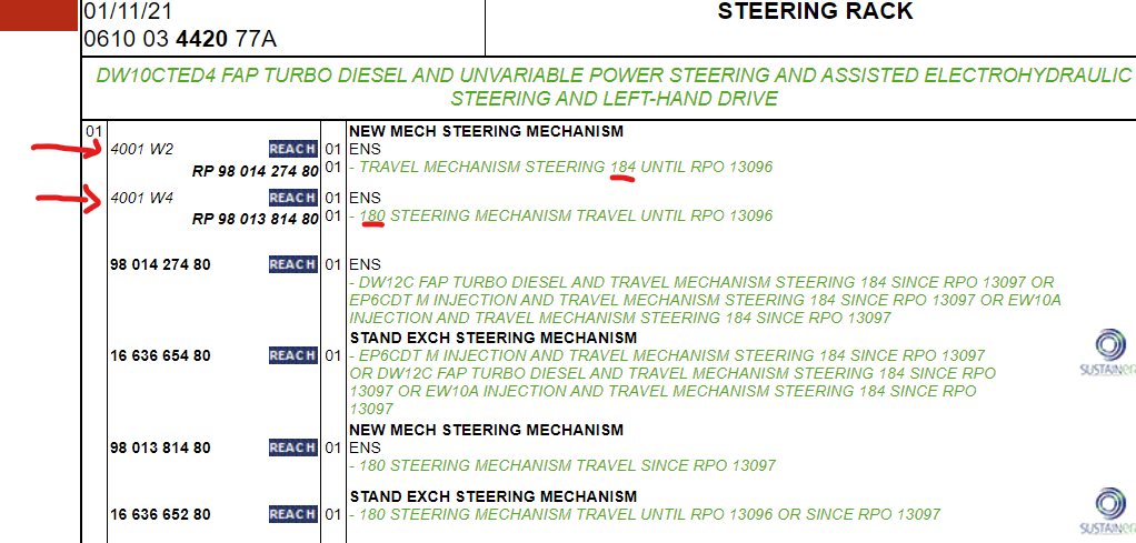

No, totally incorrect Mikael!
Part number 9685708380 is equivalent to PSA part 4001W2 - which is in fact a 184° Steering rack! So you have the incorrect rack fitted and this is likely why you are having problems. I would get that out as quick as you can before you damage the system..... as the car is turning the wheels at a greater angle than they were designed for.
This car, with this engine and setup was designed for a 180° Rack. After market garages are not clued up on all the technical aspects of the vehicles and rely on after-market parts databases that are very often incorrect. If they fitted the wrong one and ordered the incorrect part, then I'd be after them for the work and replacement of the correct rack at no charge and for any damage that has occurred as a result.

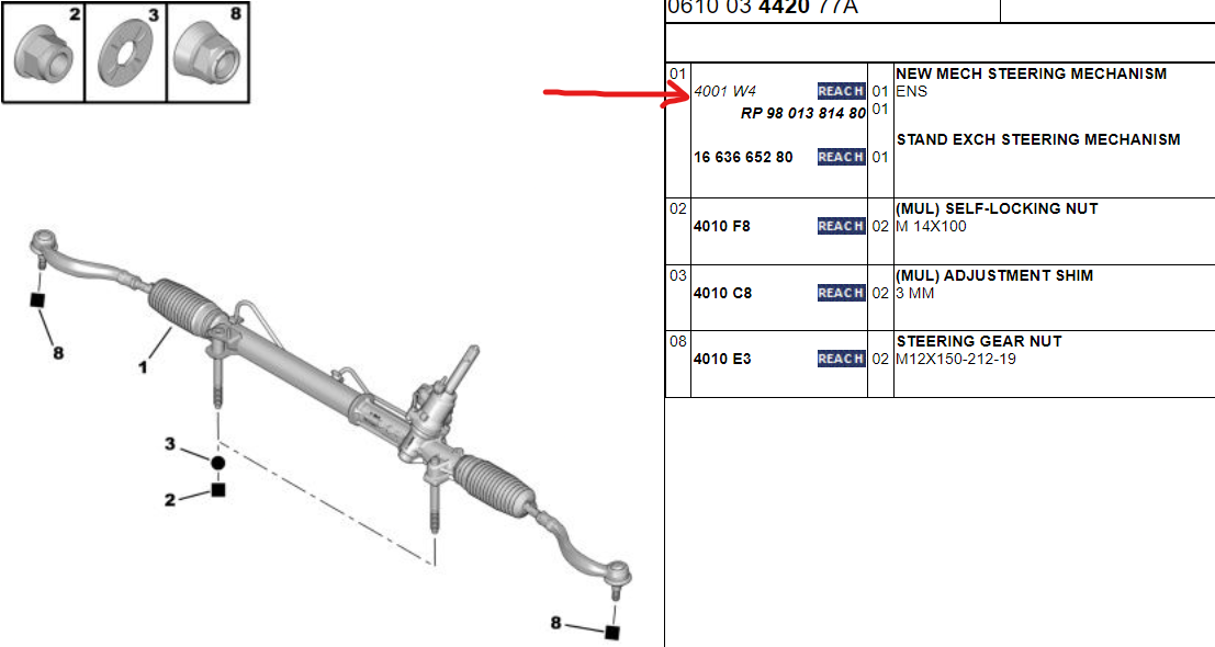

Your VIN is used on the official Citroen parts system that your dealer will use.
This is the part (4001W4) for your vehicle from the VIN:
When I take your VIN off, leaving it unfiltered, you can clearly see 4001W2 is incorrect and a different angle.
