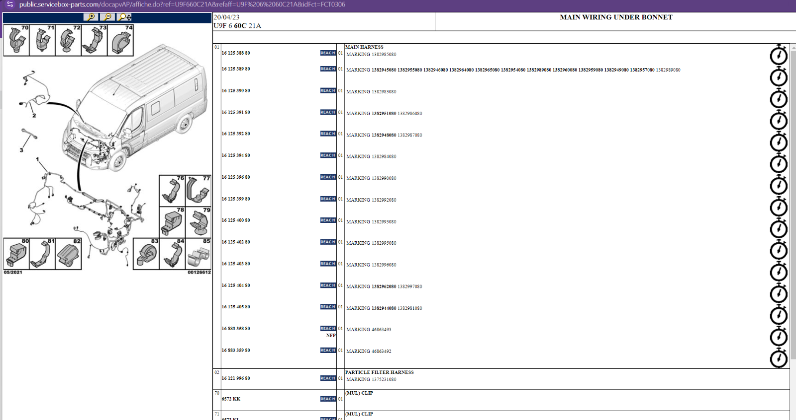

due to bad manipulation i have a burnt main wiring. Unfortunately the label burnt too.
I find about 41types of ,,main wiring under bonnet" ( for example: 1611514880 ). I wrote to Peugeot and they wrote, that they couldn't help me, because they do not know which wiring i have, when i do not have the label from wiring. So i get only the factory build sheet from them and trying to compare it based on it.
I still have six option of main wiring based on factory build sheet. Compared on Catcar.info - main wiring. There is written some parameters of main wiring.
My option based on comparison: 1611515580,1611515680,1611516080,1609922080,1611514880,1611514980 - my guess is the last two.

Yes, that's the only way to ensure you get the correct harness, because as you have said there are multiple harnesses, each fitted to different engines and equipment. We provide this as a service to our donating members. The info on CATcar.info is well out of date - they are using an old version that is 15 years old!

Unfortunately even Peugeot don't know what is fitted, giving 15 options
These are in the region of £2000 - £2500, and I imagine an engine out job to change. Scrap yard might be the best bet for a similar van?

With many wiring harnesses the VIN isn't enough, it often requires the 'tag' number off the original harness as the OP has found out, no good if its burnt out.RichardW wrote: 29 Nov 2024, 17:23 Unfortunately even Peugeot don't know what is fitted, giving 15 options![]()
Buying new from a dealer could easily write the van off, would be mad to buy a new harness from a dealer.
