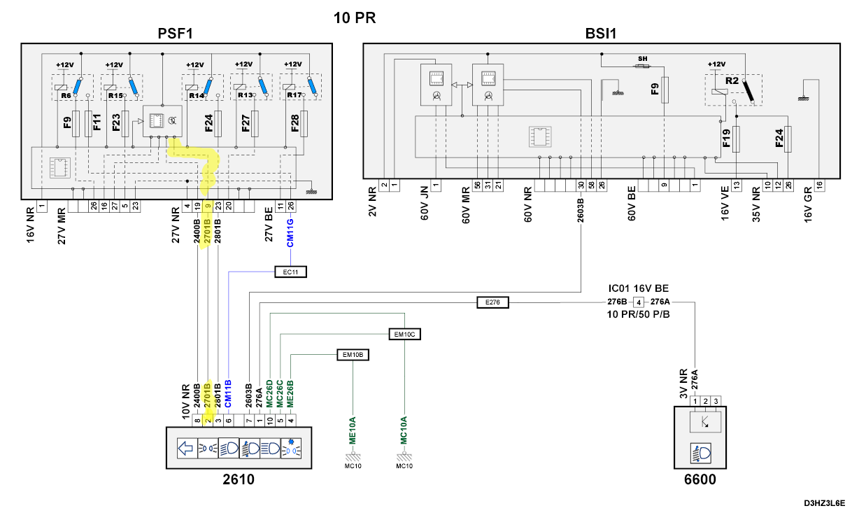

I can't find BSM in the drawing. I need a help please.

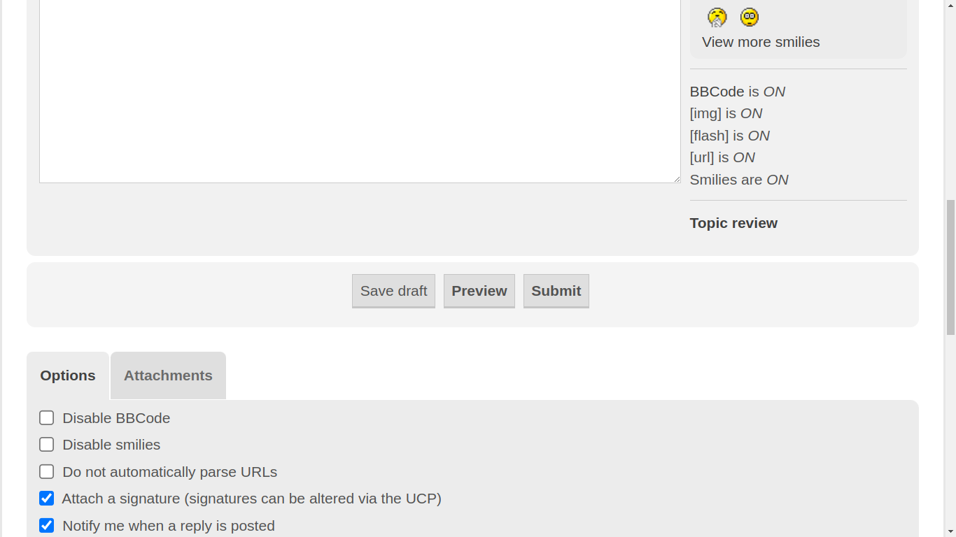

How to add image?
Thank you.

You can link to an image at an image hosting site but they often disappear, usually when a free site starts charging for their service.
We recommend that you upload your images direct to the forum.
There is a guide how to do so here

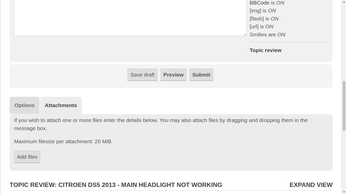

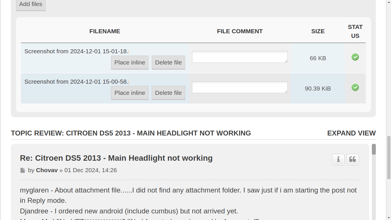

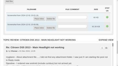

myglaren - About attachment file......I did not find any attachment folder. I saw just if i am starting the post not in Reply mode.
Djandree - I ordered new android (include cumbus) but not arrived yet.
Marc - My VIN - VF7**************[VIN obfuscated, can be read by forum staff]
I am very appreciate about your help. Thank you.

In the "Full Editor and Preview" mode, click the "Attachments" tab.
Then either drag and drop images into the text box or search for them with the
"Add Files" button.
To place the image where you want it to appear in your text, place the cursor in that position in the text then click the "Place Inline" button for the requisite image,
otherwise the images will appear at the foot of your text.

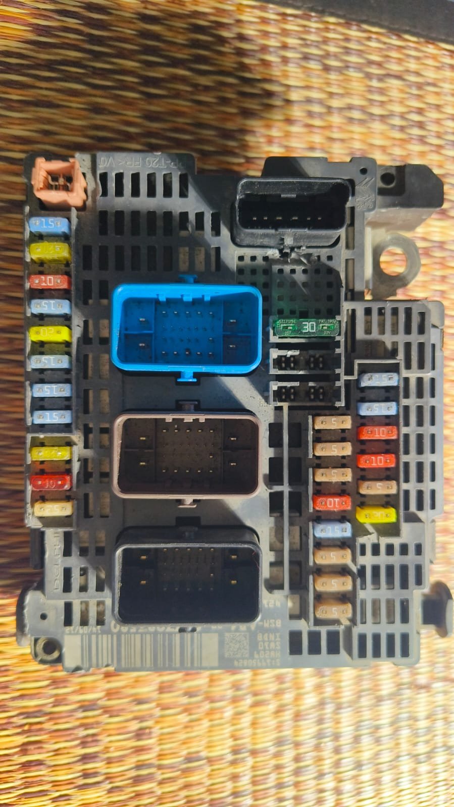

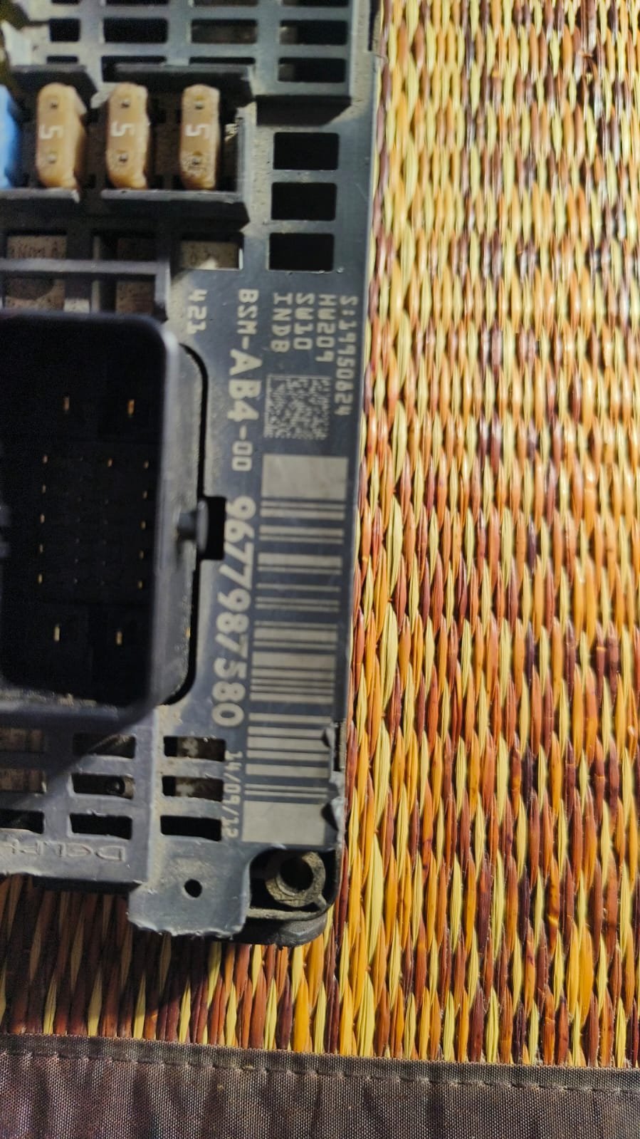

BSM=BSI1 ??? I can't see BSM in my drawing.
I clean the BSM with dust cleaner and WD40 contact cleaner. Now the horn work continuously without starting the vehicle.
The main headlight still not working.
In the drawing I only saw that the high beam is connected with a relay.
I did not see the main headlight connected through a relay. (Does not make sense) Can anyone help me find the faulty relay connected to the main headlight?
