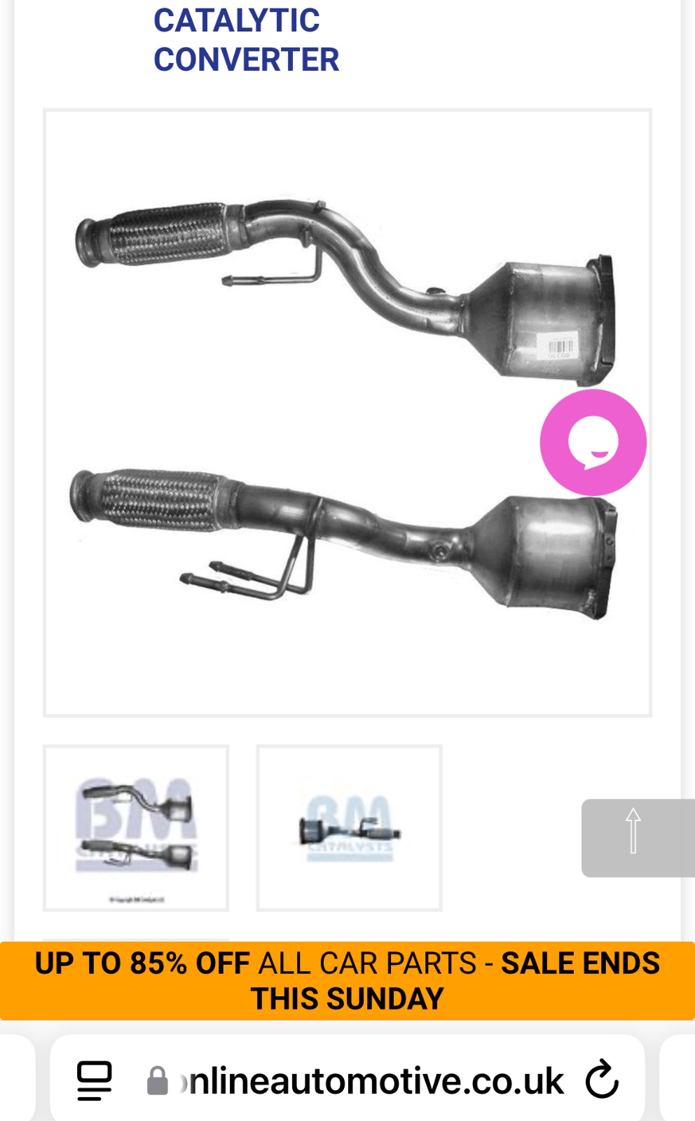

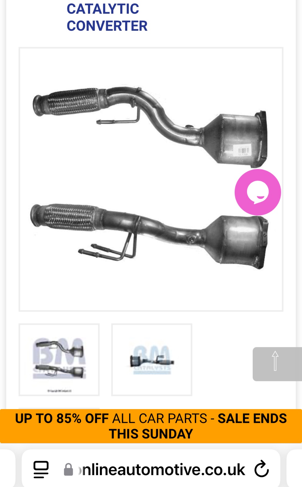

The diesel version will indeed have a cat, its bolted in front of the DPF.
Diesels have been using cats for many years, if i remember right even some XUD engines on Xantias had them
This part is the cat & the DPF bolts onto it
