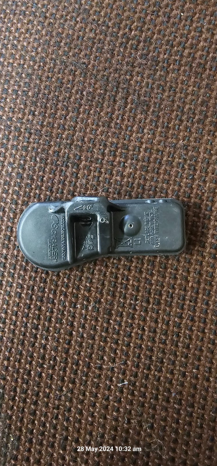

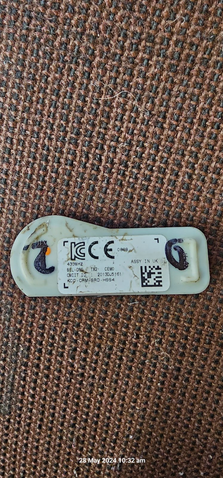

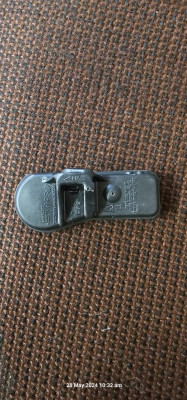

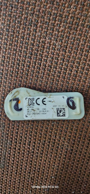

hi guys i have a 2015 ds5 and i think all the tmps sensors have got flat batteries.... they have been failing one by one and now all read puncture, i have been told they have a battery life of aprox 8-10 years so seems abt right if this info is correct. can anyone give me the part number for the sensors and also give me a link to an exciter tool to activate the new sensors and i have just purchased a lexia 3 and diagbox software and belive the new sensors can be programed via this? i will attatch pics of the sensors i took a pic of when getting a new tyre fitted but i have searched the numbers on it to no avail
many thanks in advance
btw if i take the valve core out and deflate tyres to say 5-9 psi them inflate them again the sesnors jump back into life for a short time

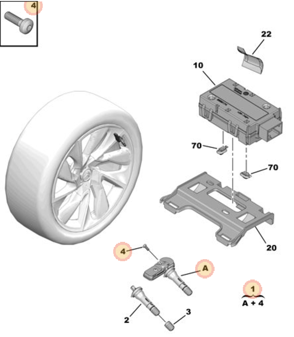

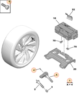

Ok, so here is the part you need:
(1) Under Inflation Transmitter Module, part: 9811536380, £164.99 each inc. VAT
These will need both Diagbox to pair and an Exciter tool to initialise them prior, but Diagbox should provide instructions. Remember to pair the whole lot together to avoid problems when replacing.
