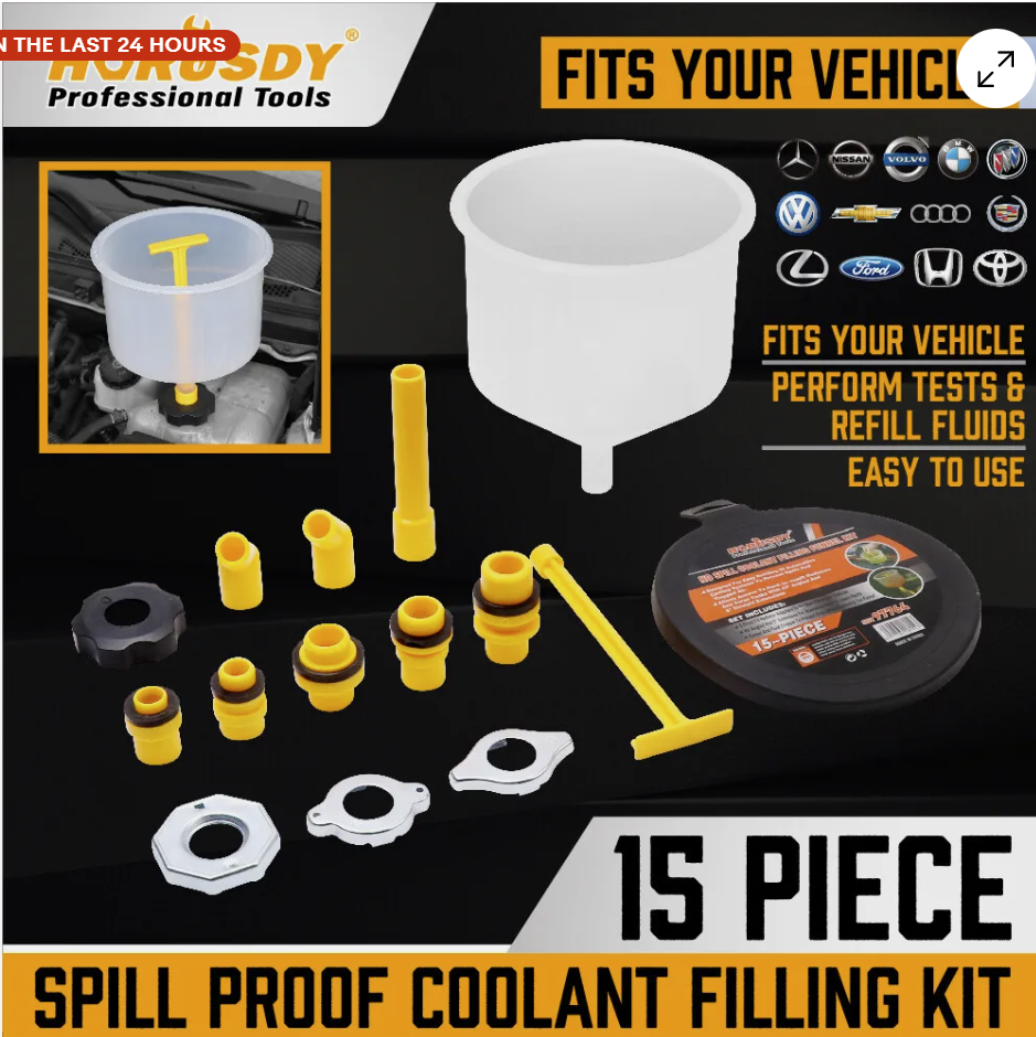

Ah damn ok thanks for that. So i'll need to get one of those special filling cylinders for the expansion tank ?
x 6946
Re: 207 coolant bleeding

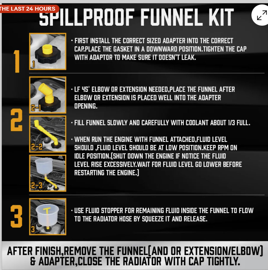

Well you'll need something equivalent to a filling cylinder if you don't have one.
Maybe something cheap like this, which has multiple adapters?
https://www.ebay.co.uk/itm/363570304038 ... BM8NrP59tk

thanks for all the info 👍
