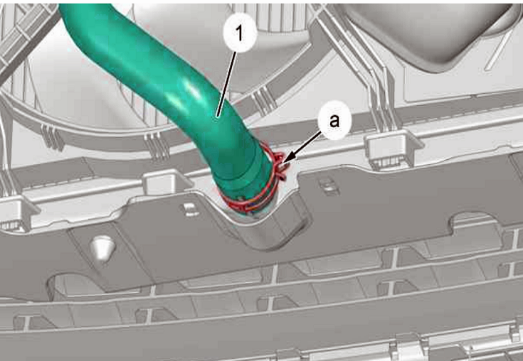

I went to change the coolant in the 207 1.4 HDi this afternoon. The manual says to replace the clip and seal on the back of the engine when it's being refilled. I cannot find any part numbers or indeed these items for sale on eBay or Amazon. Is it the clip and seal for the temperature sensor? Maybe I'm looking at the wrong part? Space is limited. Thanks guys

There is s specific operation for draining and refilling the cooling system and the system must be de-gassed after...
The clip being referred to is the hose clip (a) which come off when draining and is located under the cooling Fan (s):

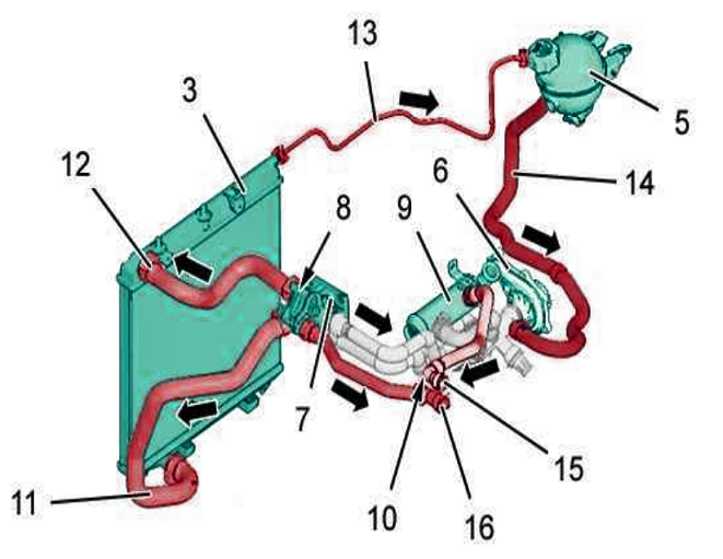

:rofl2: Why am I not surprised.
(3) Radiator.
(5) Expansion chamber.
(6) Water pump water inlet manifold.
(7) Coolant outlet housing (/).
(8) (/) thermostat.
(9) EGR valve .
(10) Heat exchanger outlet bleed screw.
Water pipes:
  • (11) Radiator outlet
  • (12) Radiator inlet
  • (13) Radiator degassing
  • (14) Expansion chamber outlet
  • (15) Heater matrix outlet
  • (16) Heater matrix inlet
There's no need to go anywhere near the back of it - here's the official procedure and I've only included the 'Gravity Feed' option for refilling here and not the Vacuum method with special tooling:

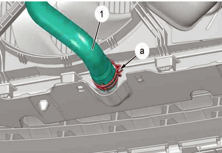

  • Uncouple the pipe (1) (at "a"); Using tool [0165-2] (Flexible Clip Pliers basically).

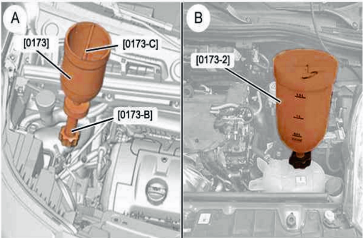

Filling the Cooling System
Connect the hose (1) (at "a") ; Using tool [0165-2] (Flexible Clip Pliers) - and this is where they suggest using new clips!

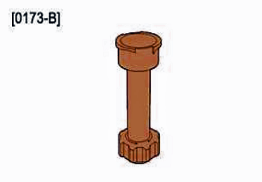

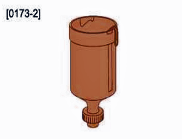

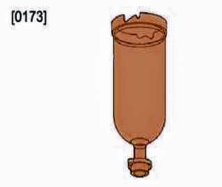

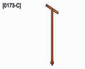

"A": Fitting with filling cylinder offset ; Using the tools [0173], [0173-B], [0173-C].
"B": Fitting with filling cylinder direct ; Using tool [0173-2].
Fit the filling cylinder, blank and adaptor assembly on the expansion chamber (according to assembly).
Open the rod on the filling cylinder.
Slowly fill the cooling system with clean coolant.
Close the bleed screw when the fluid is flowing freely without any air bubbles.
N.B.: The filling cylinder should be filled to the 1 litre mark for correct bleeding of the heater matrix.
