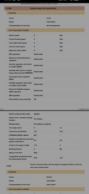

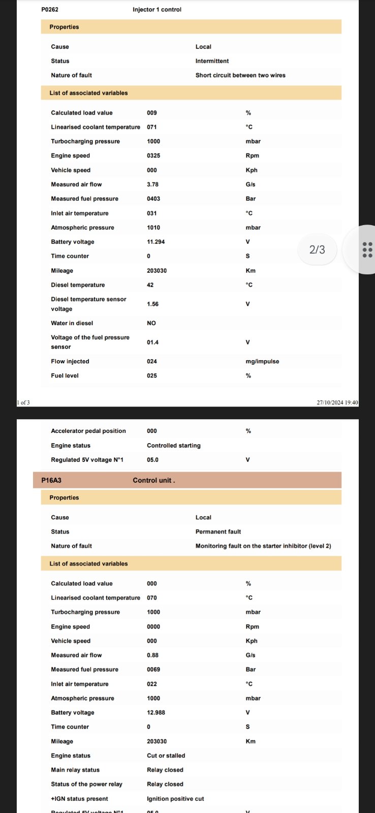

I have a problem with my car. Today i have got lots of error code. ESP/ASR error, brake error etc. I start my car and the engine stuttler at idling
I read the error from my car and I would have liked to attach it ,but I did not know.
So I write the error code:
U1208
C1391
P16A3
P0262
Citroen Grand C4 Picasso 2012 1.6 e-HDI injector error

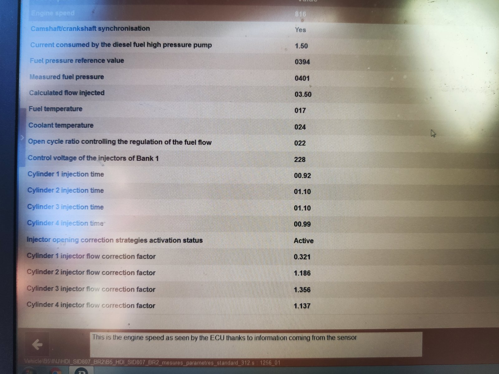

Hi again!
I bought a new injector. I replaced but I have a new problem. Now the No1 cylinder is okay but the injector is too fast and the idling is not so good.
I wrote the new injector code into the car. So I dont no what is the problem. I chose the injector code via Servicebox with VIN number.
And later I got a new error code
P12A1.
P16A3
P12A1.
P16A3
