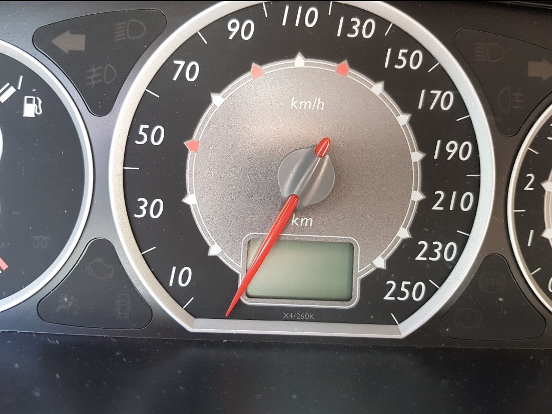

Turn off the engine and post a picture of your dashboard. I guess your needle is under 0. Thats why get Speedcontrol Pictures 😉

I can't right now, the needle is clipping the top left edge of the tiny screen for the cruis controll. The needle is way under the 0

under 0 like this
Needle should be on the first line under 10.

Exactly like that

so that is mechanical issue. no need to recalibrate something....and it has nothing to do with tire change 😉.
Disassembly the speedometer unit and check the needle. My needle was cracked. I used small shrinking tube and mount the needle back to the Motor. I dont use glue.
Good luck!

When checking if the needle is at 0 mph, do it with the ignition switched on but without the engine running so only lit up. Our 2007 C5 needle spindle had cracked so the needle was loose and I used a wood glue (all I had that was a bit runny) to stick it back with the ignition on and engine not running so I could set it at 0 mph. Then let it dry before starting the engine. This was many years ago and the speedo is still ok.

1st for the speedometer I can't say if it was like that imidietly after changing tyers because I started driving the submarine like 4 to 6 mounths after the tyer change (it was done march 2024 I started in july2024). Now that I think about it , during the spring break, (April) I drove it for a cople of days and it was already at -15kmph. So I belive yes , imidietly after tyer swap, but I have to ask my dad if it was like this before. As for the needle beeng below the 0 whit the ignition on and engine off. Yes, it still stay below the 0.

Definitly it has nothing with tires FOR SURE !
It's a mechanical problem, agree with C5000 .
I solved this problem using only a little teflon tape on the axle of the motor and put the niddle.(mine was not briken, only loose)
Than turn the niddle on the line under 10. Put the conectors and drive witn the cruse control to check the corectness of the position of the niddle ant to correct if needed.
