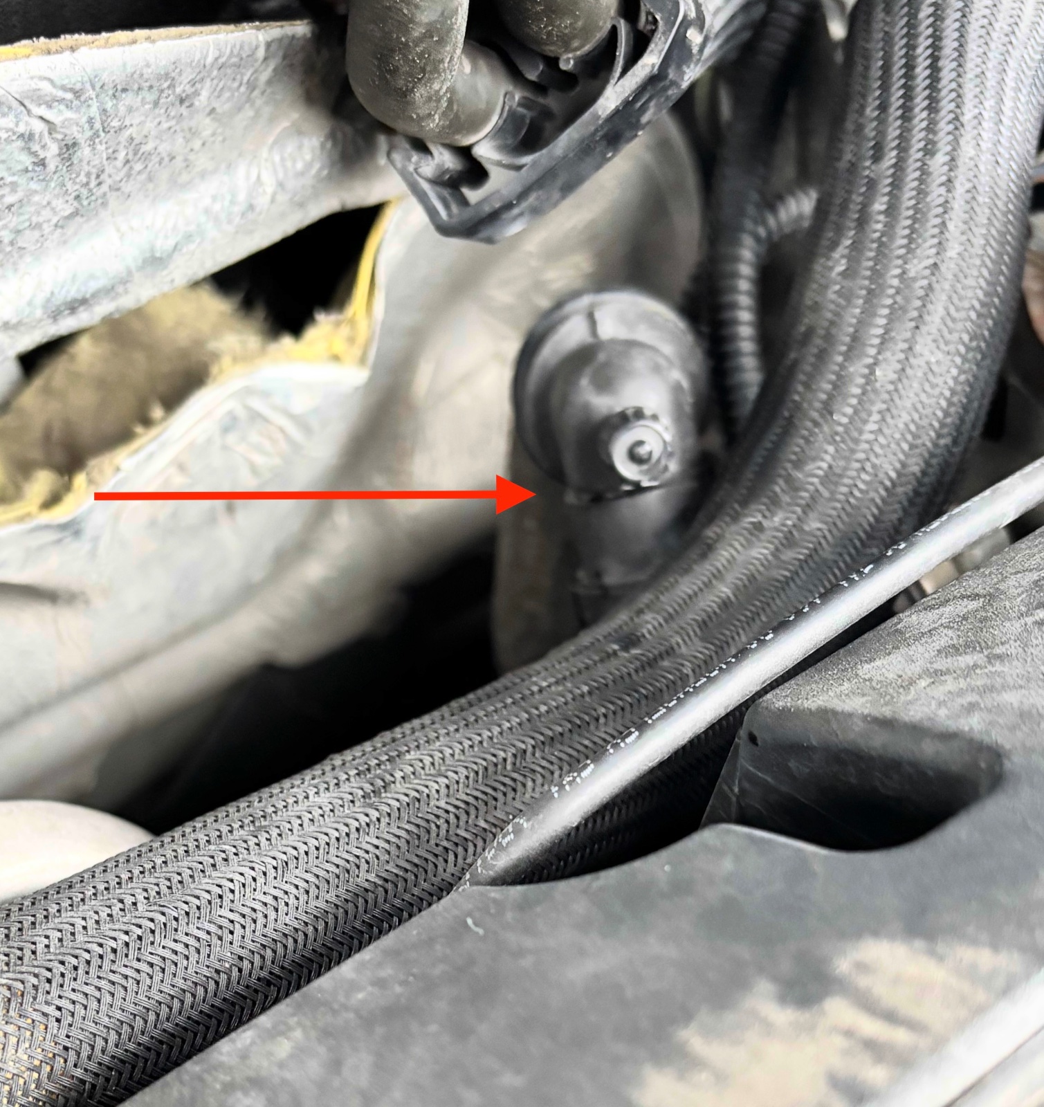

I have found the leak, I think - but I have no idea how to really fix it. First idea is to use some sort of clamp, or do I need to replace the entire bleeding vent or pipe? The leak comes up where the bleeding vent is connected to the pipe leading up to it and dripping down to something really hot below it and evaporating thus I have not found any leaks of sorts.

I need to replace that entire coolant bleeding part, but I can not for my life figure out what the proper name for it is so I can order it, does anyone know?

I have found the part no 6466ZA , but that is impossible to find. I have found a similar 6466Z1 but one retailer said it won’t fit.
Please help me.

What you could do is buy the wrong hose if it has the same leaking part and then fit just that bit to your existing hose. You might need to use a connector to join 2 hoses.
