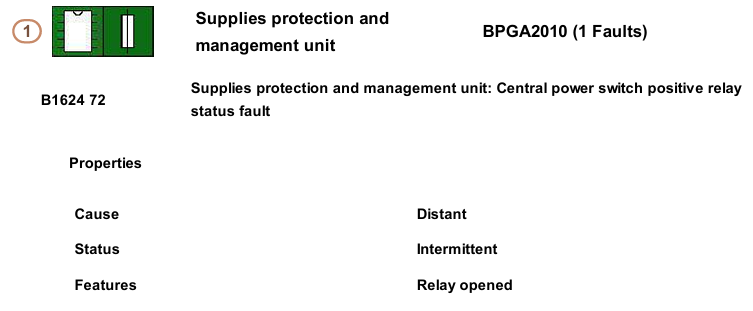

A scan with Diagbox confirms an intermittent fault on the BPGA, so I'm leaning towards that:
The next time it happens, I'm going to try tap the BPGA to see if it is a sticky relay - or maybe bridge the points on the BPGA briefly (it doesn't appear there's any easy standoff posts on this model though).
