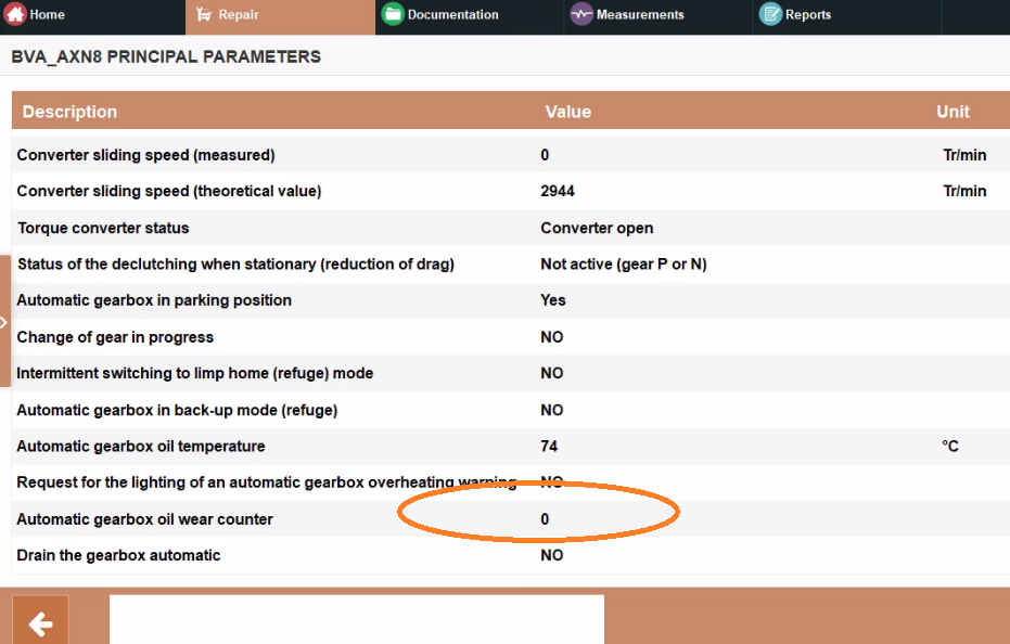

I made a short video how to make a dynamic oil change applicable for automatic transmissions Aisin AWF8G30, PSA ATN8, AXN8 and EAT8.
For each change you will need 4 L of AW-2 type transmission oil.
There is no need to reset "Automatic gearbox oil wear counter" with Diagbox because on these transmissions oil live is not couted i.e. counter is always 0:
