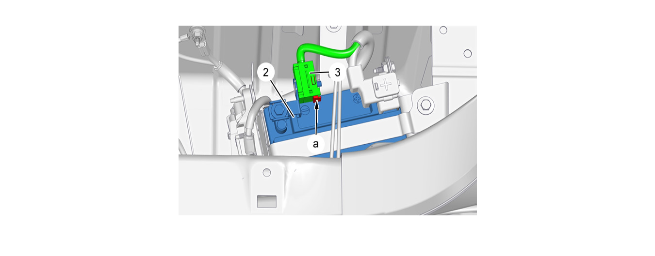

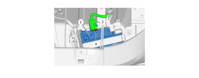

Hello. Good that your car is back))) Main battery number at least form mine is 16 200 125 80 (around £160 in main dealer). Prices of labour can be high especially in main dealer.
In Ds 2nd anc battery is in the boot. To get it you need to remove :
The boot sill trim
The boot carpets
Unlock the ancillaries battery 2 (2) negative terminal (3)
(at "a").
Disconnect the negative terminal (3) of the ancillaries battery 2 (2).
In all new cars battery must be in tip top condition - too much sensors, electronics etc. You can buy a battery analyser and check it by yourself. Had mine for around £30 from Amazon. Replacing a main battery by yourself will save you a lot of money...

Thanks for the above that is helpful, do you have any information on the 12v battery which I believe is used for the electric drive?

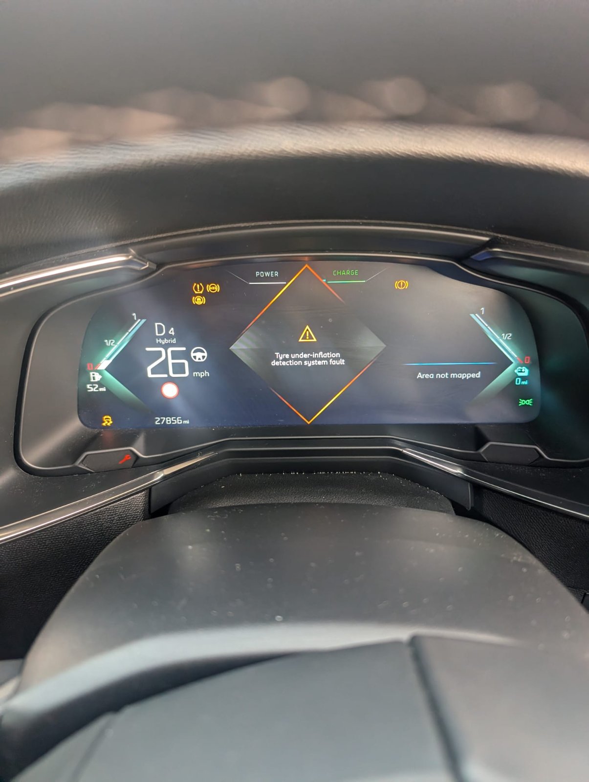

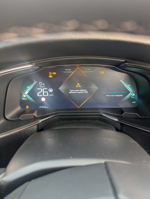

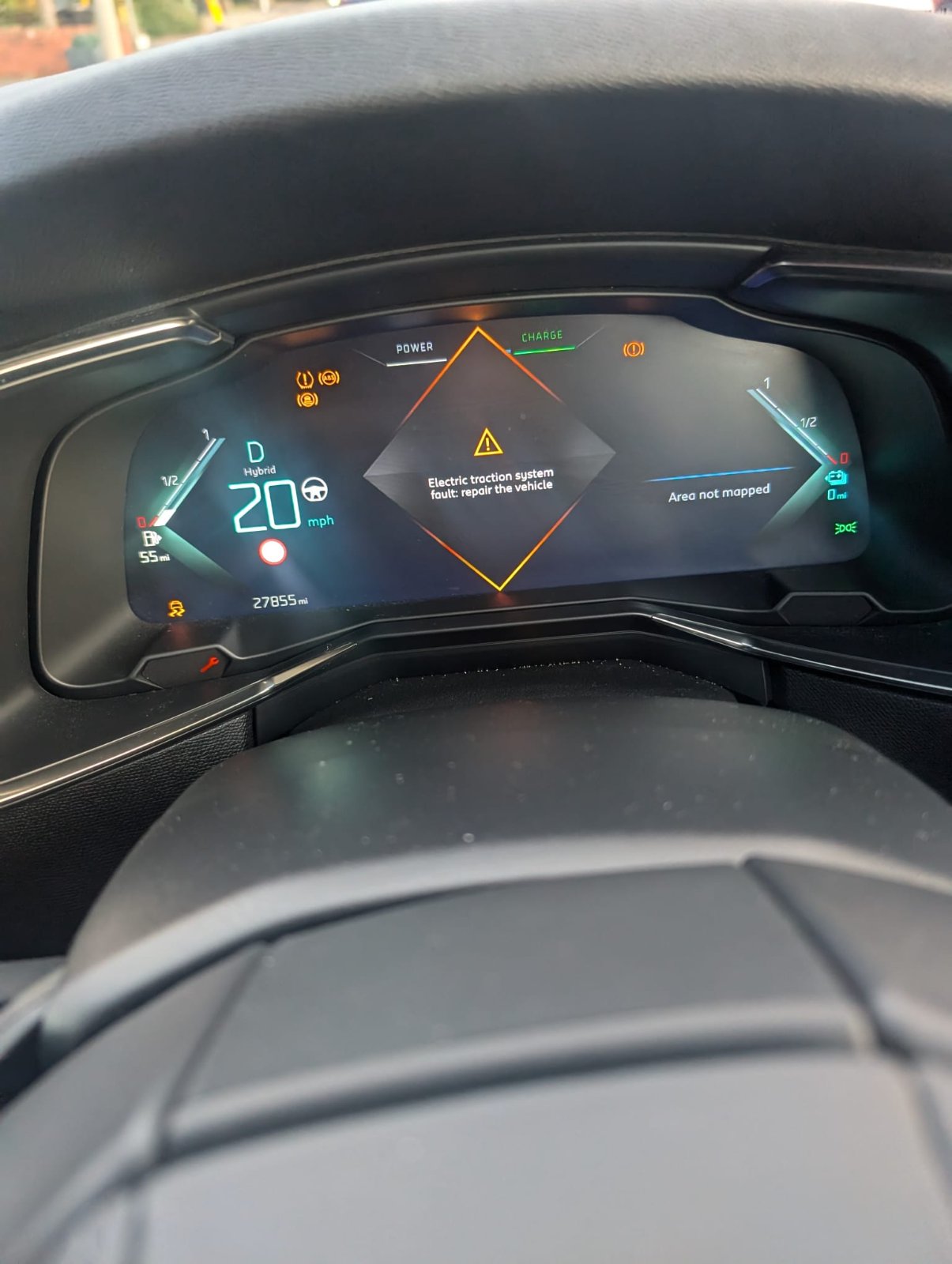

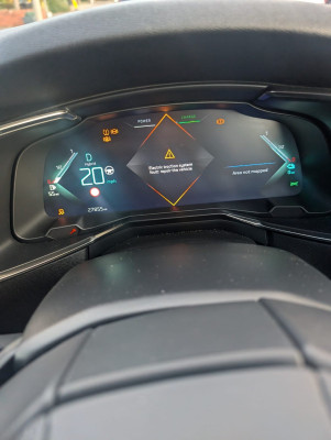

Hi everyone,
My DS7 Crossback has just arrived, and I’m experiencing the same issue. Unfortunately, there’s only one service center in Hungary, and it’s quite problematic for me to get there at the moment. Before I received the car, it had been sitting for 2 months. It starts normally, but I get the same error message (electric traction system fault), first in orange and then in red. I’m also seeing a tire pressure error message.
I removed the small battery from the trunk and had it tested, but the values are fine. Does anyone have any other suggestions? Would it make sense to replace the small battery even if the values seem good?
- Posts: 12618
- x 1499
Re: DS7 Faults
Welcome!
You will need to get it on a diag tool to see what it is upset about. With the tyre pressure message could be a wheel speed sensor playing up?
