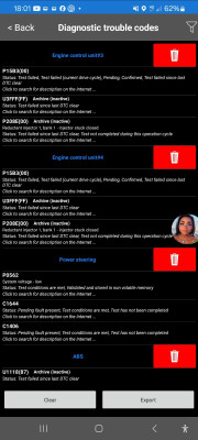

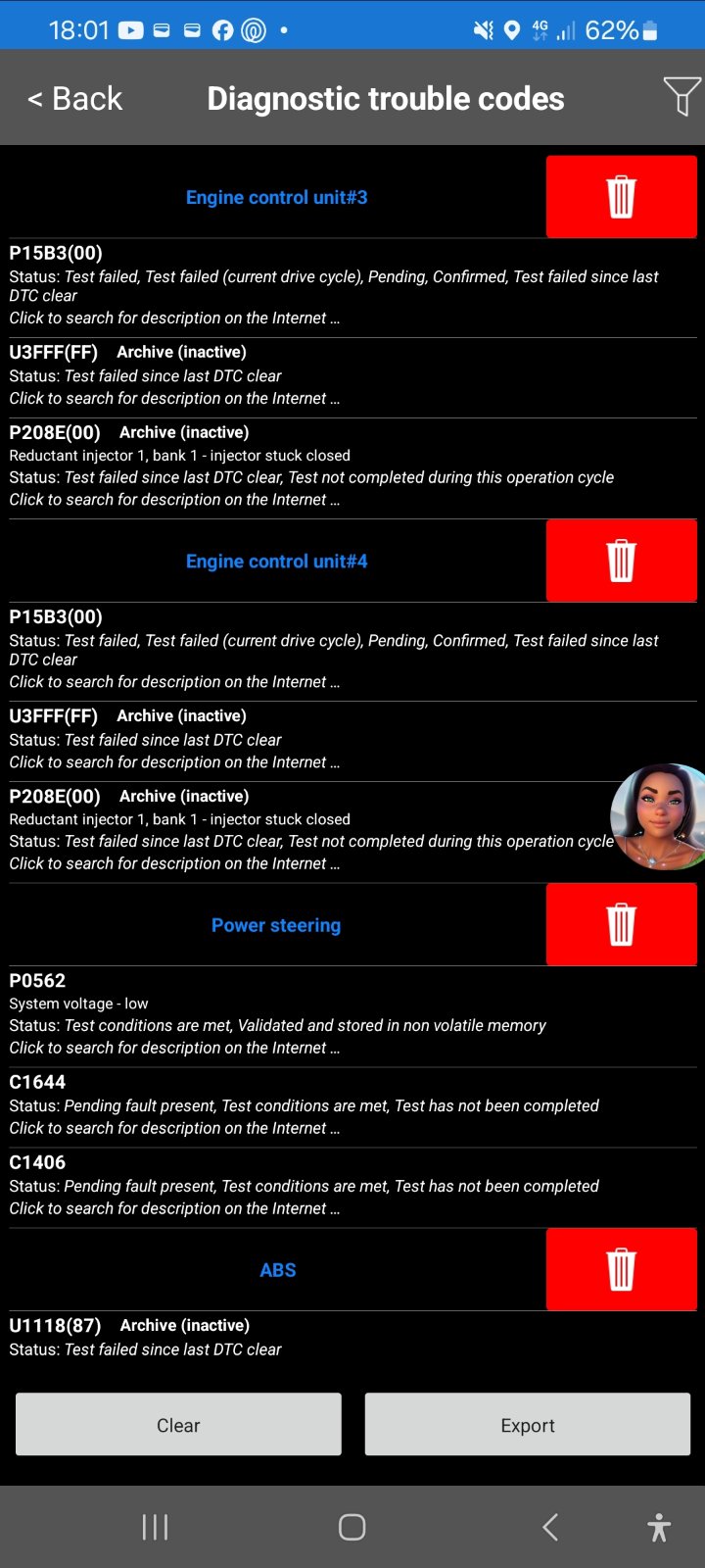

last night u got an error on board saying " engine fault: have your vehicle repaired" ive put my obd II and got the error code which says
P15B3(00) Status: Test failed, Test failed (current drive cycle), Pending, Confirmed, Test failed since last DTC clear Click to search for description on the Internet
When i click it to take me on the internet it says this
"This code can mean that your engine management ECU software needs updating, so you'll need a dealer for that, as well as topping up the additive for which the engine ECU also needs intervention. So you may be better off booking it in for both operations"
I am not entirely sure what all this means

P15B3 can indeed mean an engine management software is required, along with a check on the particle filter additive and a top up if needed.

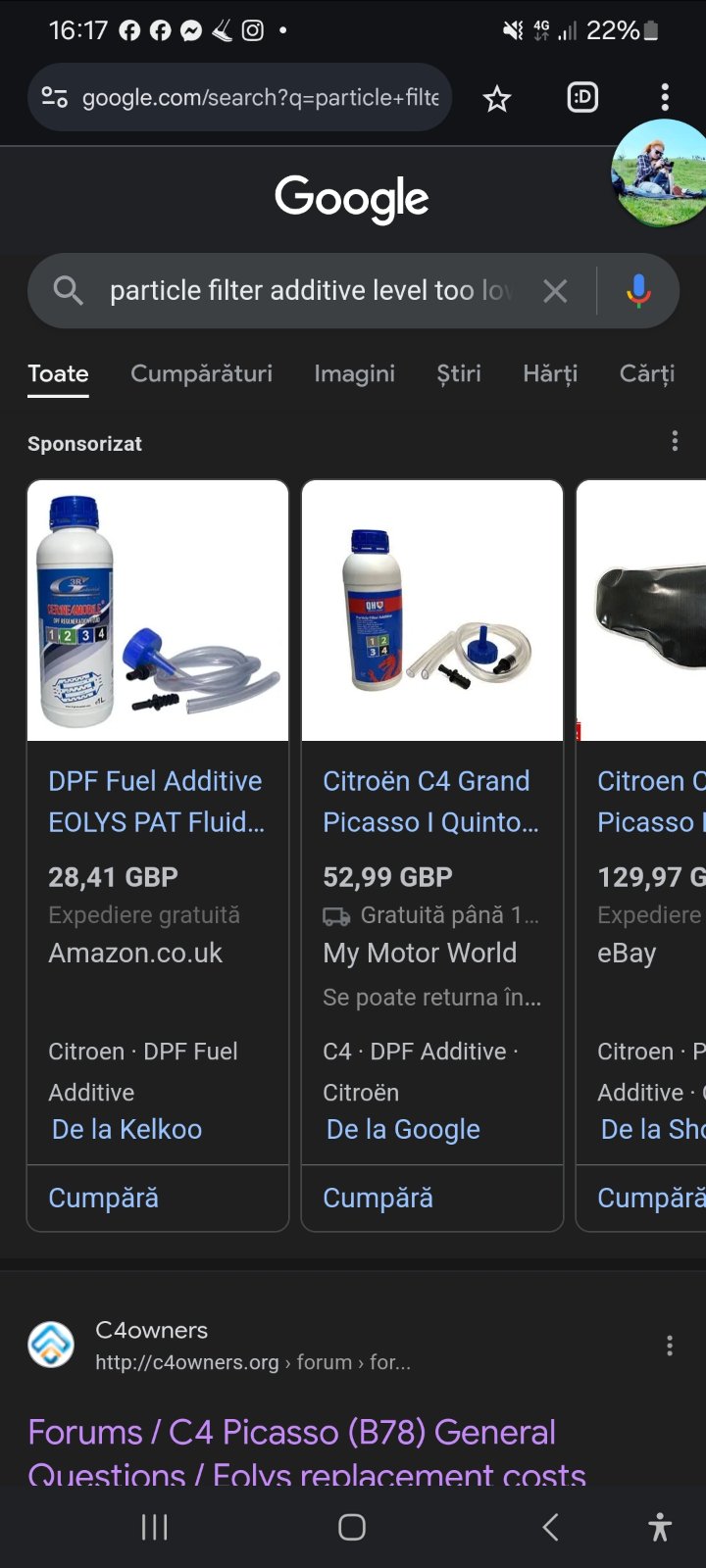

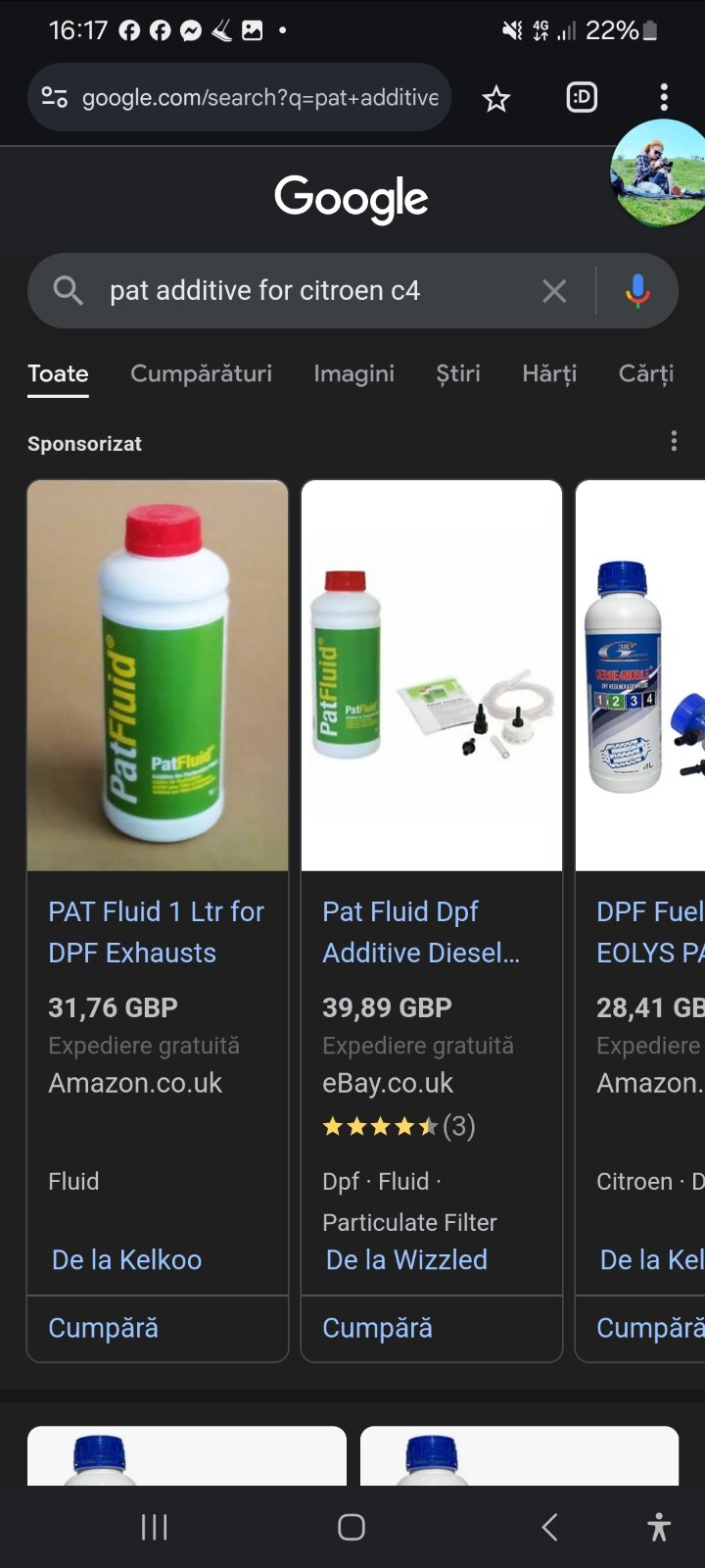

I just looked under the car and i found this tank. This is which one i have to refill right? And what's the difference between pat additive and the dpf additive? And next question which of that too i had to put? Cant find in manual book
ShadowOfDest
- Posts: 13
- Joined: 09 Oct 2024, 16:47
Re: DTC P15B3 error citroen c4 grand picasso 1.6
And how much does the reservoir take?
