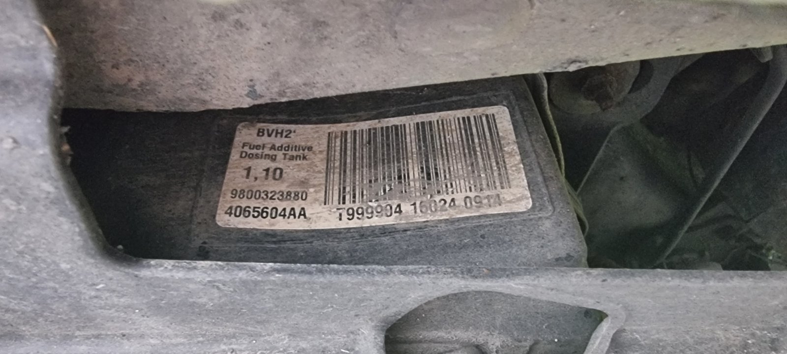

I just looked under the car and i found this tank. This is which one i have to refill right? And what's the difference between pat additive and the dpf additive? And next question which of that too i had to put? Cant find in manual book

And how much does the reservoir take?
