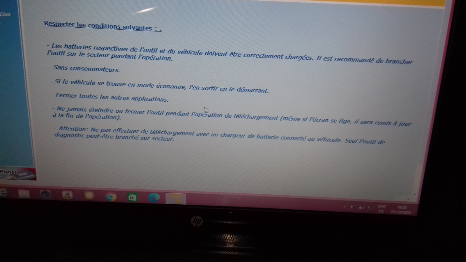

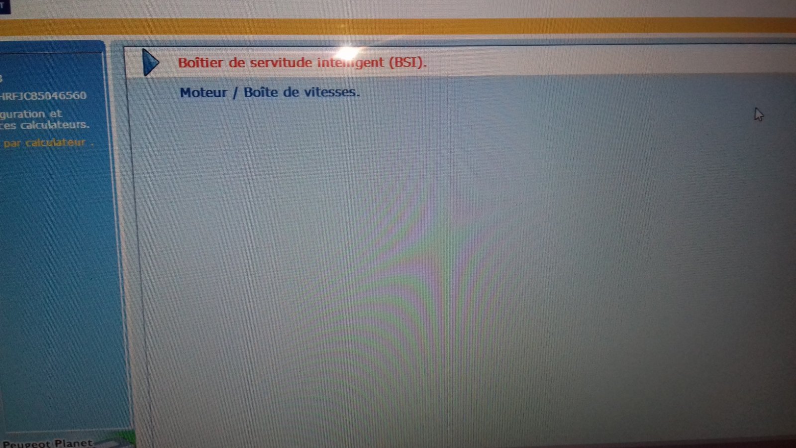

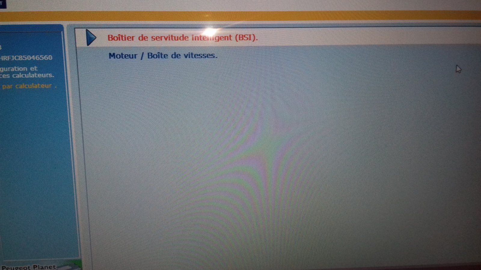

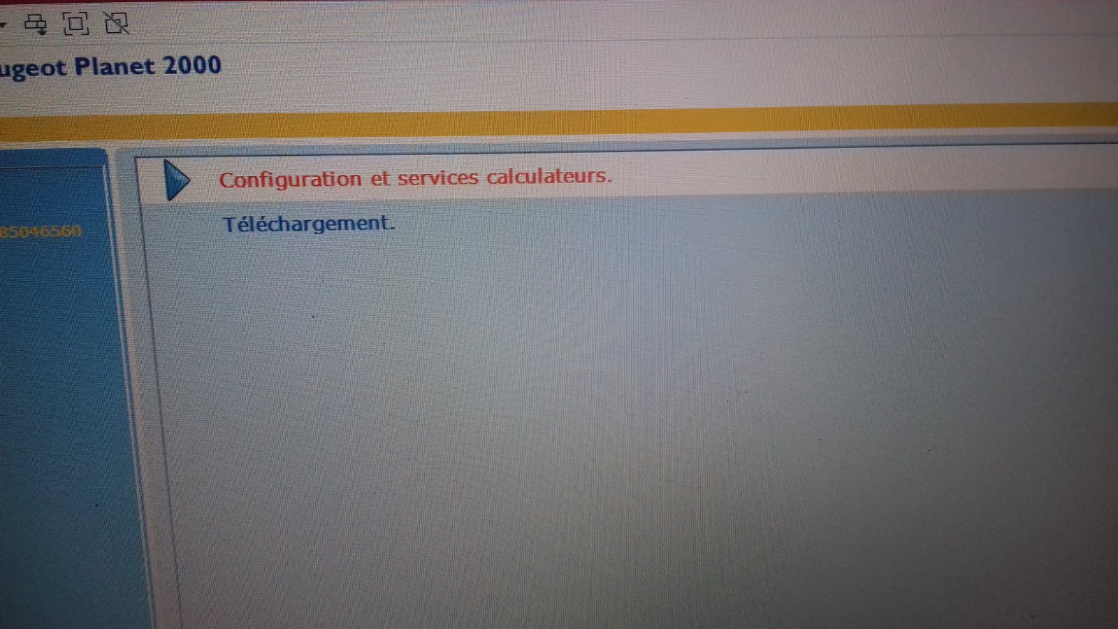

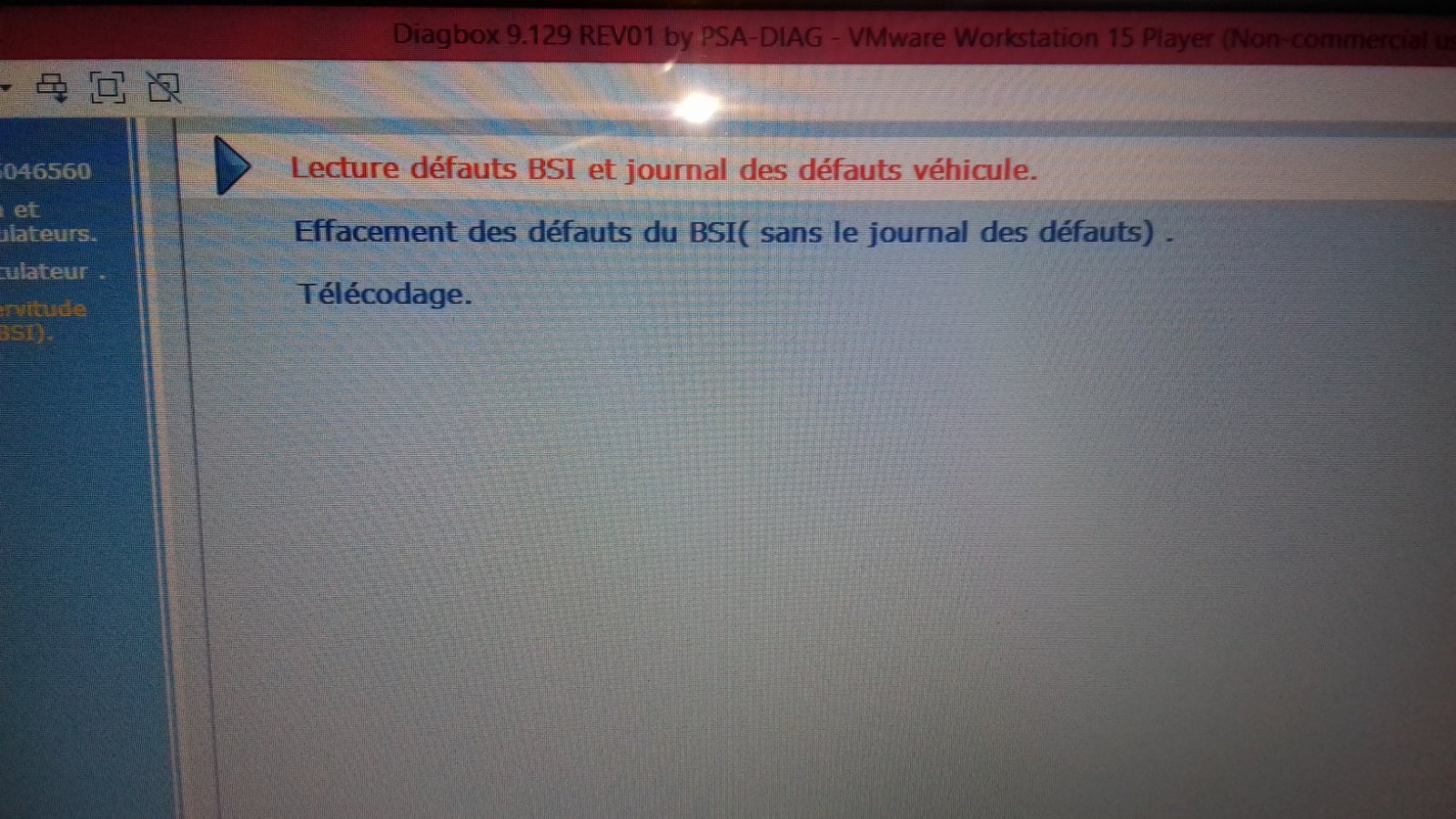

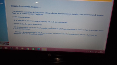

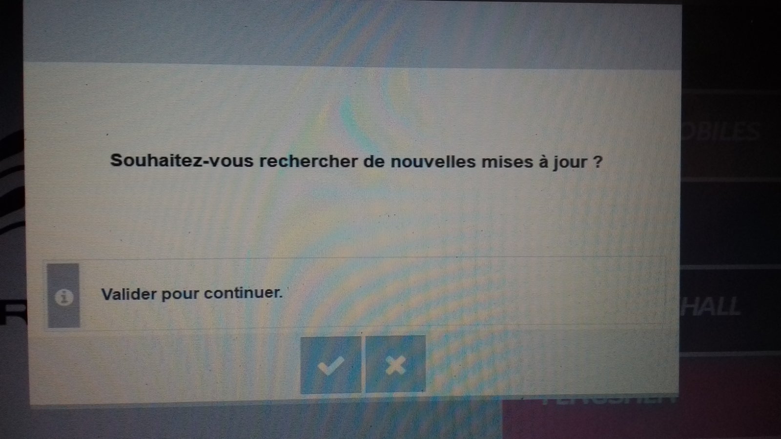

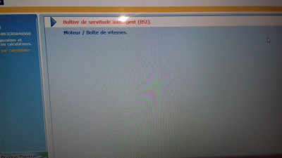

Hello a new try today: after opening of Diagbox 1 new windows that asks :Would you like to look for new updates? here I say no( should I say no here?) then choose my car, then on PP2000 which asks my RPO then the main window with three options. attached pictures below in the correct order
but no Diagnosis option therefore my question above should I say no there?
- x 6957
Re: Diagbox Fault Finder Finds No Error
No, you don't want to search for updates - or it may deactivate the software.
What happens when you select the top option which is for Reading the BSI faults and BSI log. I suspect that will just bring up a historical list of logged faults. I still don't think you are in the correct area, and your screen shot is missing most of the display so I can't see the other options on the left - but I think you are in the wrong place and selected the wrong menu from the options.

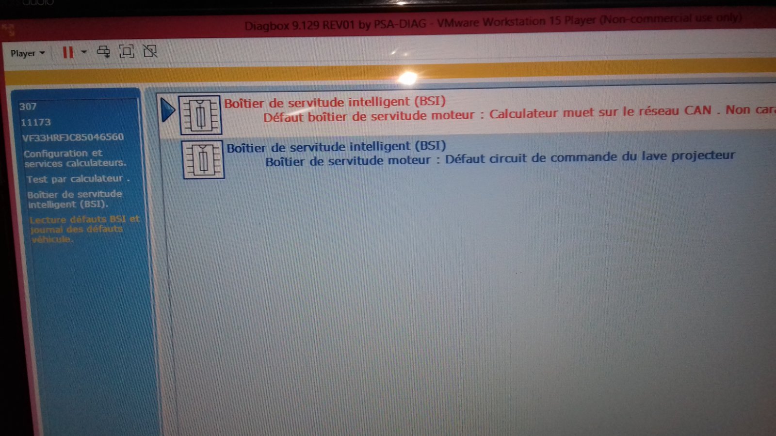

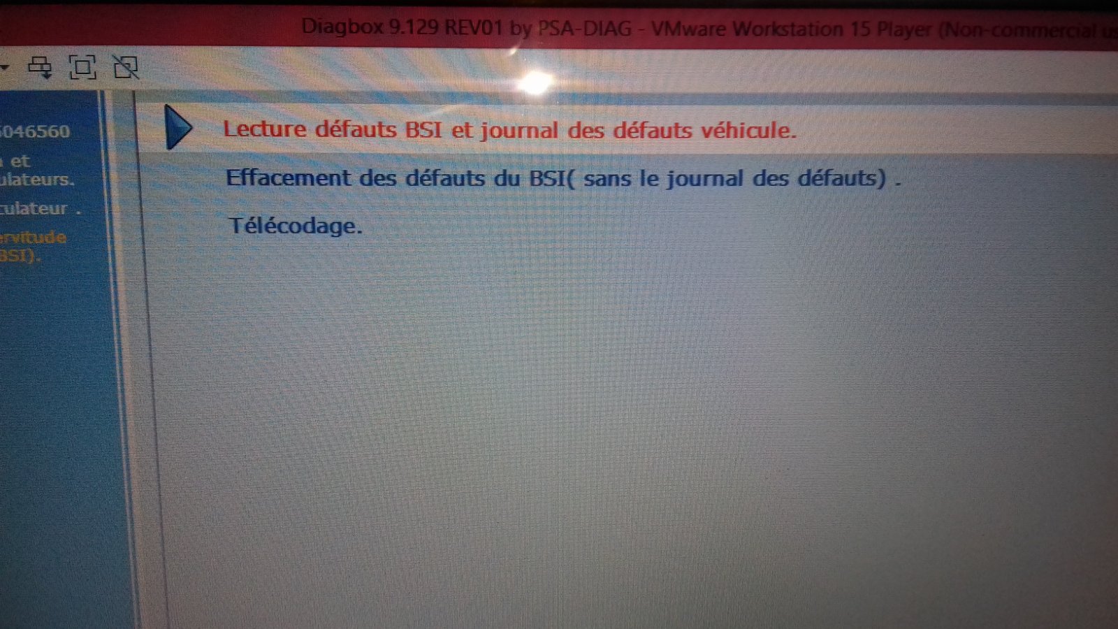

that's exactly what I thought no update. There are no screenshot just few pictures that I tried to refer to. I'll put the rest so maybe we can go forward
- x 6957
I wanted to see the left menu - not the screen as you are in the wrong place to start with.
On picture 5 on the left there is an option "Test par Calculateur' that's the option to run tests on the individual ECUs. There should be a 'Global Test' that can be run on all the ECUs, but selecting that option will give you a system to test at least.
