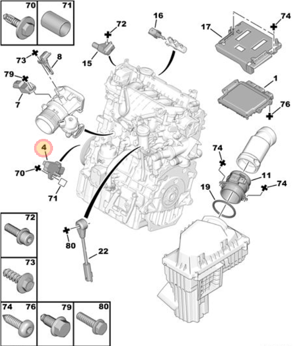

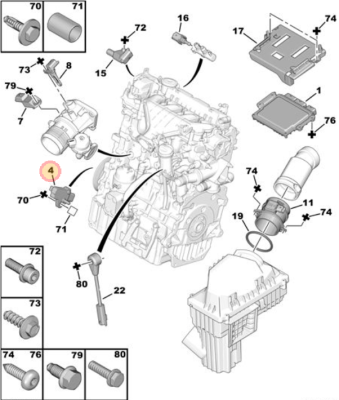

There's a specific technical bulletin for codes P0336, P0337, P0338, P0339.
In the presence of one or more of the above, replace the Engine Speed Sensor (not the camshaft sensor). Then clear the fault codes.
In case you need the part info, I've put it here:
(4) Engine Speed Sensor, part: 1920GJ, £79.22
