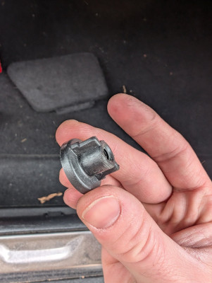

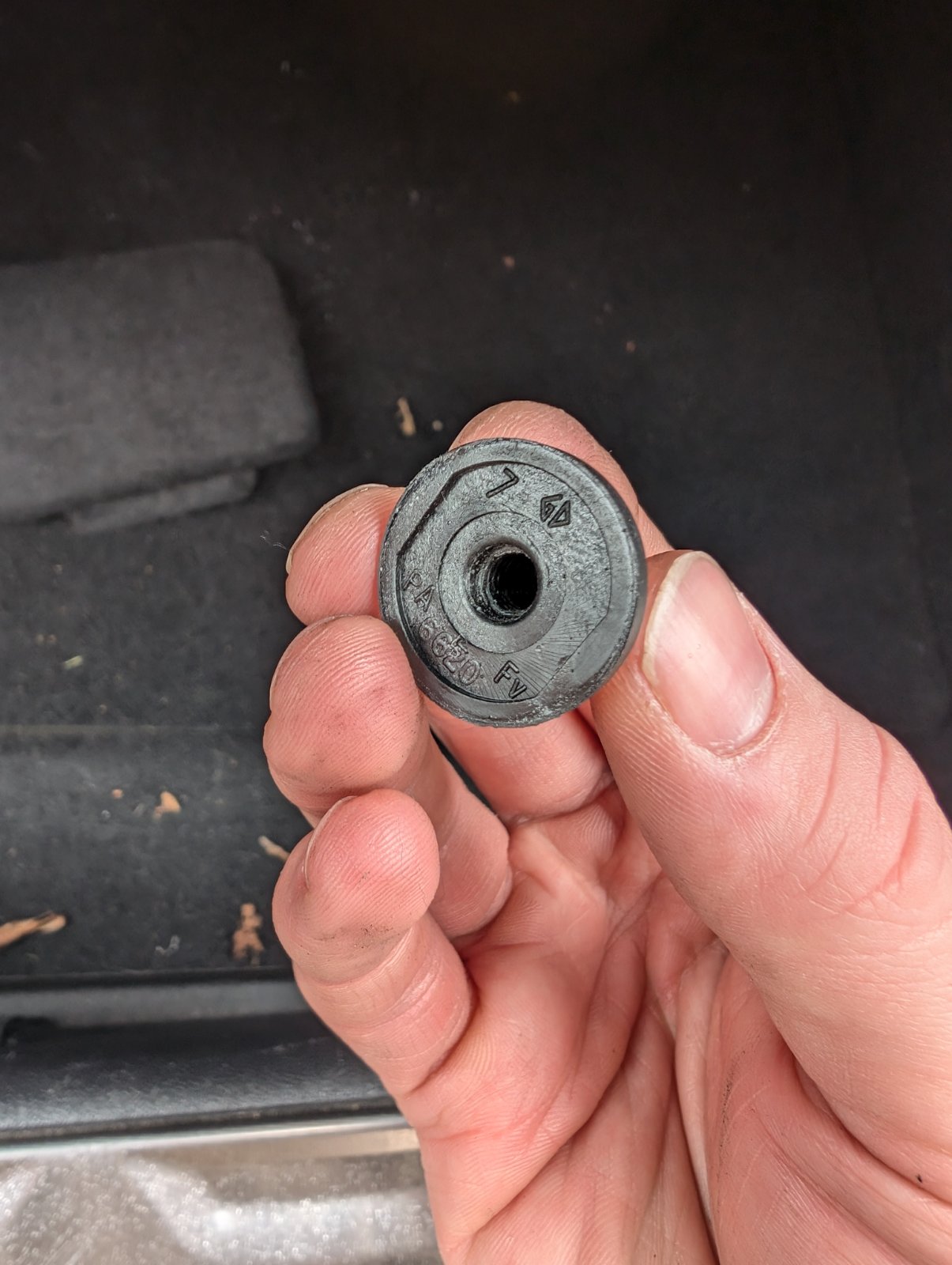

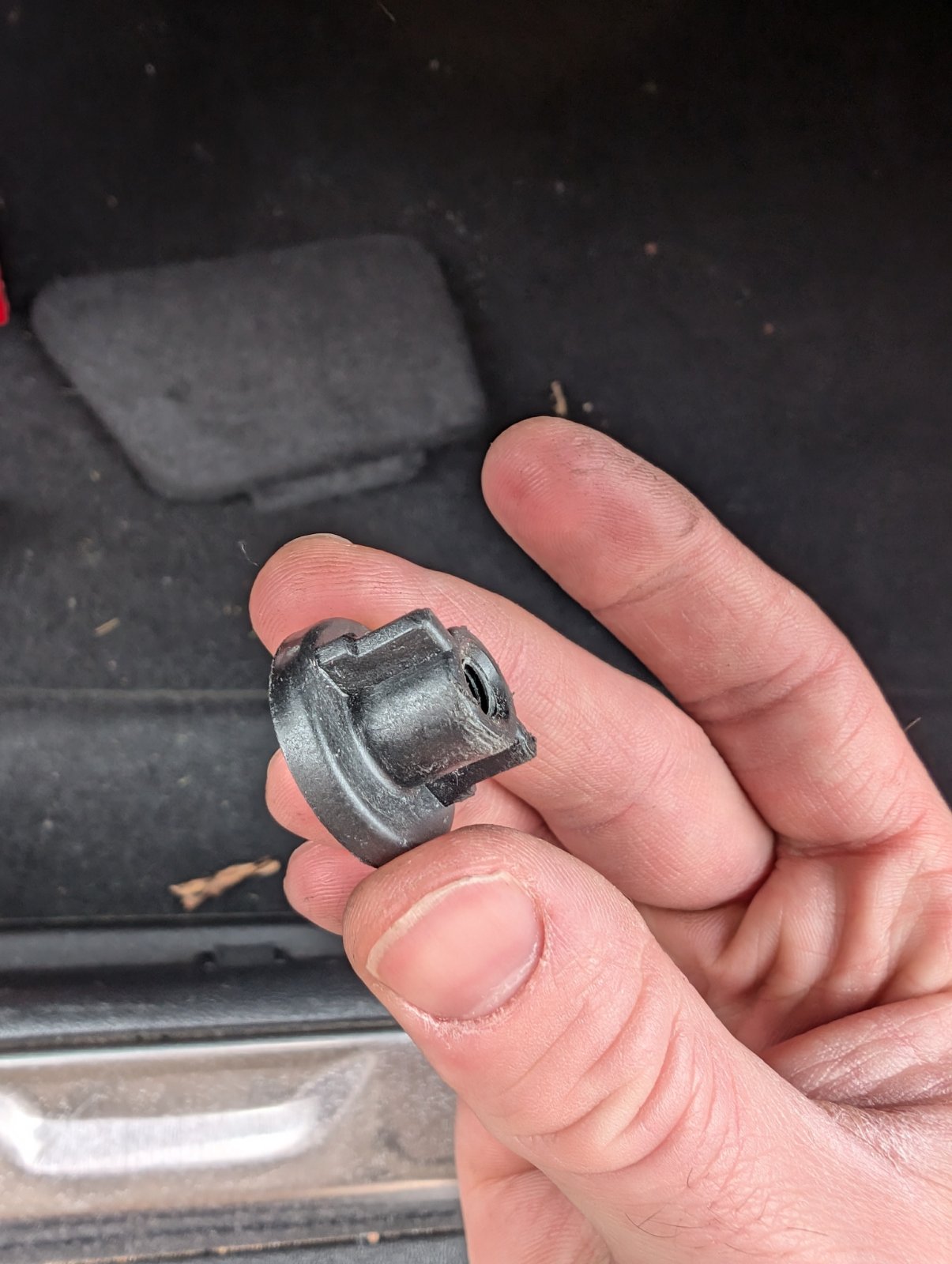

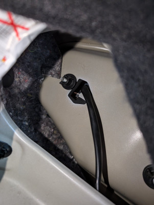

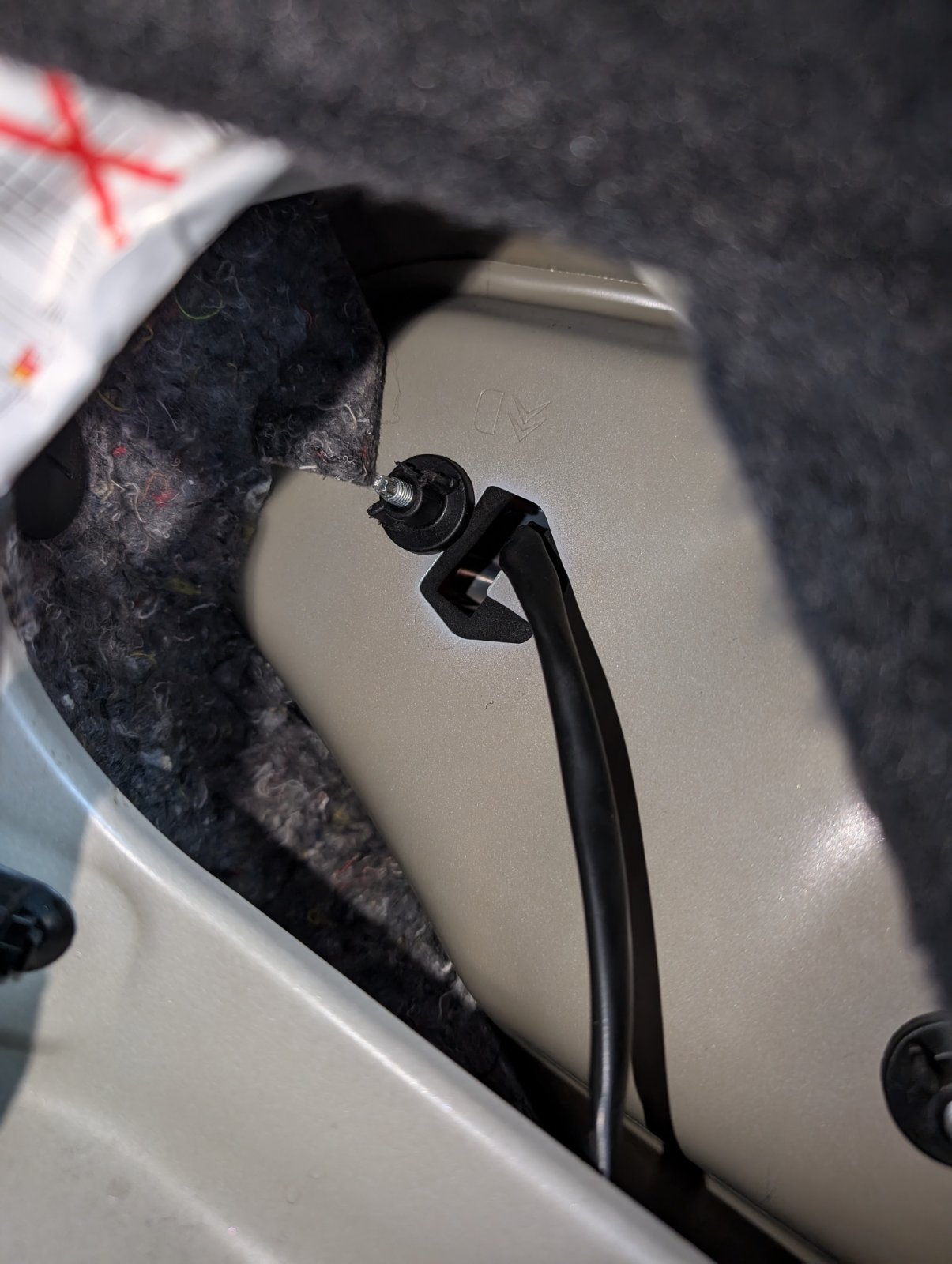

Hi mate. I managed to get this done and changed the bulb no issue, however when unscrewing one of these fixing nuts it dropped down the hole never to be seen againGiveMeABreak wrote: 23 Sep 2024, 12:28 They can become stuck, so I'd be very careful, these being plastic, not to snap them, but I'd suggest putting a little silicone oil spray (not WD40) onto the thread and round the base and let this penetrate before trying again in a while.

An open ended spanner used end on can help to undo these (tie string to it in case it is dropped) and I am careful to not drop the nut. As a temporary measure you could use a penny washer and normal nut so a long socket could be used to tighten it.
