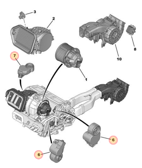

Here are the diagrams for the components I think your are interested in:
These are the reduction motors for the air mixing and air distribution:
(6) Air Conditioner Reduction Gear, part: 6479E7, £156.11
(7) Air Conditioner Reduction Gear, part: 6479H8, £139.94

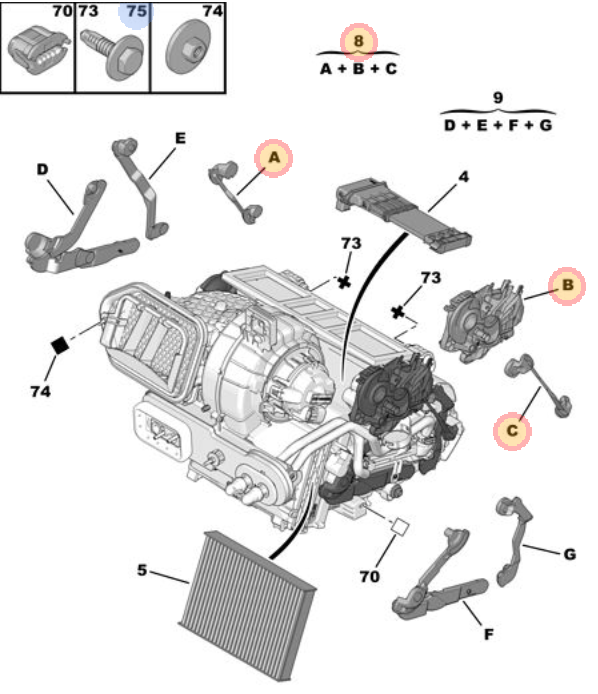

Here is the Reduction Motor Rod Kit that I mentioned. These are plastic and the gearing can snap or wear out - hence the replacement kits:
(8) Reduction Motor Rod Kit, part: 5479H6, £98.34

Re: 508 2014 drivers heating
I can tell you that it's rarely the actual reduction motors that fail - it's usually worn spindles or gear linkage that's the issue as these are plastic, hence why hearing the motor is no indication that the rods have failed as if they have snapped they'll just turn in the motor socket. So looks like it may take a bit of investigation.
If I get time tomorrow, I'll put up a guide for you in the Members' section showing how to access and replace these.

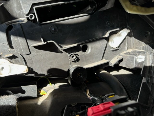

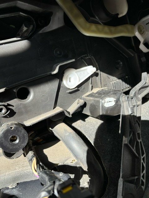

Hi. Sorry for not getting back sooner. Have only had a chance to look at it again today
I took a couple of photos of where my issue lies.
Its the white lever at the back that is the issue. When i manually turn it , it feels like it’s not moving anything inside
The front white lever is fine and can feel movement inside
Driver side Rhd car
Driver side Rhd car
