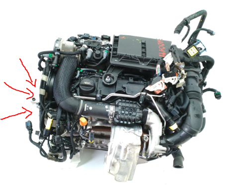

Cannot find any locations on Internet any where.
Have tried looking on car for locations suggested but have not found it.any suggested positions please
Camshaft sensor location ds3

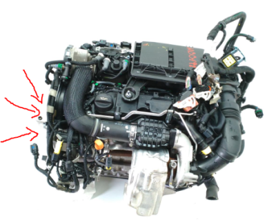

It's on the left hand side of the engine as you stand in front of it near the area arrowed - but it's not just a sensor, it's a small cable with the sensor connected.

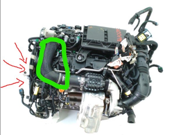

Do you need to take the camshaft cover off

No, if i remember right you take this hose of to access it.
