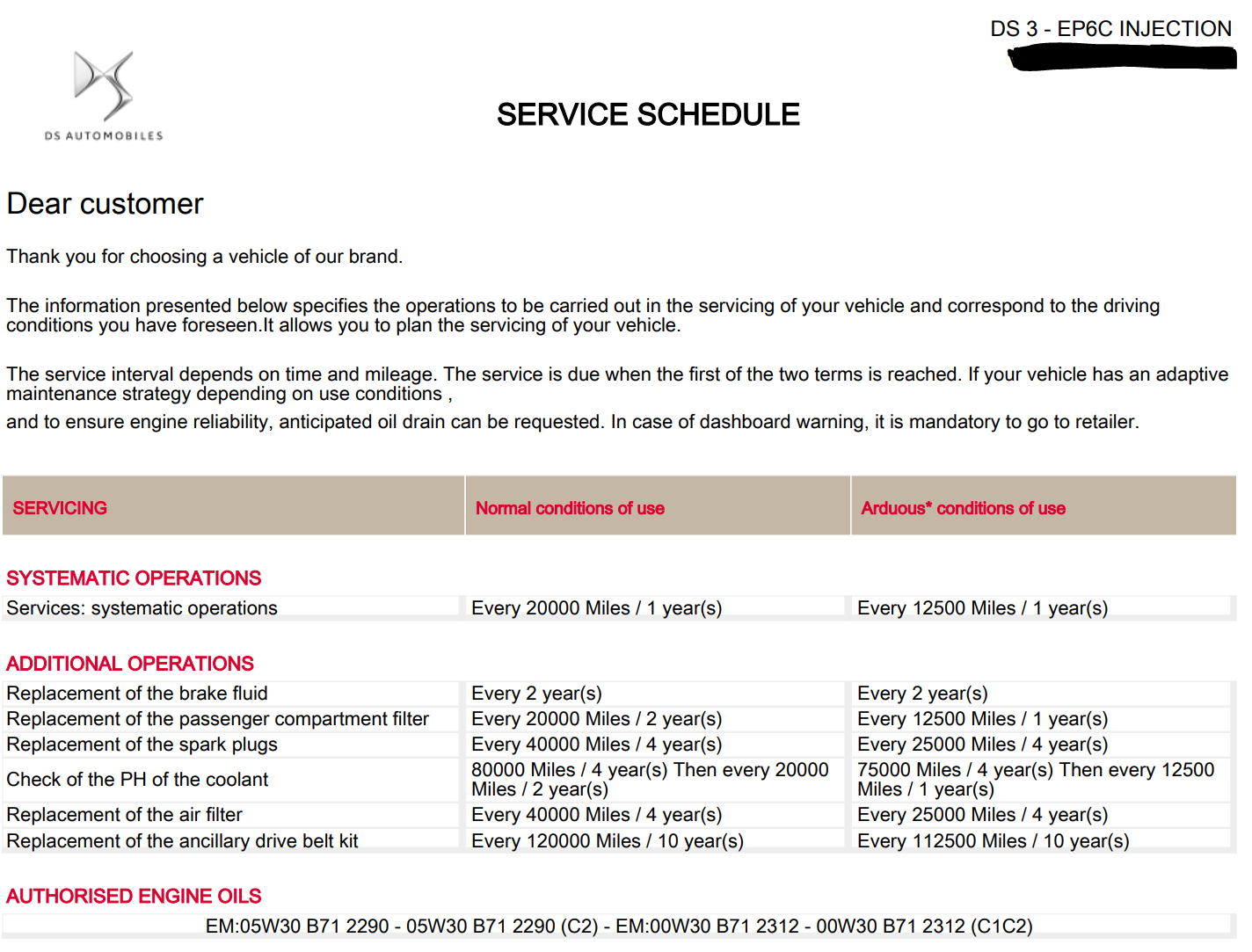

Struggling to find a service schedule for my car, is anyone able to help with this? Let me know if you need anymore details
Thanks in advance, really appreciate it
Service schedule for Citroen DS3 Dstyle plus 120 16 valve

Re: Service schedule for Citroen DS3 Dstyle plus 120 16 valve
Thanks for your Forum Donation.
Here's your Build Sheet and your Servicing Main Operations:
Click Image to Zoom
