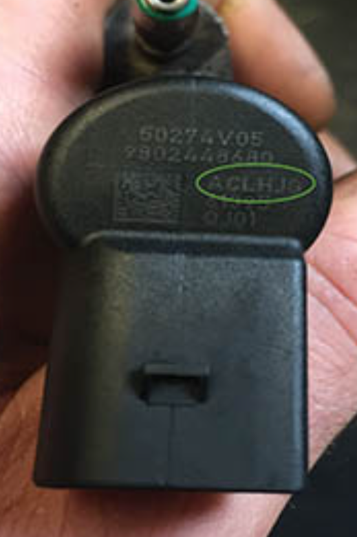

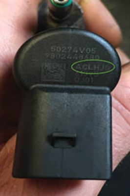

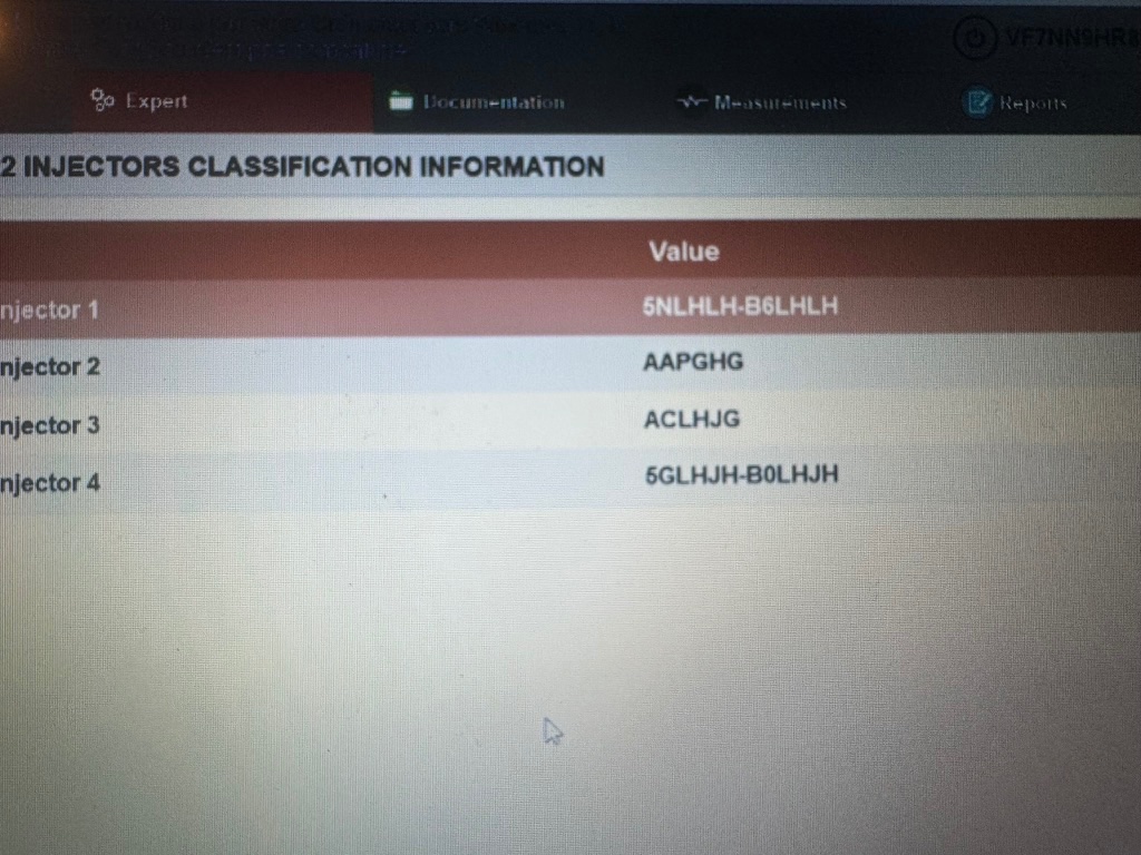

Have you entered the classification code correctly? These should be 6 characters for Continental-Siemens.

Not sure about 1 & 4, should only be a 6 character ref like the others:

Im thinking about that one as well when I'm entering the codes automatically it's coming as 2 codes. The second one its from the injectors no idea about the first one from where its coming, but on Lexia its says that the codes can be 2 separate by - how it shows on the 1 and 4

The double-code thing, I've seen that before, iirc it's the second code that is actually used. Diagbox says something about it I'm sure, I'll have a nose next time I'm in that. Seems to be more of a software glitch than any issue.
