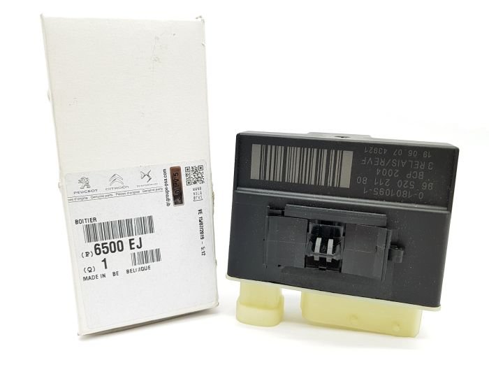

Hello! Can you please help me find the pinout of the electrical connector and implicitly of the relay, thank you very much!

Wiring
There is a 2 pin Grey and 4 pin Black connector
The 2 Pin 1514 wire is the fan control and the BM01 goes to the engine fuse box (Maxi Fuse MF03)
4 Pin Connector
1590A: Fan unit relay power supply
1550Z: fan control 2 (-)
1599Z: Fan unit diagnostic info
1540Z: fan control 1 (-)
