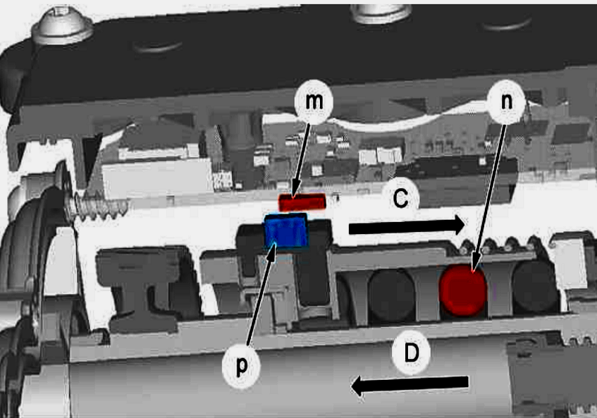

If it's like the others, there is usually a calibrated spring, magnet and hall effect sensor all integral to the unit, so realistically, you are likely talking replacement of the unit to be honest.
"m" Hall effect linear sensor.
"n" Calibrated spring.
"p" Magnet.
C Direction of movement of the magnet (Solid with the worm barrel ).
D Direction of movement of the worm.
The Hall effect linear sensor measures the stress force of the calibrated spring and the force transmitted to the barrel of the worm.
